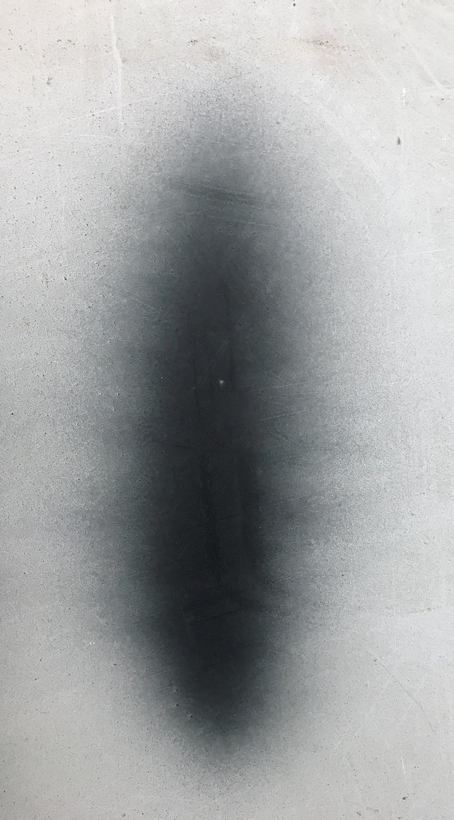

I had the gun sat around with basecoat in it for hours before I did that test spray. I’ll clean all the dry paint off and re try it. Maybe one of the air passages was blocked until I washed thinners through it? There was that patch of dried up paint inside the air cap on the photos. I’m clueless as to whether this patch, even though not blocking the circular air passages, would affect the airflow slightly at the bottom of the fan? I washed thinners through the gun before spraying the panel though.
Ok. Thanks. Will follow this. I will take off air cap after every use and brush it off. It may have been a bit of paint clogged in there from when I last used it. I washed it through but there was perhaps a bit of paint partly blocking something?Leaving the gun sitting still for any length of time will allow the metal flakes to settle to the bottom of the pot, which will cause blockages, sputtering and a coarse finish in places. Put some paint in a pot and watch it settle, surprisingly quickly.
Keep it moving or clear it out before putting down and stir it. Don't put more paint in the gun than you need in one go, pour the excess out into a separate pot and put thinners through the gun before putting it down. Stir the paint before putting it back in the gun. You can work out the methods that suit your way of working.
