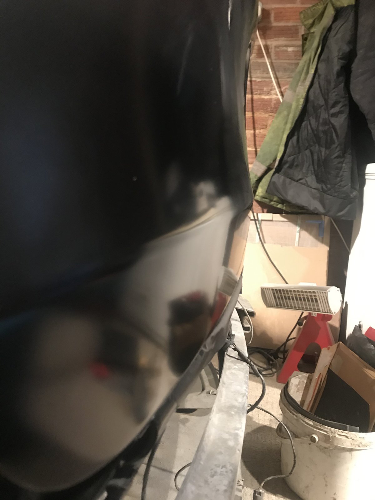

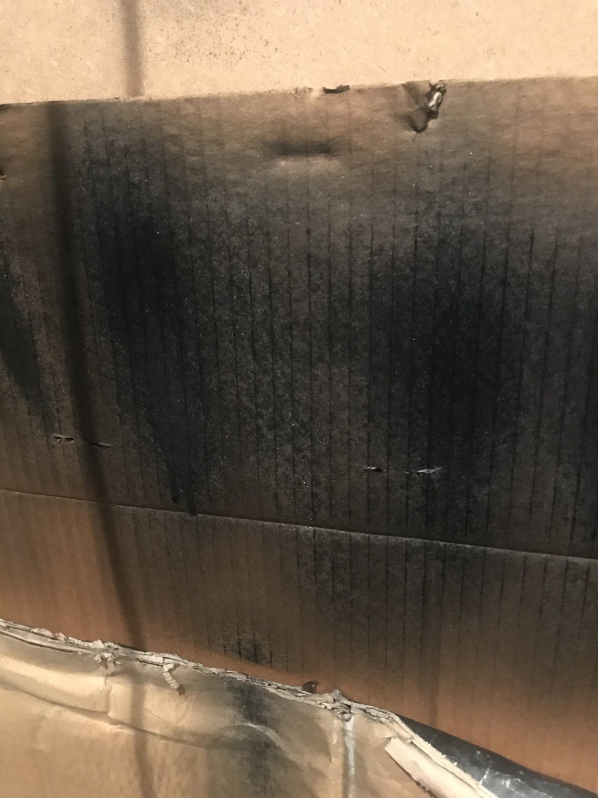

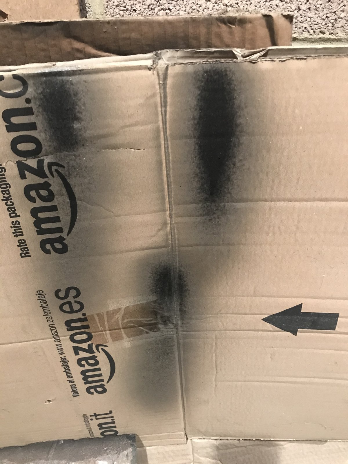

I’m fairly confident that I’ll see a nice finish on the upper part of the panel because the reflection of the Hoover is quite clear.

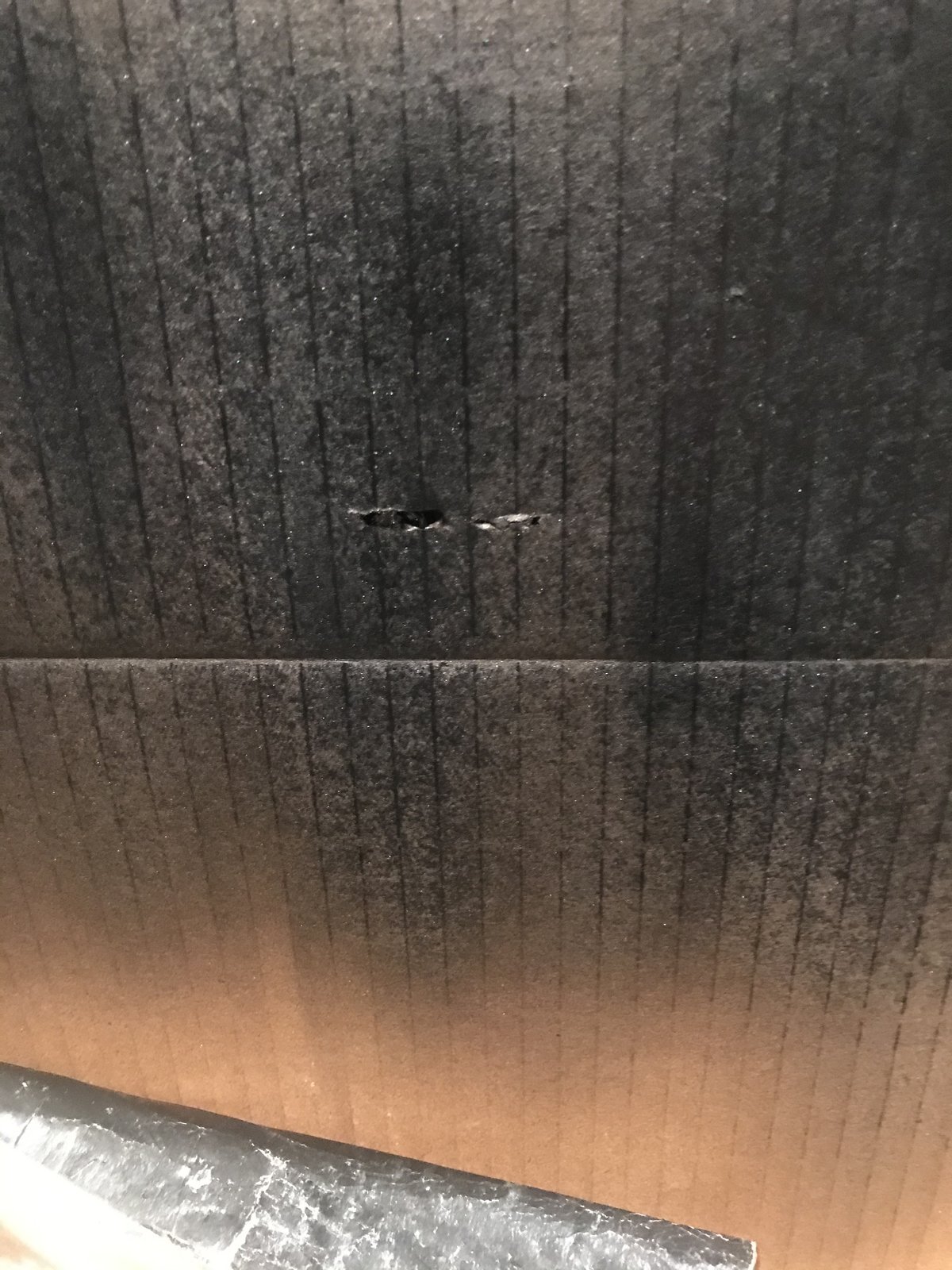

I started off with fan and fluid wide open as someone suggested. I got almost a split spray pattern as shown in the first photo. Then I set fan to 1/2 turn open and fluid to 3 turns open. Found some uneven pitted paint in places so I opened the fluid up to 4 turns. Bottom of panel is sprayed with 4 turns out. Super smooth.We could guess all night. Lets see your spray pattern with a 1.2-1.5

Bottom of panel is super smooth like roof.
