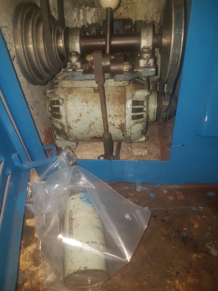

stick em in a polly bag hanging shouldn't realy be saying it just see if u can get the megga working 1st

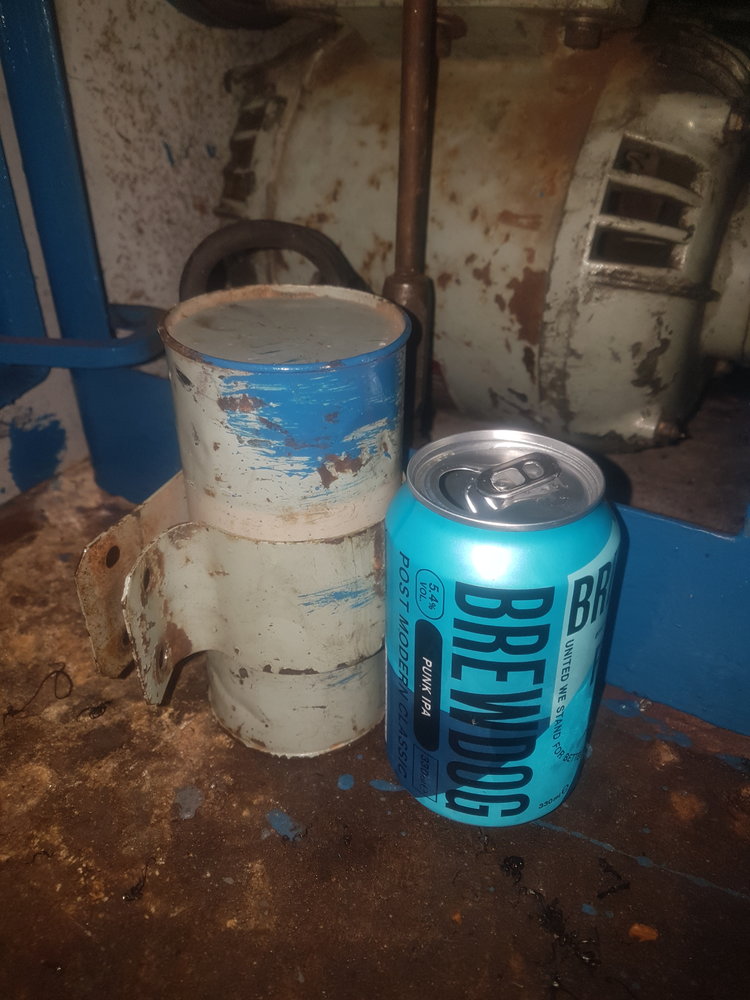

I did 50 stop starts over the course of a hour then it tripped the rcd. Reset them and stuck the cap in a zip lock bag. It didn't trip again for the last 10 stop starts. So I shall get a new cap and see it that fixes my problem. Oh I could not find the megga it's somewhere safe..

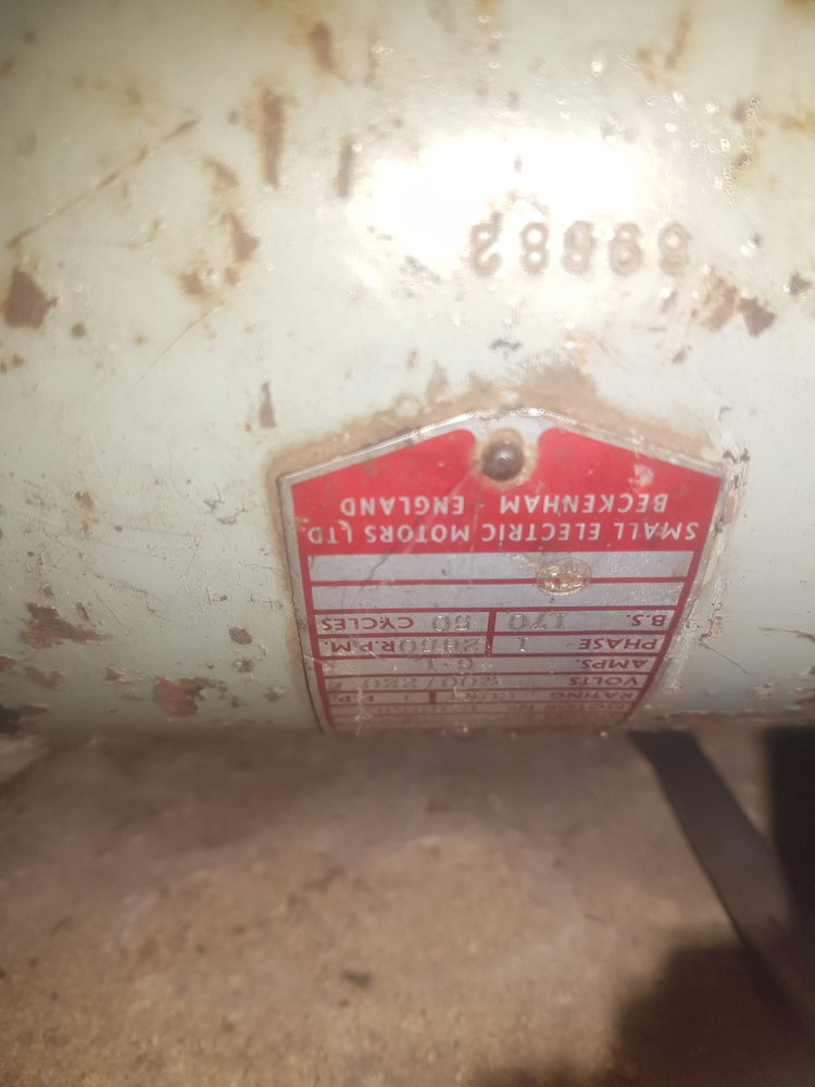

Any idea what size cap I need folks. It's a 6 amp motor.
