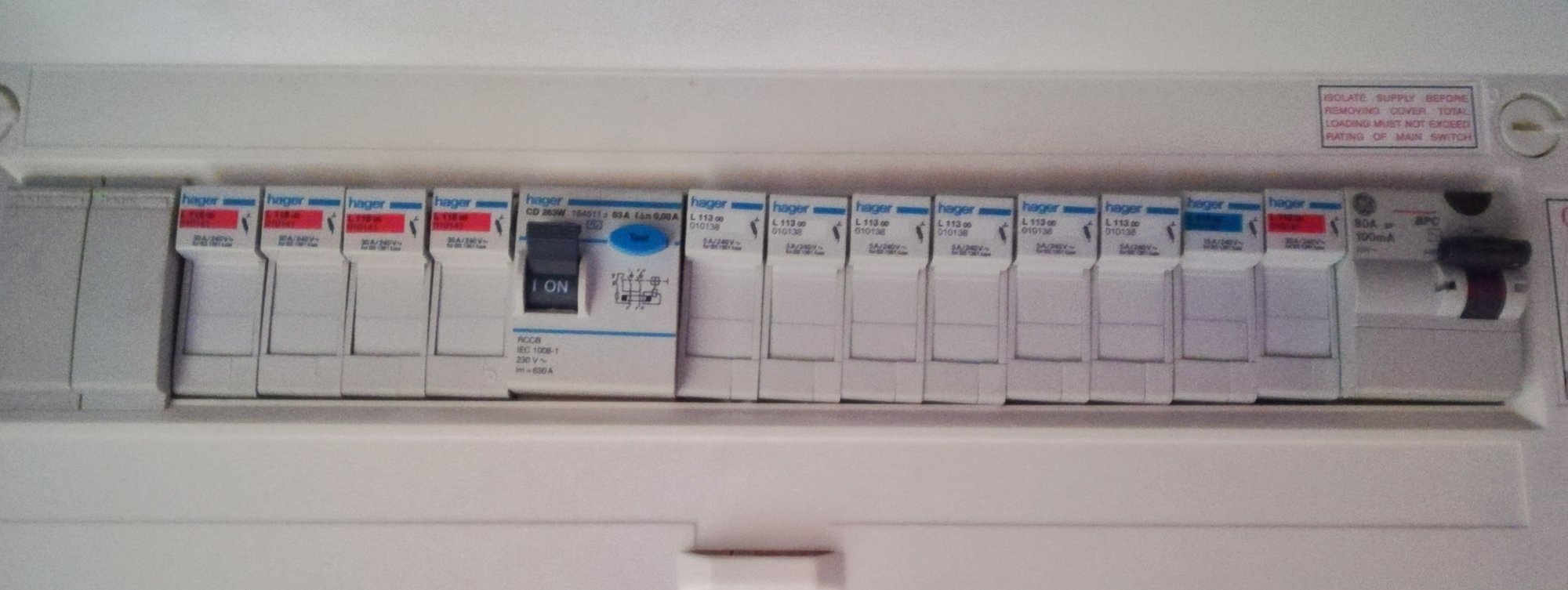

its not nonsense reason being fitting wylex breakers in to a volex db they will fit yes but if there is an accident or the db sets on fire who is to blame wylex or volexthen insurance companys wont pay out and your left hi and dry. each manufacturer makes the different types of rcd to fit in to there boards if u do want to fit a mismatch just put it in to a separate enclosure and it then doesnt matter
If thats the reasoning it is silly, should be a standard compatable fitment. However I respect that is the rule and in the electricians standards and I dont suggest anyone mess about with that.
Fitting to another enclosure will not work unless that enclosure has no upstream RCD.

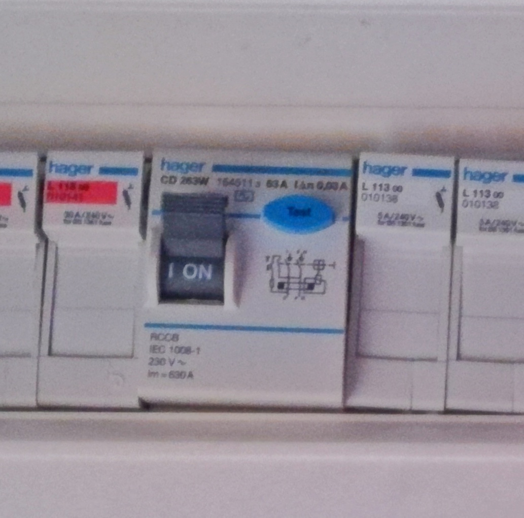

RCD will have a symbol on it.
