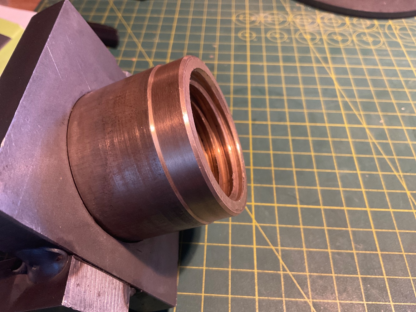

KPN326H 2700kg screw-type two poster. Picked it up at auction for £300.
Got it bolted in, but it refused to lift my mate’s Navara - just took the weight then the motor stopped dead and tripped the breaker. Afterwards, it would lift the arms up and down just fine. I can turn the mechanism by hand.
There’s a safety mechanism that stops the lift dead if the main nut is worn - it trips a mechanical stop. Could it be that? It doesn’t quite explain the arms lifting fine with no weight, unless the mechanical stop resets.
Motor is a 3ph 4-pole 3.5kW running on a rotary converter. Will give it a check over.
- Any advice, sources of parts etc. appreciated. Could do with some leadscrew bearings and rubber pads.
- Main nuts are bronze with trapezoidal 40mm x 5 thread. Expensive. Could I make my own? A bit tricky without being able to test the thread.

I think one’s left-hand, one’s right.
