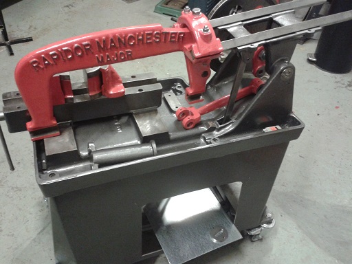

No not figured it out yet, i recon its a pollard as its too similar not to be, but theres NO makers stamps or marks anywhere, the motor is a replacement so nothing from that, the guy i bought it off had it a long time and thought it was an Elliot, but i think that must be from the "progress" name?
That's definitely the maker I'd guess at still. Styling seems so similar to theirs, even accounting for the variations. With the progress tag, I've seen quite a few different machines seemingly with that label, especially with the banks of drills. Seems they class it as a working methodology as much as a model name.

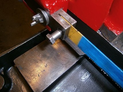

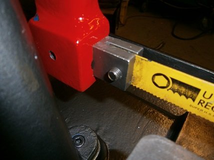

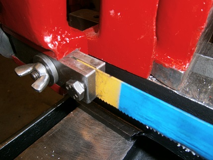

Made a couple more bits for the saw today. The first photo is the adjuster screw for the blade tensioner. The second is a clamp bolt for the blade holder.
Centre drilled that clamp bolt so that I could fit a brass nub in the end. Pretty much every other one of these machines which I've seen photo's of have had a broken or replaced clamping plate, so I'm guessing they have a tendency to have too much pressure applied and crack the plate. That's why I've made it as a knurled head bolt, so that it can only be finger tightened, and with the brass nub so that that should distort before anything else might risk cracking. Plus, that brass tip should prevent the bolt from marking the backplate when it's tightened. This is the bolt with the nub fitted and where it goes on the machine. That plate it's fitted in is the one which generally seems to disappear or become cracked.
Thought it best to err on the side of caution with that clamping assembly, and finger tight should be ample for its purpose.
The end of that tensioner screw has been centre drilled too, same as the little clamp bolt. Need to make up a disc for the end of that so that it doesn't tighten up directly against the casting, so the hole is in the end for the disc to centre against. I'll leave a little protrusion in the centre of the disc for it to seat in the end of that screw.

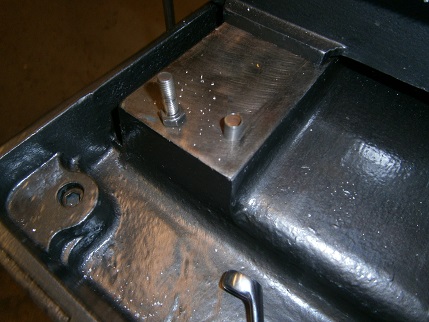

I think that tensioner block in the first to third photo's might be another of the Herbert on speck moments. These machines should have a cast block there, rather than one machined from a rectangular block of metal as this one is. The general look of it does make me think its original rather than a replacement piece though, so I'm thinking they may have run out of castings for the adjusters at some point and just made some up from what they had to hand.
