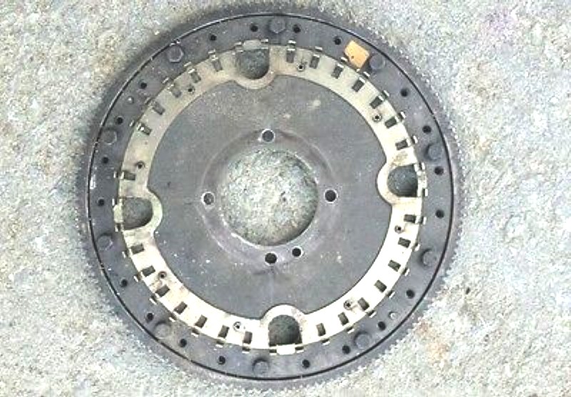

Shouldn't be too hard to do, the straight edges where it's broke off look like they are where the stickup bits should be also you can measure the spacing from the others.or how successful would be the option of manufacturing the two missing teeth and welding them in position.
(Particularly my welding!)

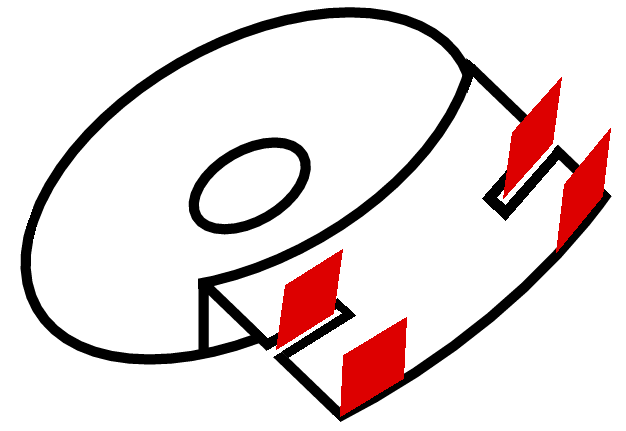

Personally I'd get a washer that fits around that sunken bolt, weld a strip around 1/3 of the edge to get up out of the hole, then weld some flat to that to recreate the missing bit and then finally cut 4 slots in from the ends so you can insert the sticky-up-bits and weld them from the rear, dress it all off and bolt it in place. Couple of hours tops from start to finish.
I'll do you a diagram if it will make it easier to understand what I mean, but like I say a couple of hours should do it fine.

No probs mate, hope this helps....I think I know what you mean, but thanks a picture tells a thousand words, so I'd appreciate it.

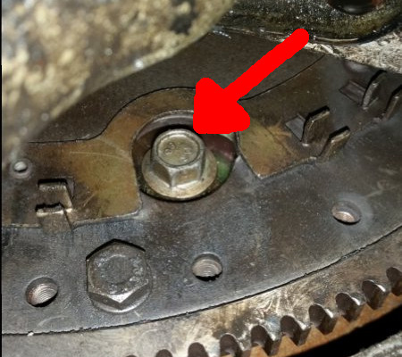

Why has that section around the bolt hole got the little cut out in it ? the one to the right of the bolt head it looks like the cut is intentional.
