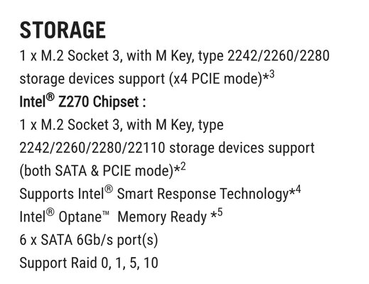

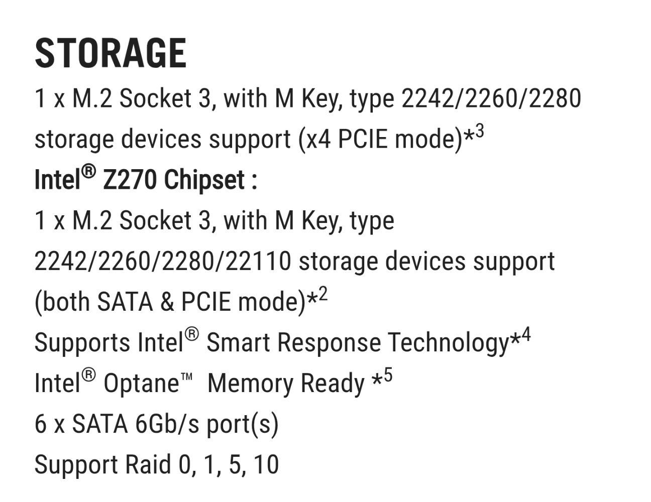

What mobo have got as there are two versions of M.2, there's M.2 SATA which is no faster than a traditional SATA 3 SSD and then there's M.2 NVMe, which use the PCI e bus. This is a direct connection to the CPU rather than going through a SATA controller, so it's much faster as @Kayos saysI have just found the new mobo can use m2 cards. which is better SSD or M2 card?
OMG i wish they would stop developing. LolWhat mobo have got as there are two versions of M.2, there's M.2 SATA which is no faster than a traditional SATA 3 SSD and then there's M.2 NVMe, which use the PCI e bus. This is a direct connection to the CPU rather than going through a SATA controller, so it's much faster as @Kayos says
It says it supports PCIe mode so that's good and it's the one you want for best speed.
