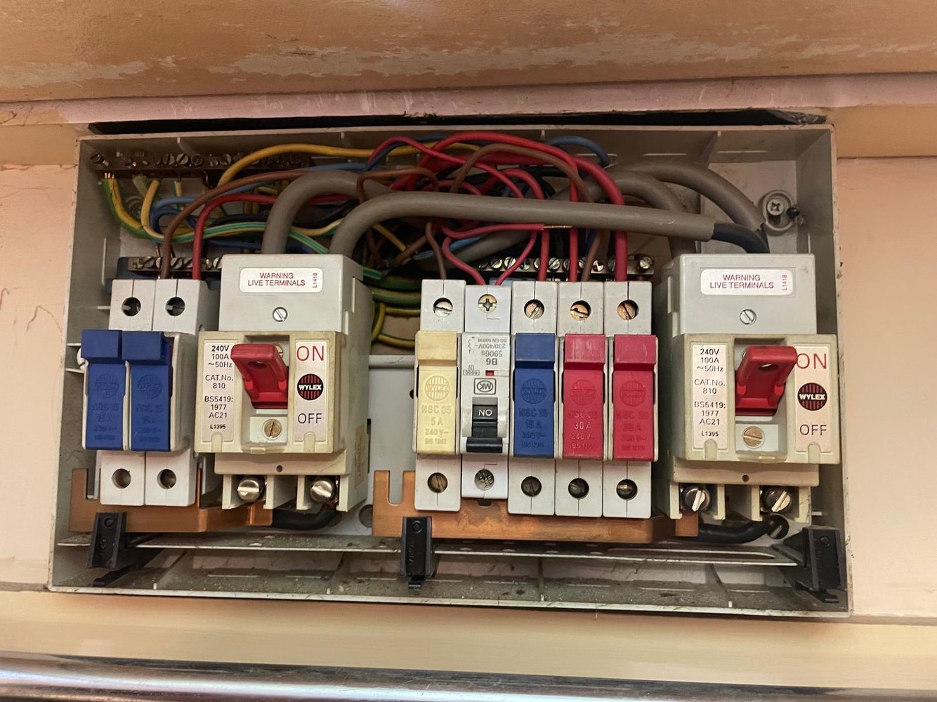

Workmate showed me pics of his install. He has a sparks coming round to look. I've told him to go all RCBO on the assumption he has a new board fitted.
(His missus has apparently found a local sparks based on he's fit and has tattoos

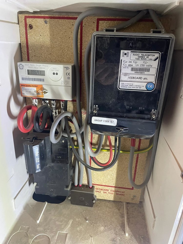

I'm aware though of the RTS switch off in I think June 2025.
How might that affect his choice of cu?

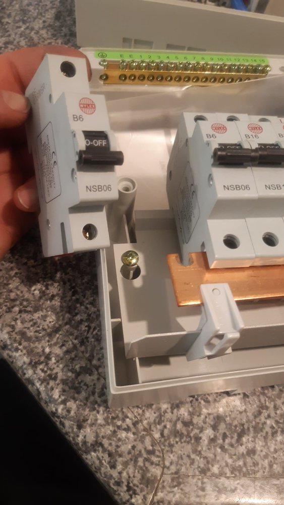

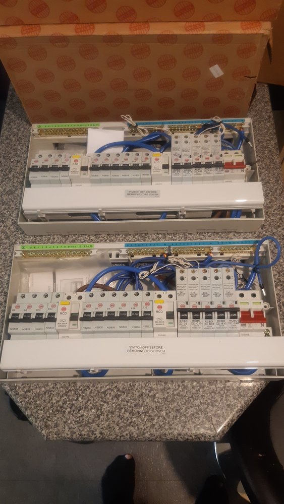

I did offer him the guts of two boards I have here if he wanted to play Frankenboard albeit all Wylex. Should in theory fit I think. I bought them on a whim dirt cheap when plastic CUs became a dirty word:
