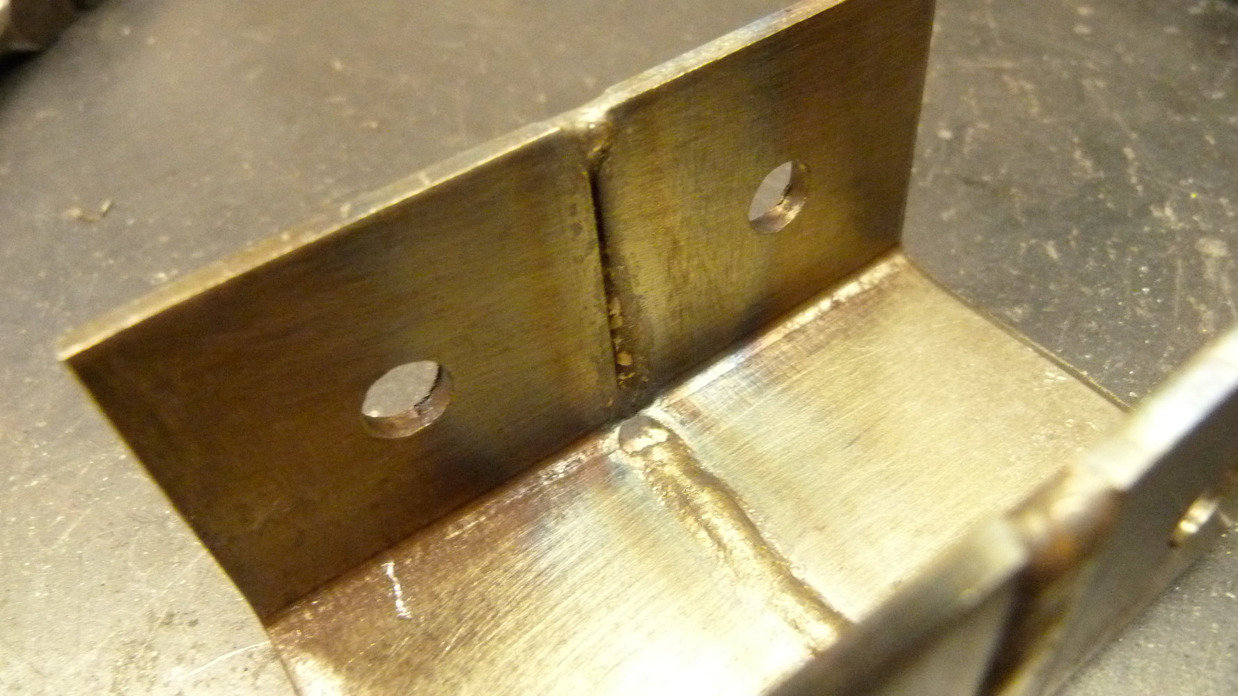

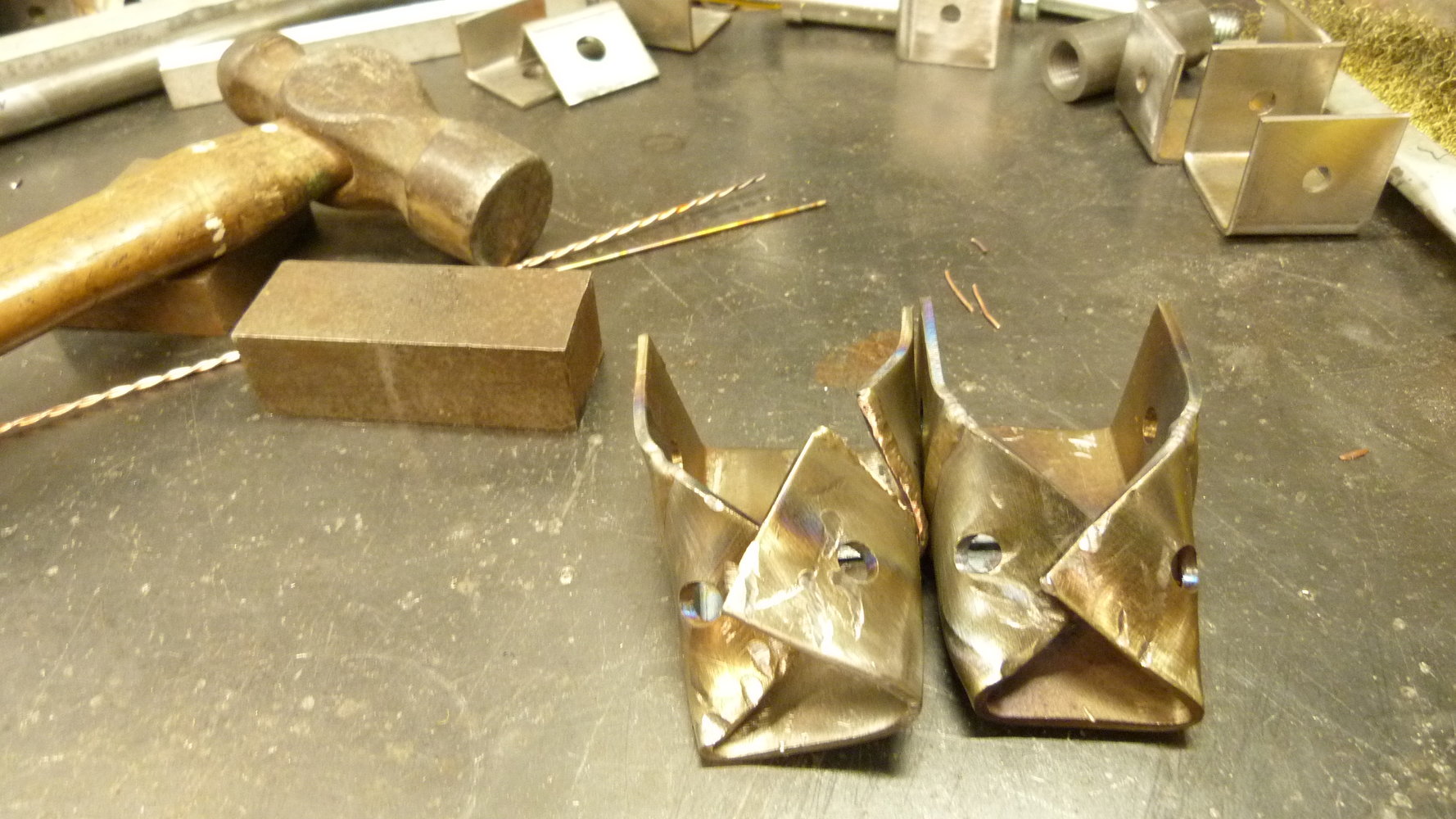

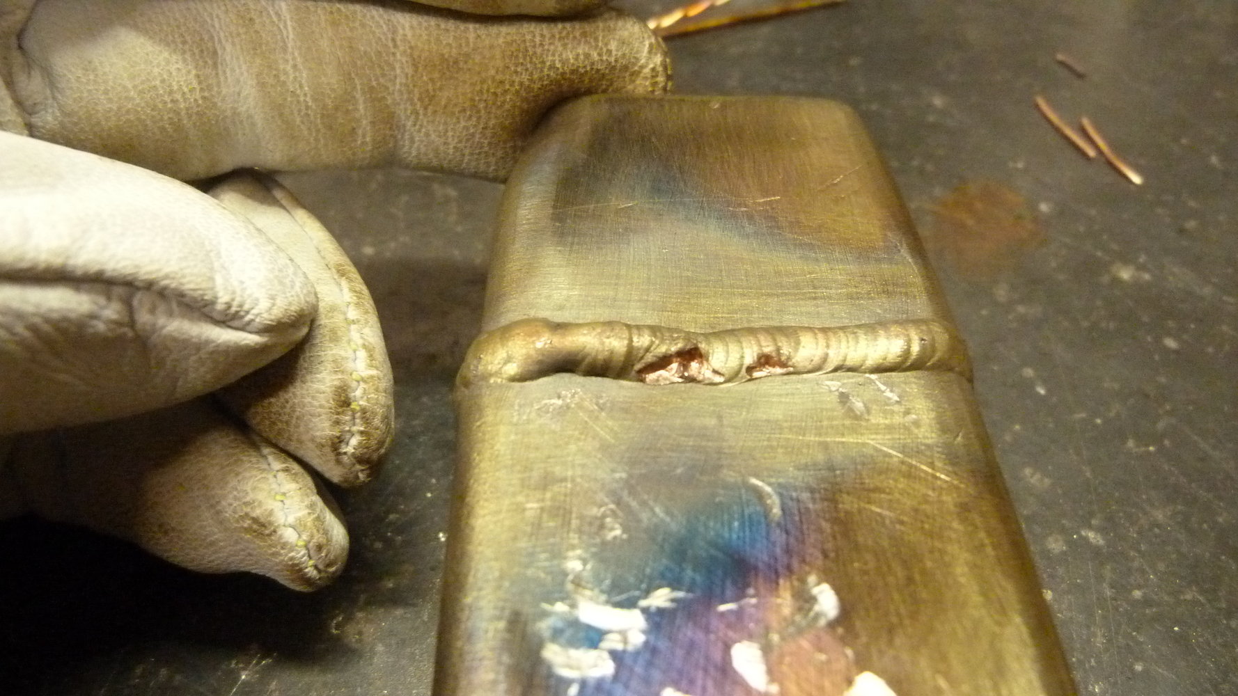

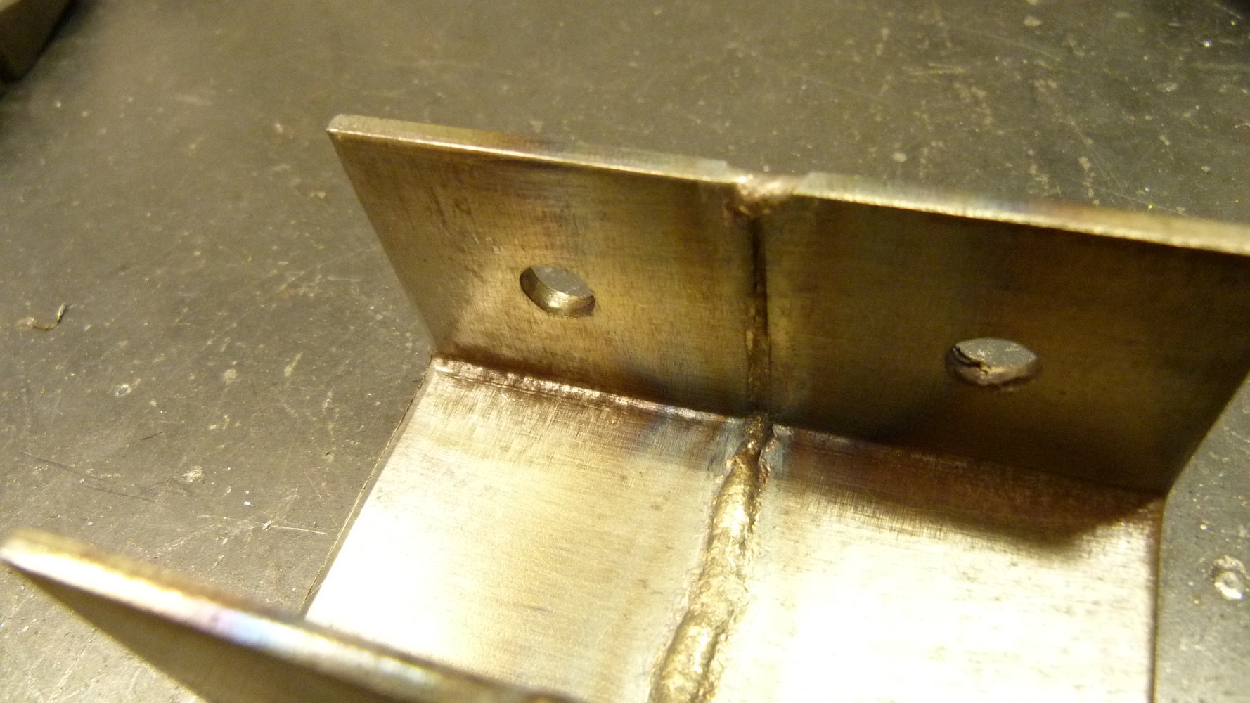

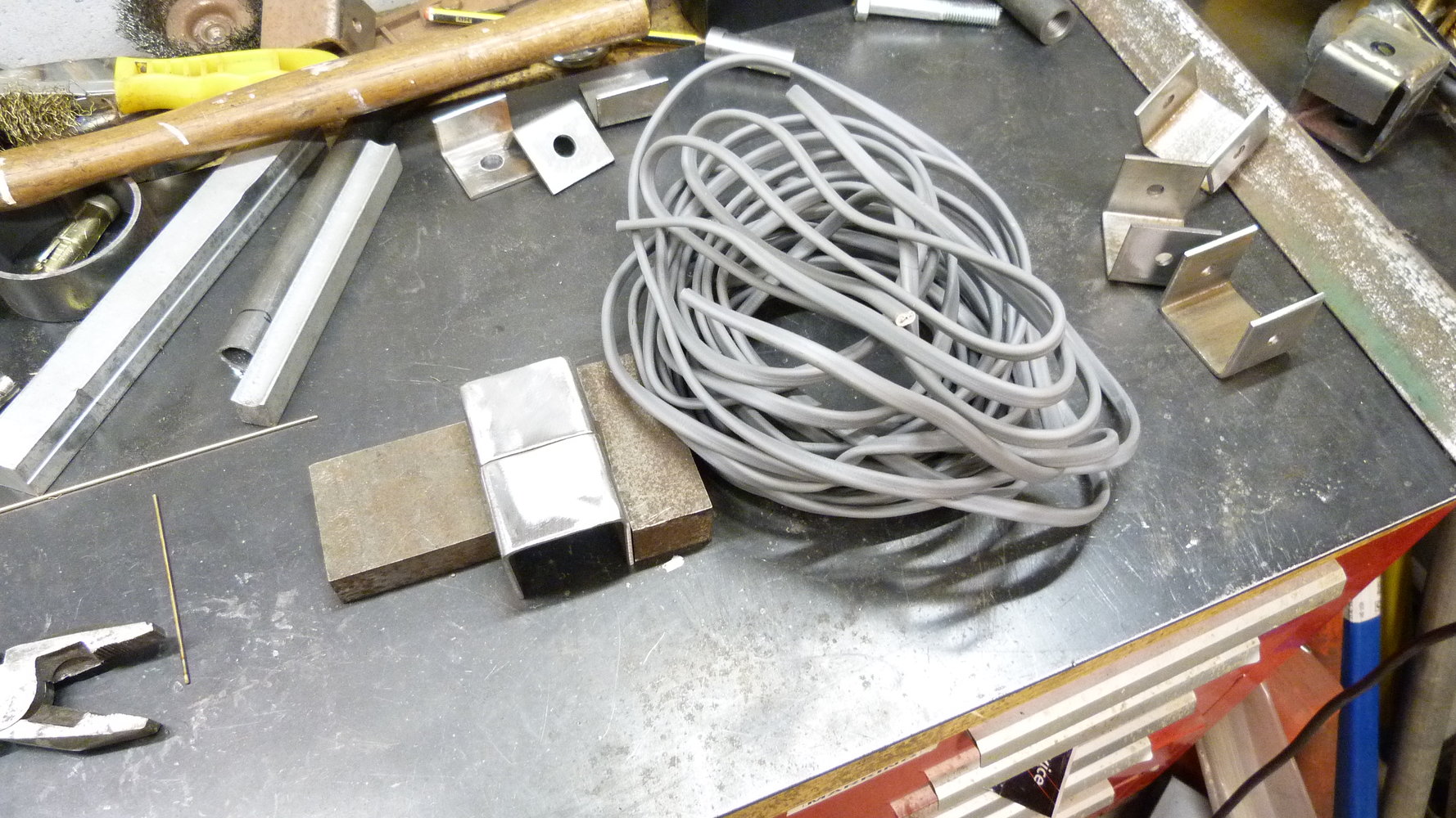

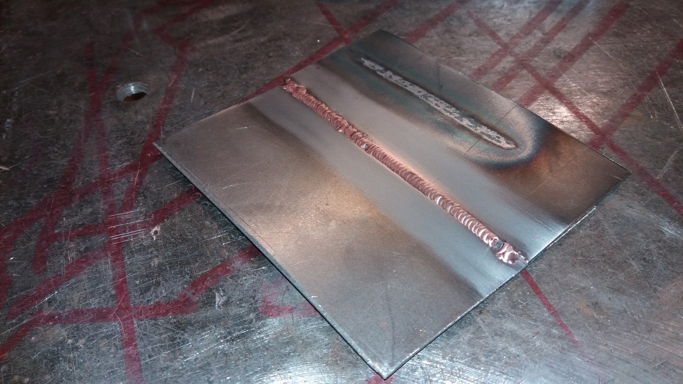

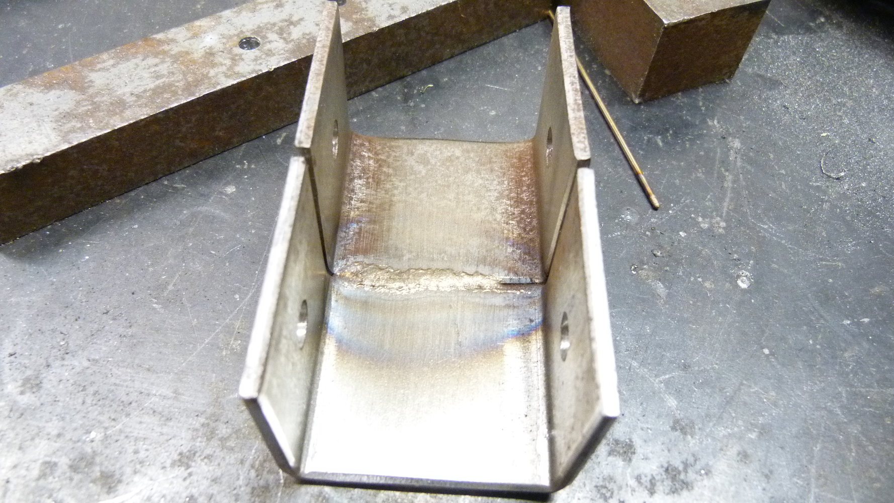

Final bit today I promise. Back to proper brazing wire and now using 85 amps as @premmington advised me that I was brazing too cold.

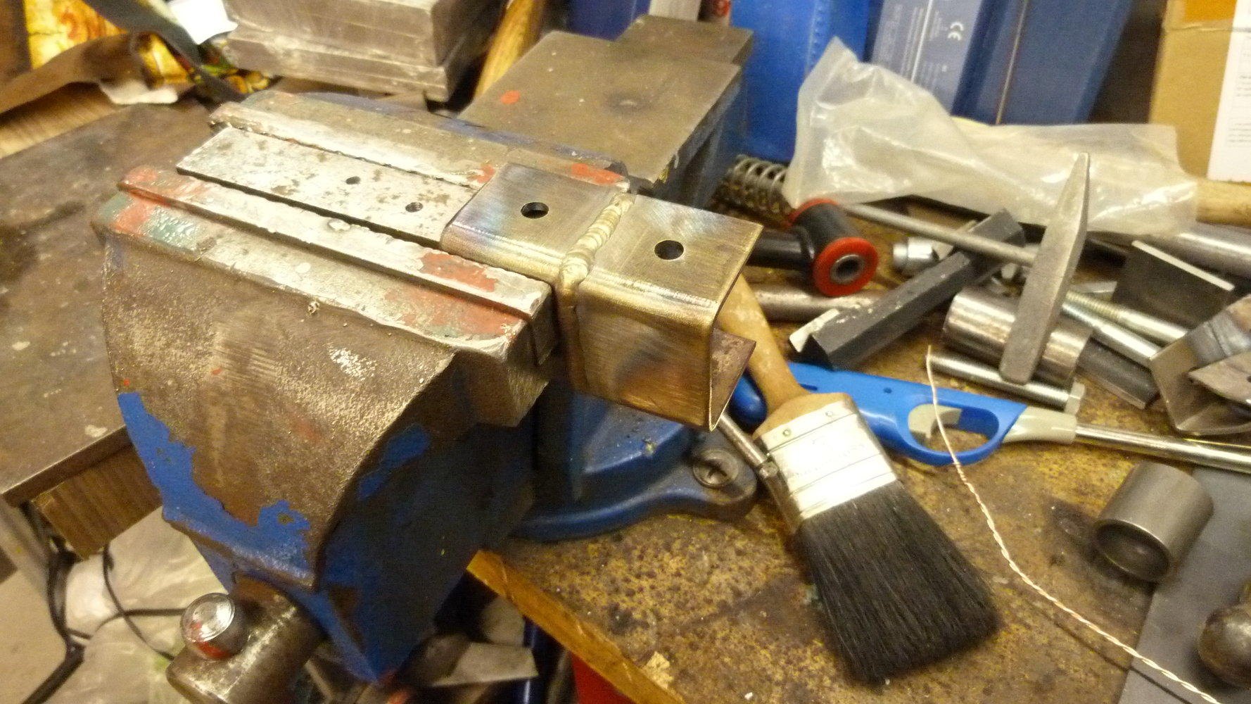

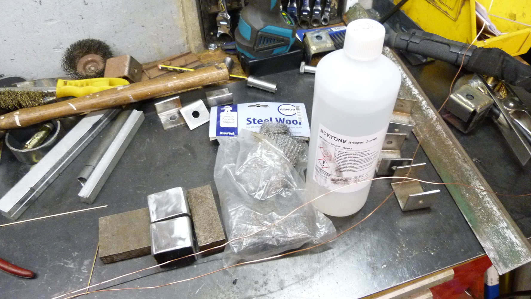

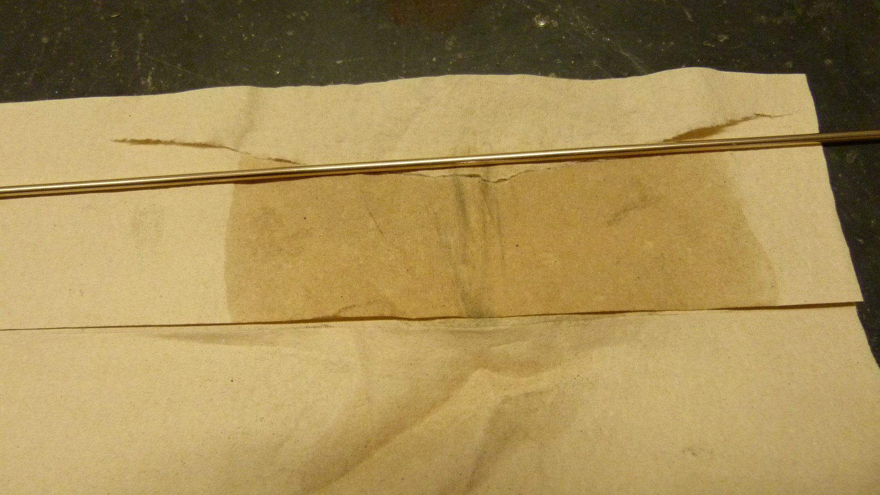

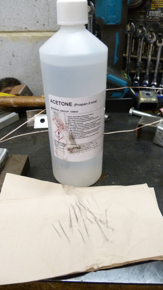

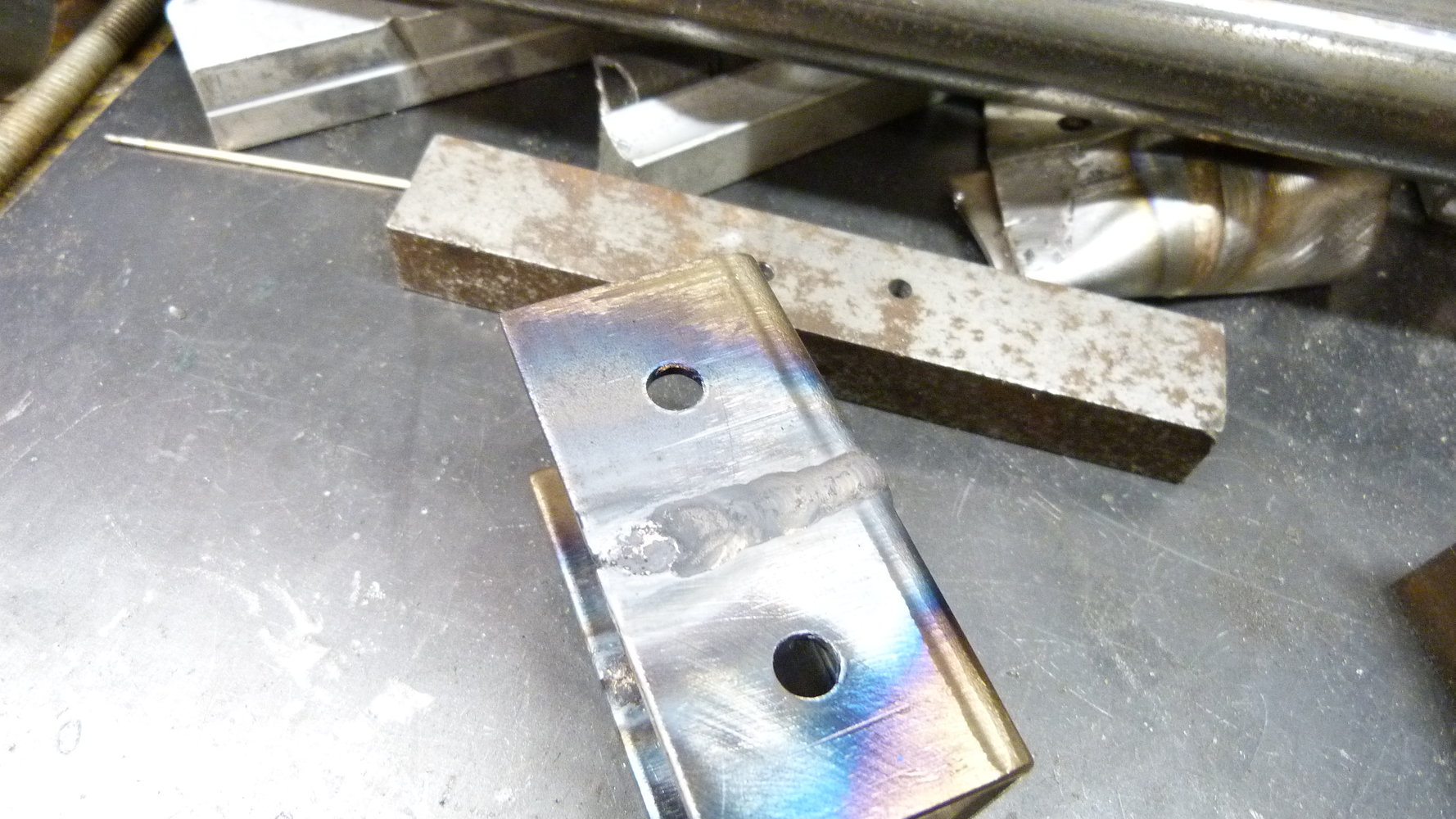

Rod cleaned with Acetone, not as dirty as some wires I have.

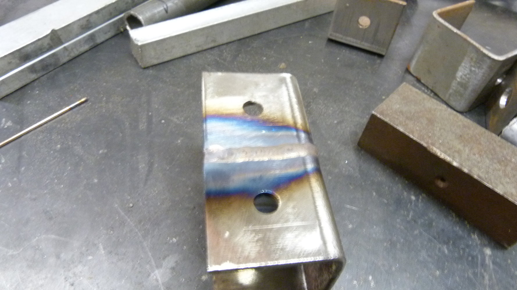

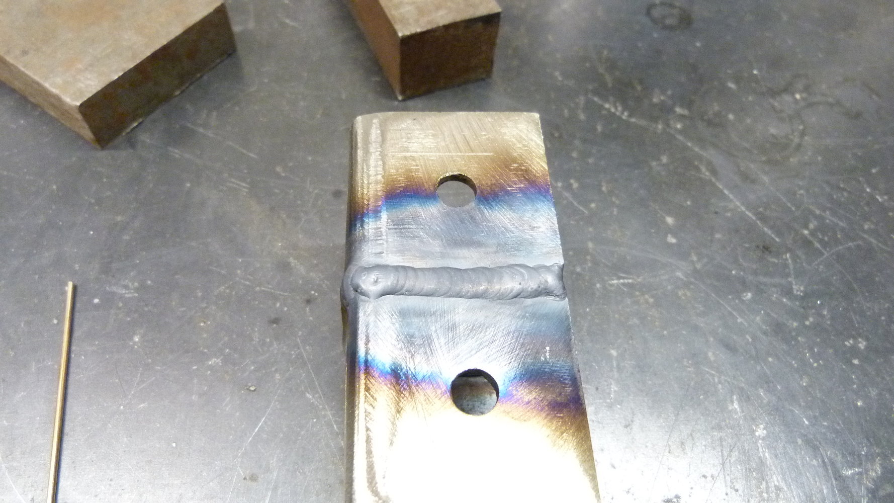

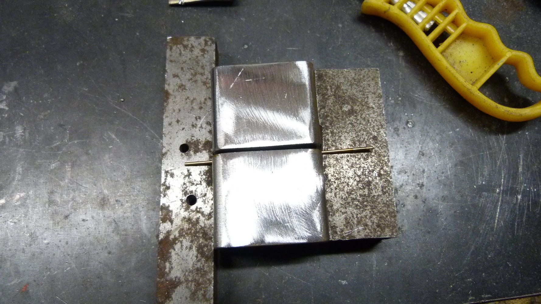

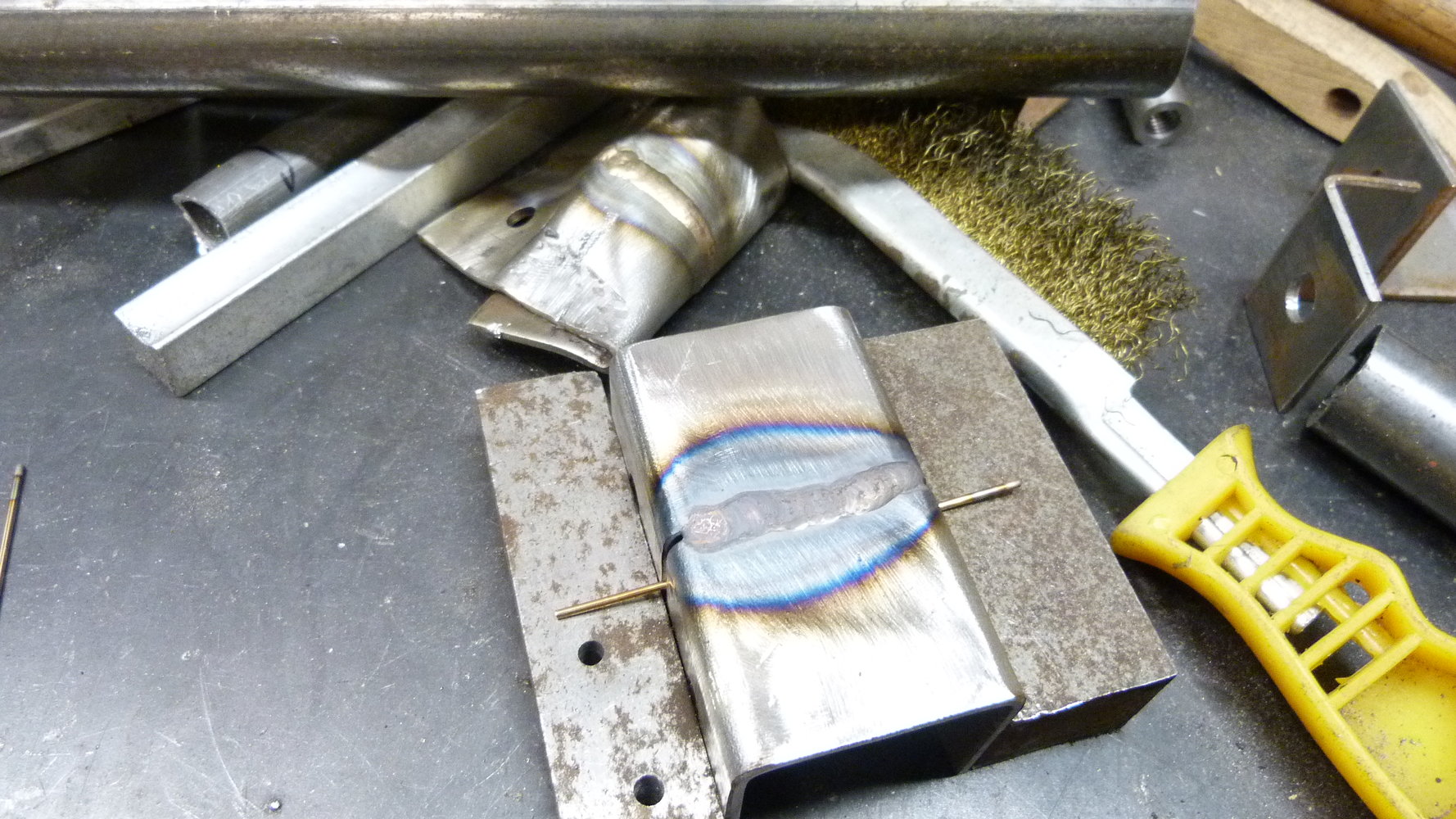

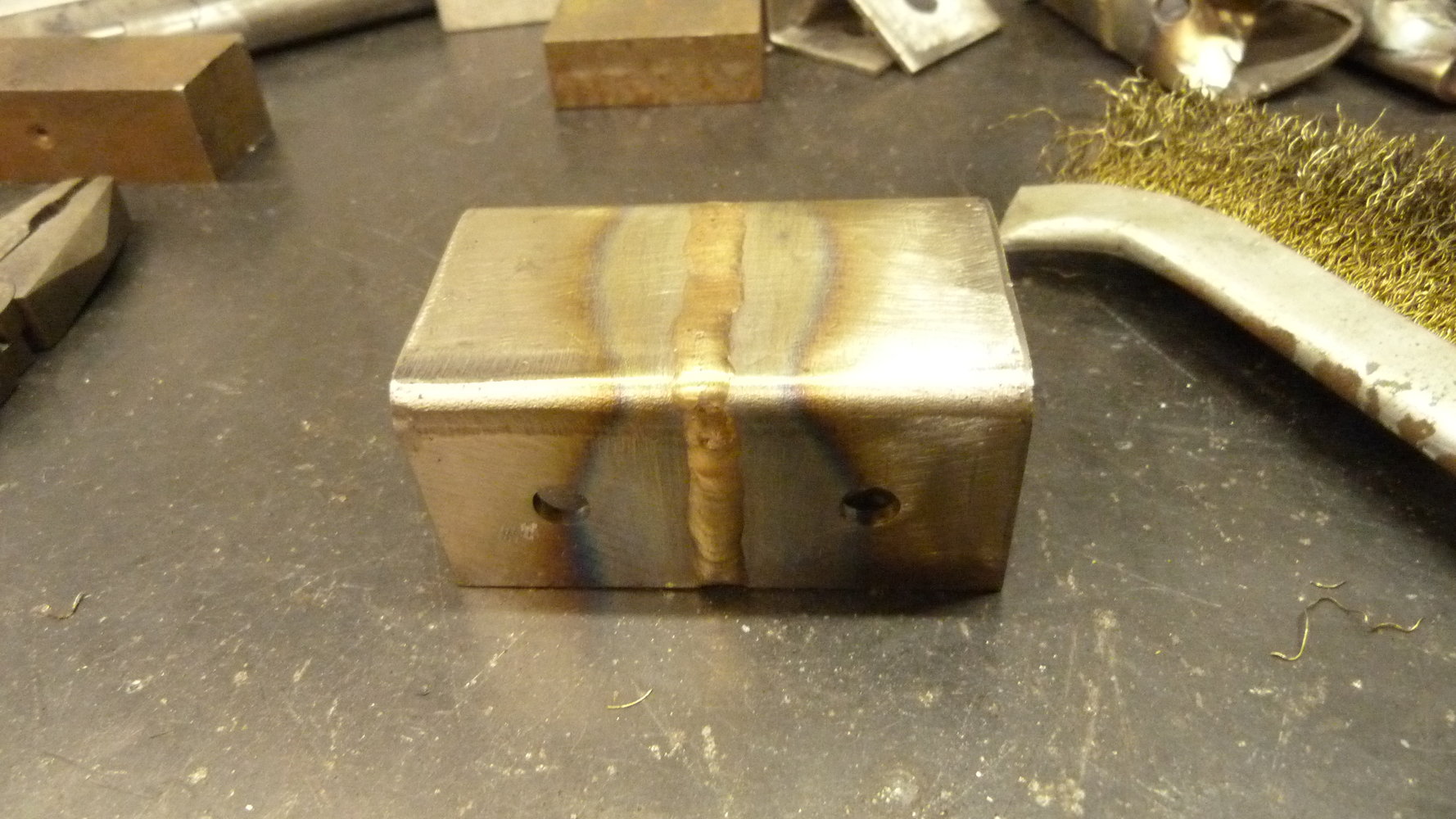

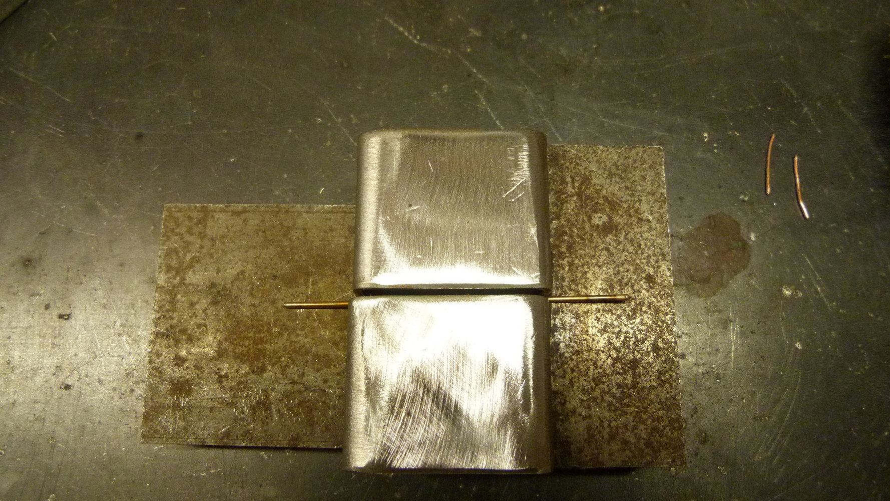

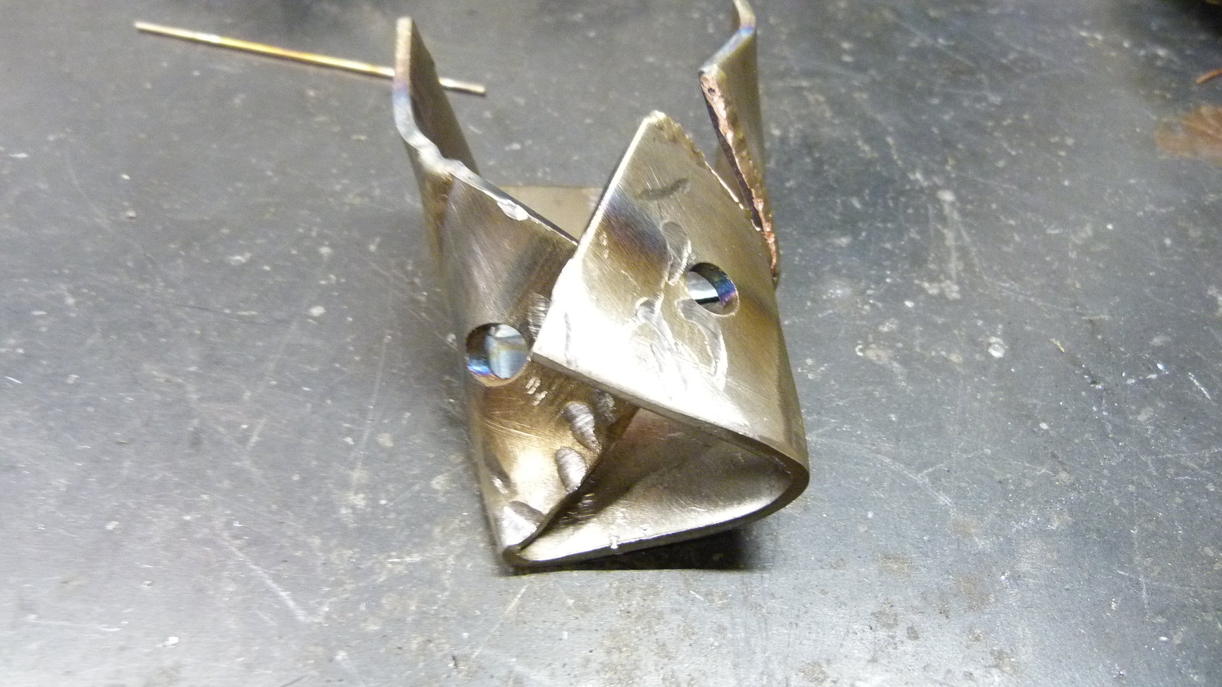

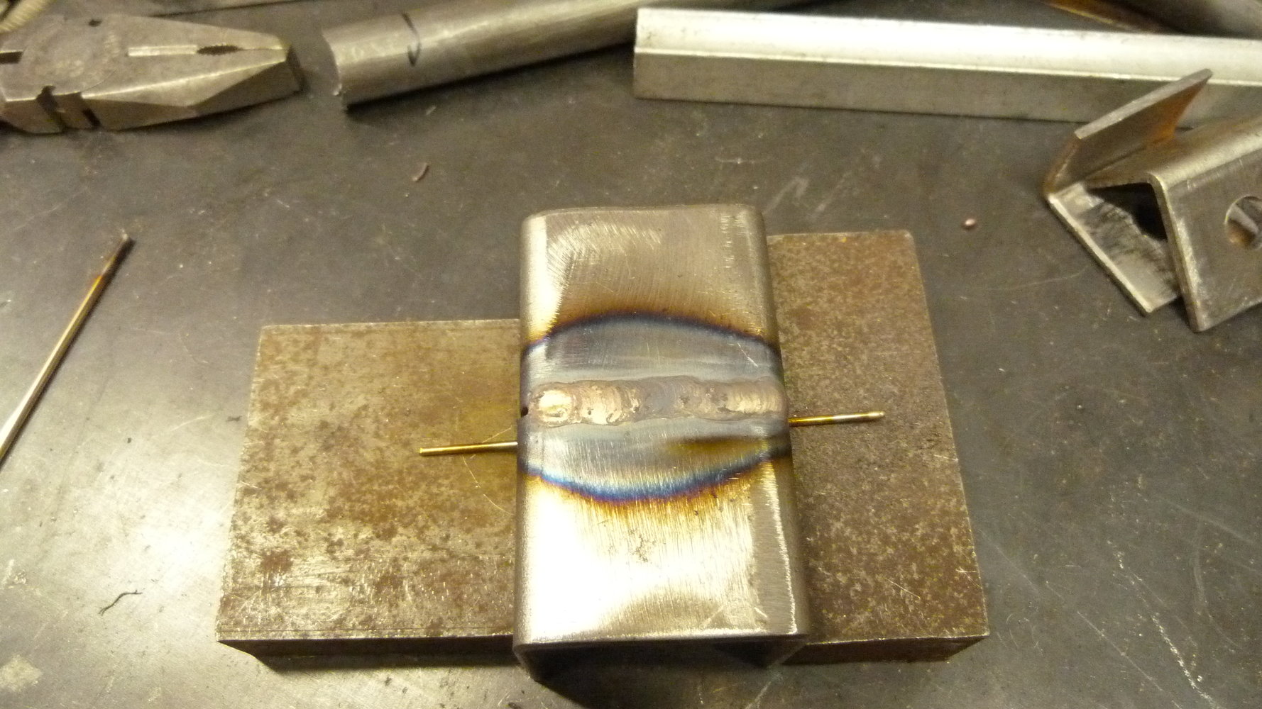

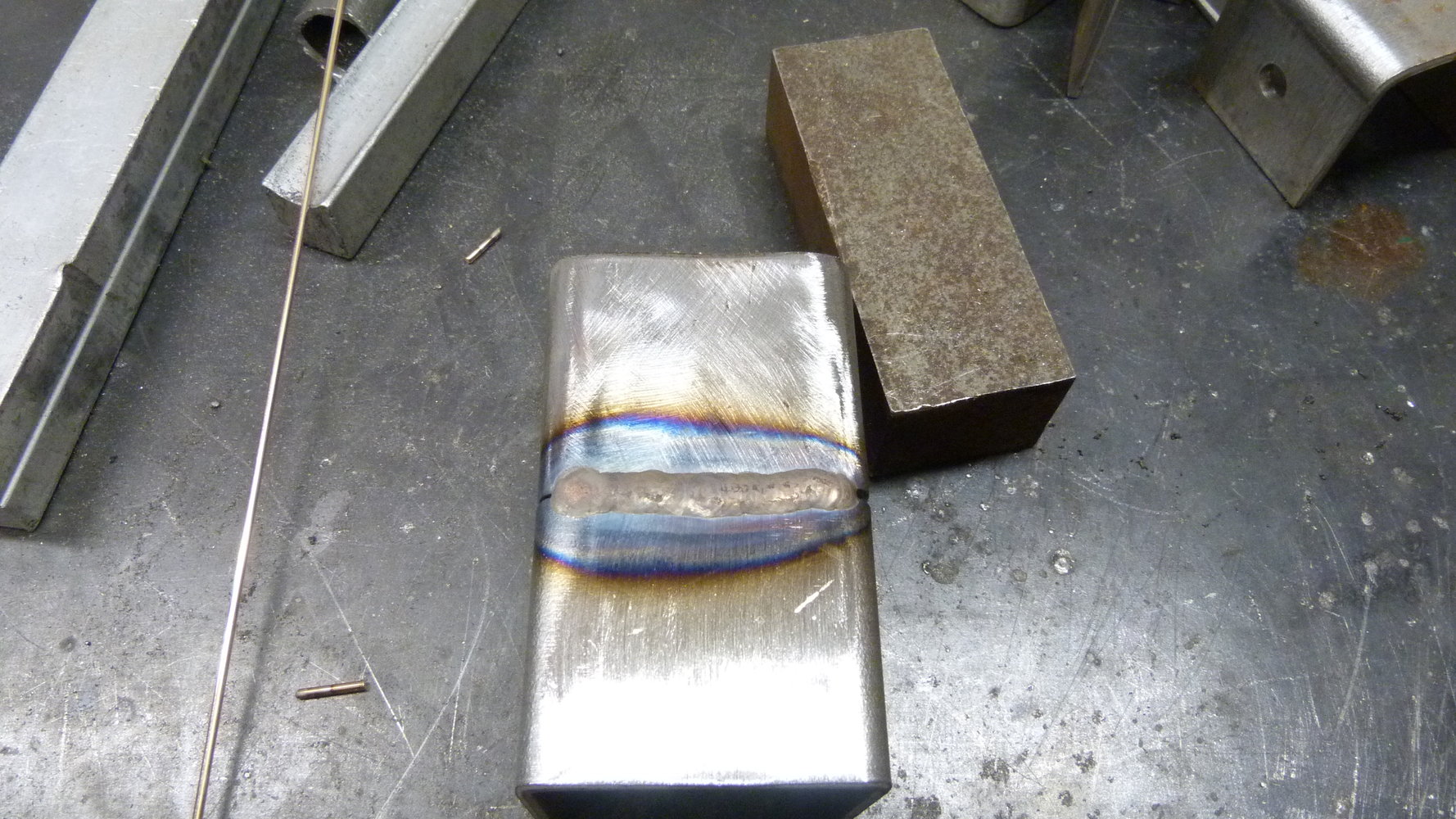

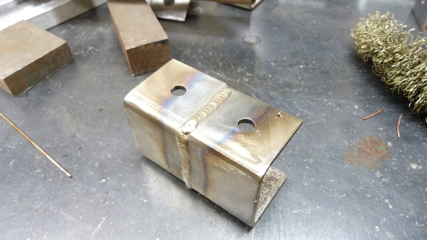

Proper gap. Note the 1.6mm spacer wire. This is prior to wire brushing and the braze is noticably cleaner than before. The extra heat seems to be having a postive effect. The braze is much flatter too.

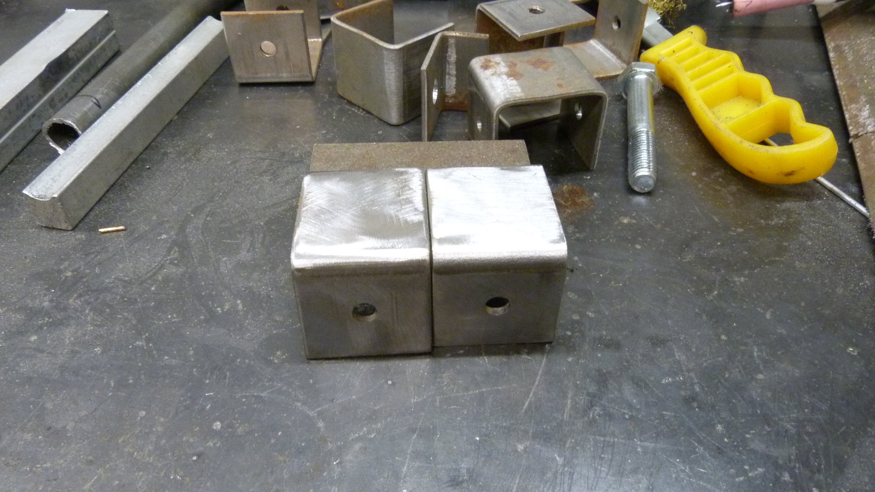

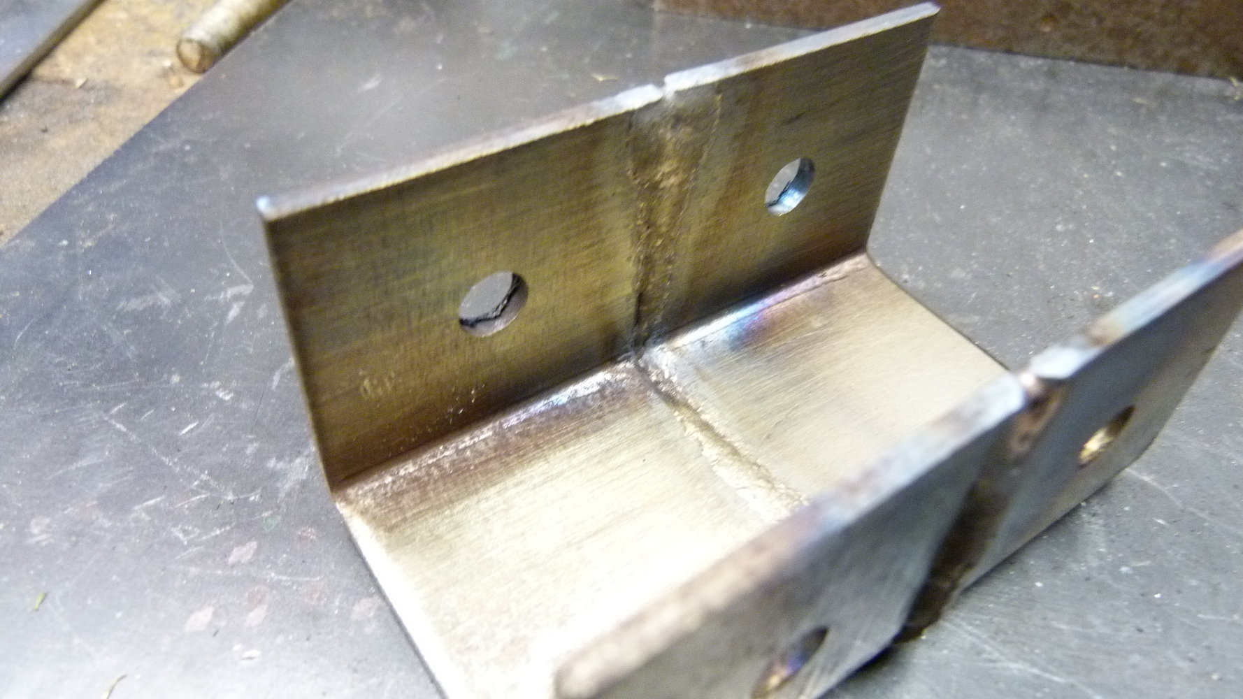

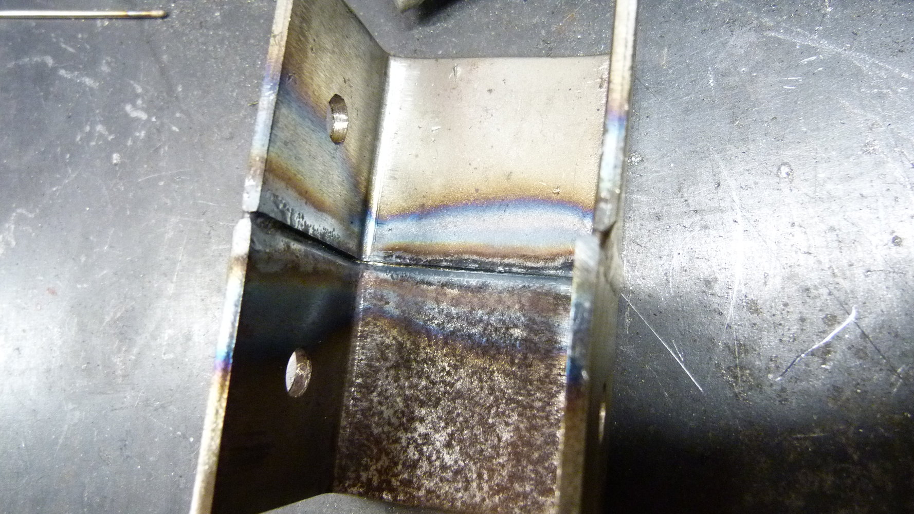

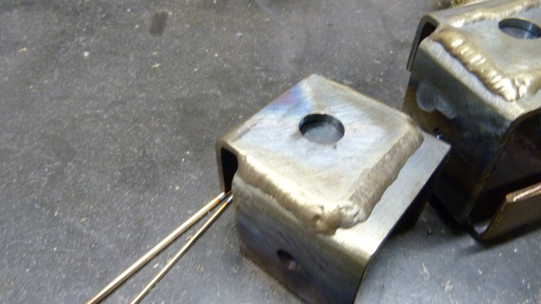

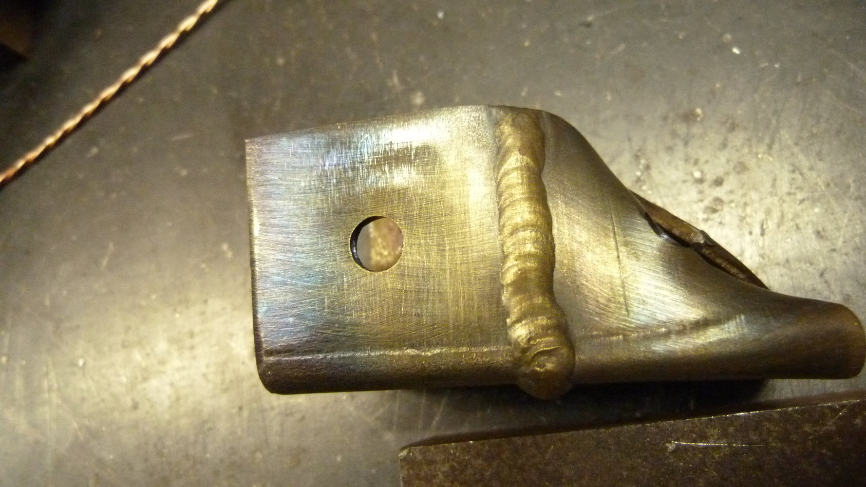

Sides welded towards the middle. Again cleaner looking.

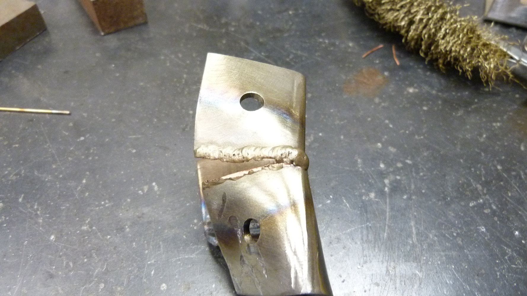

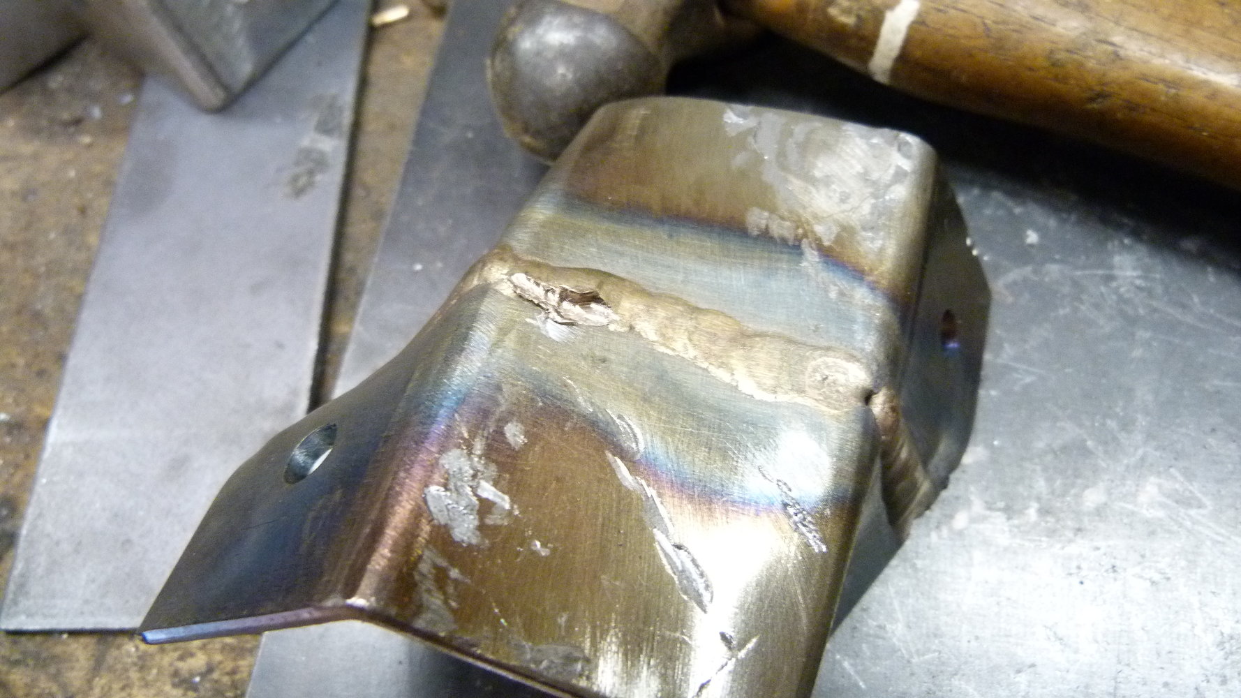

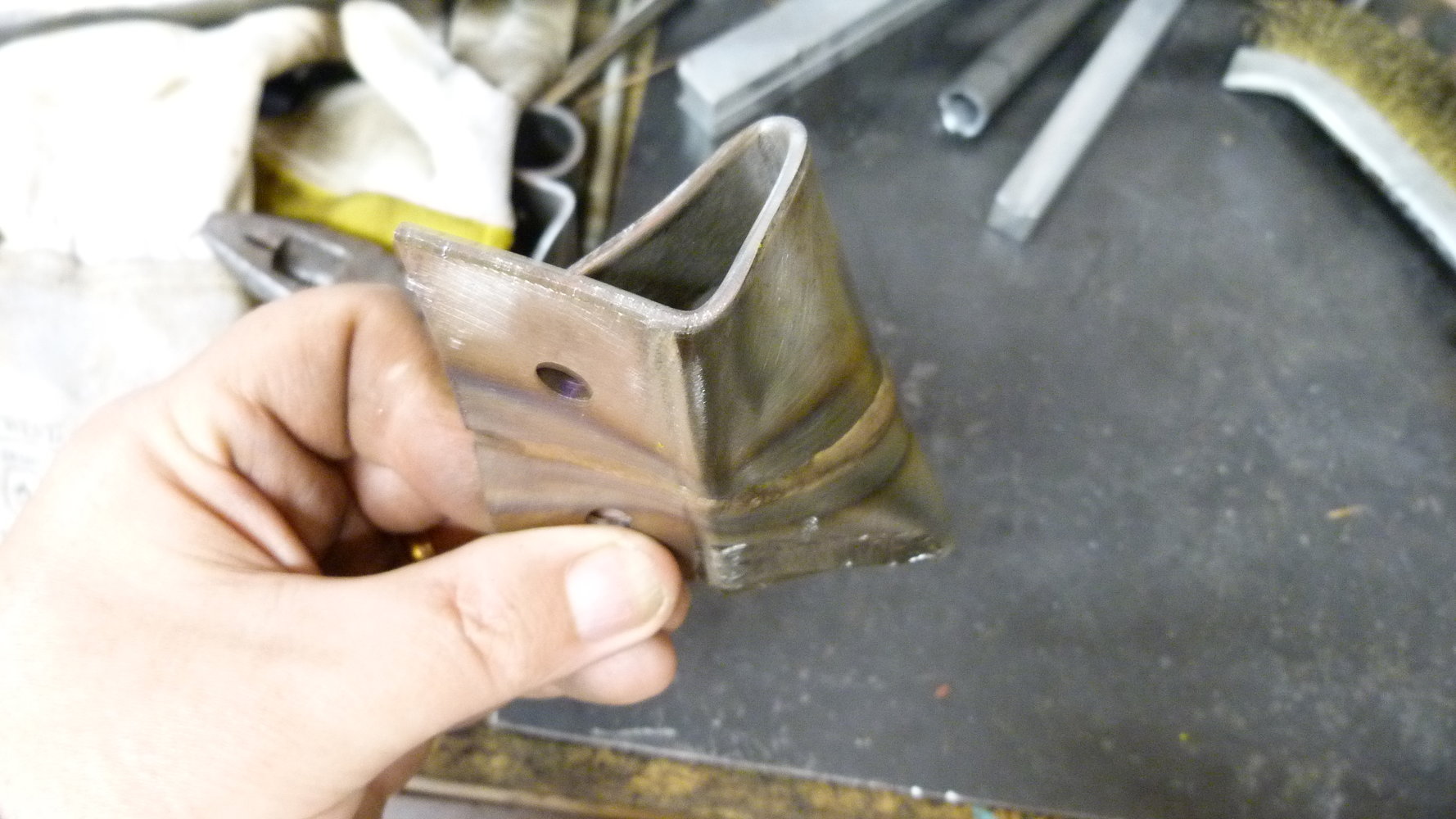

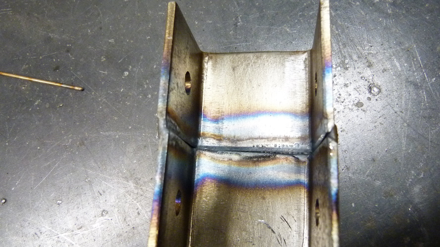

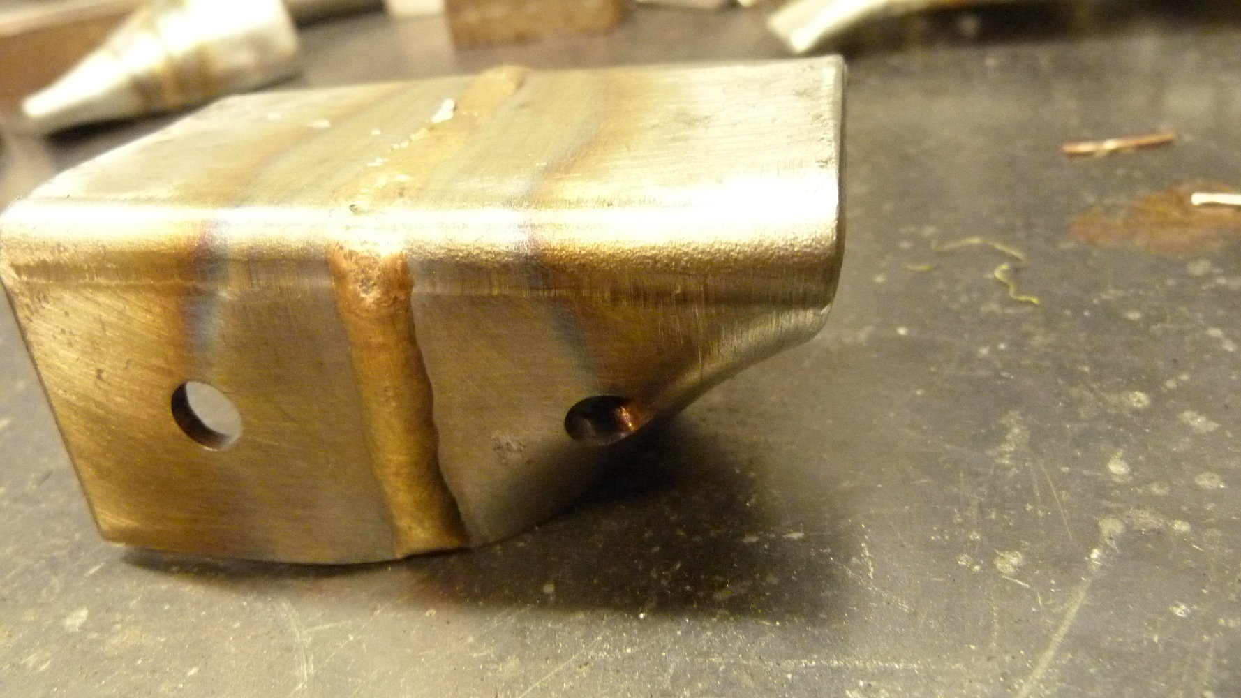

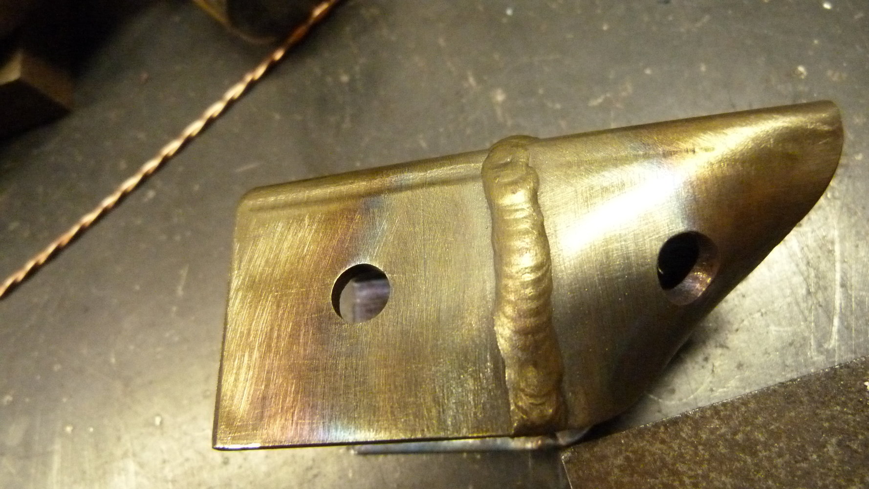

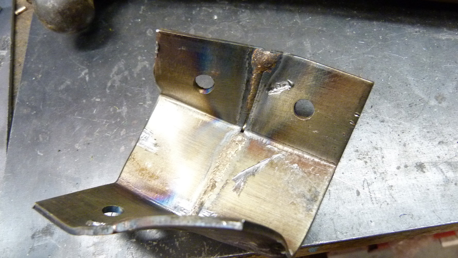

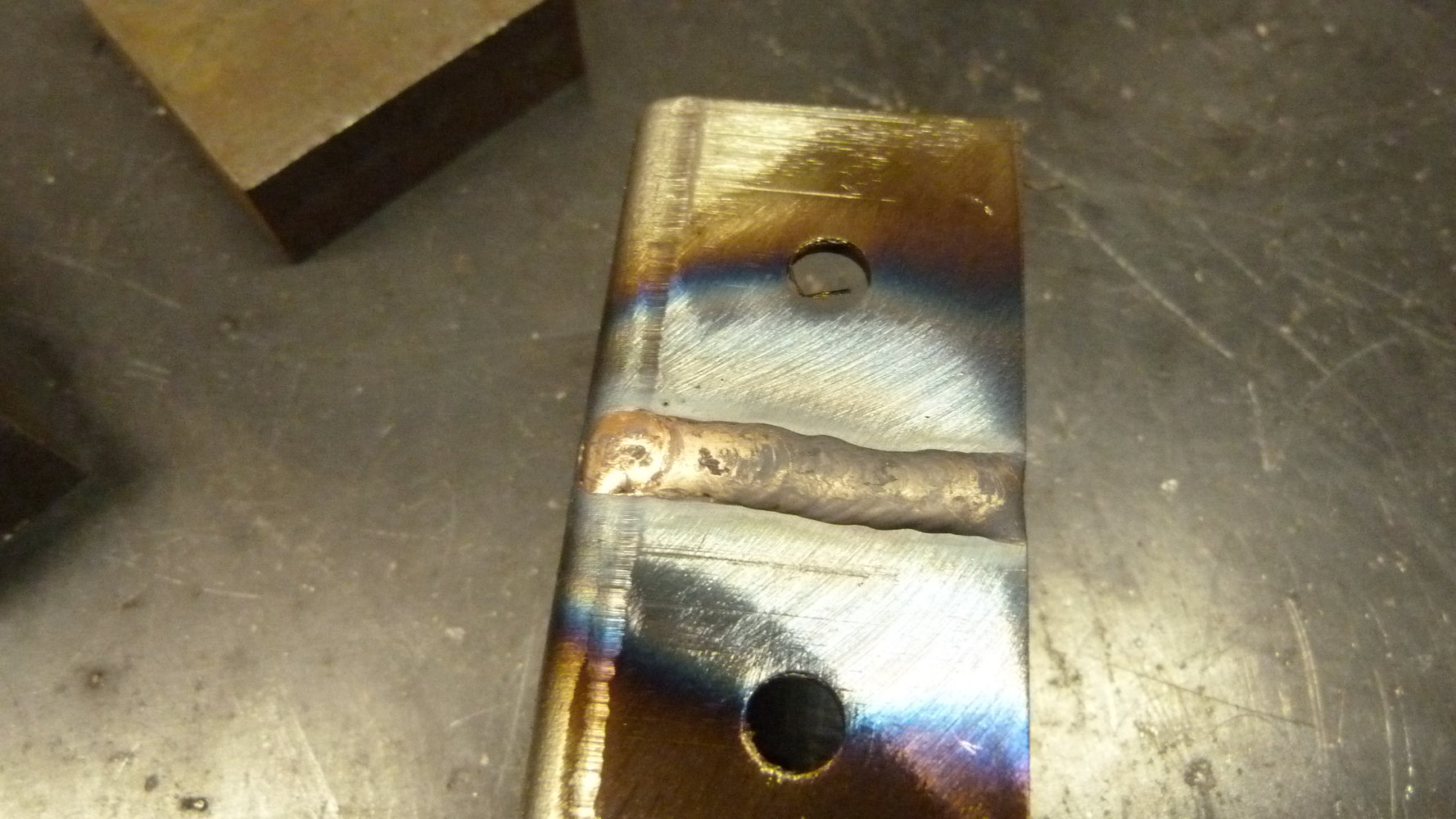

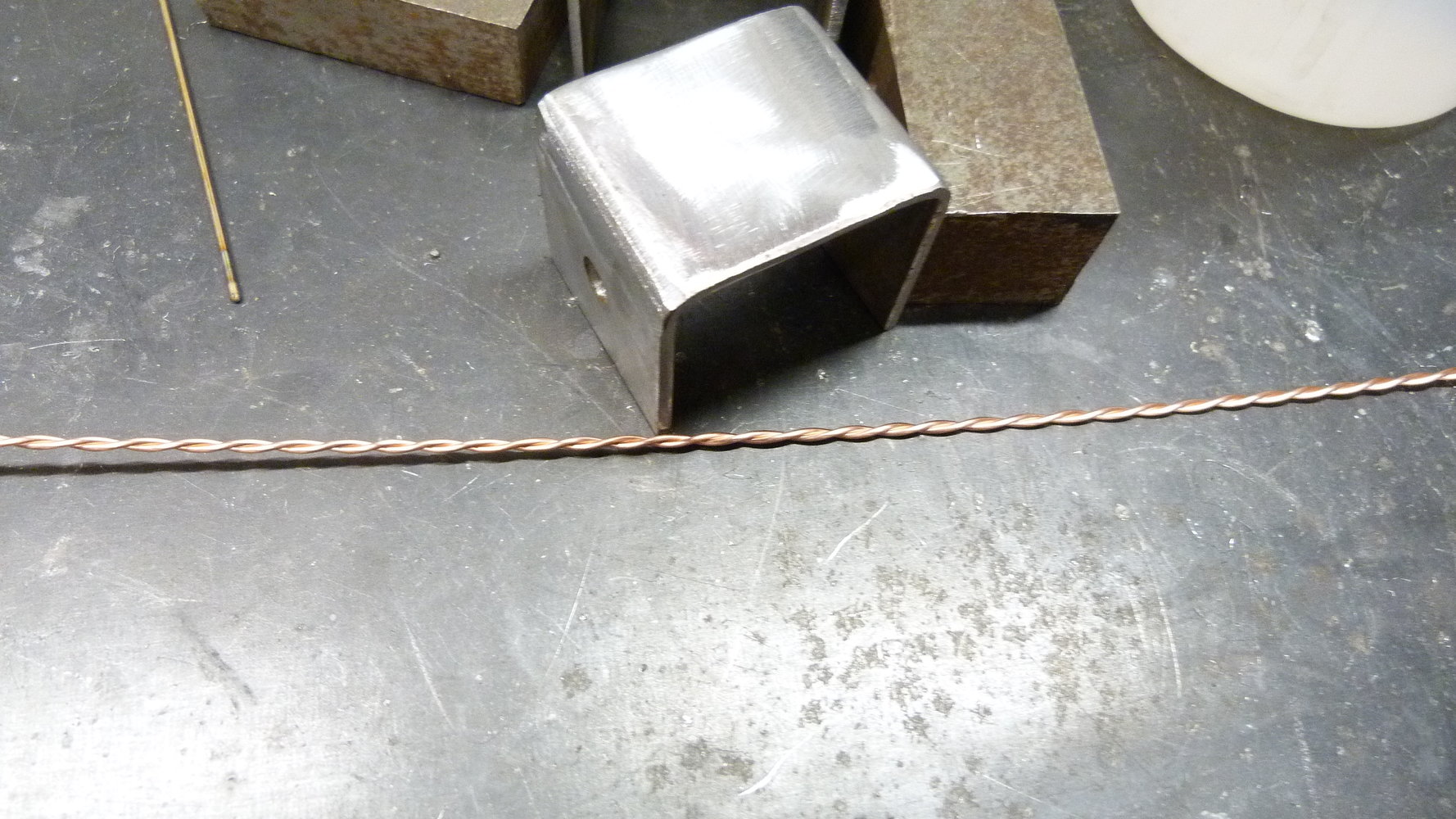

Wire brushed.

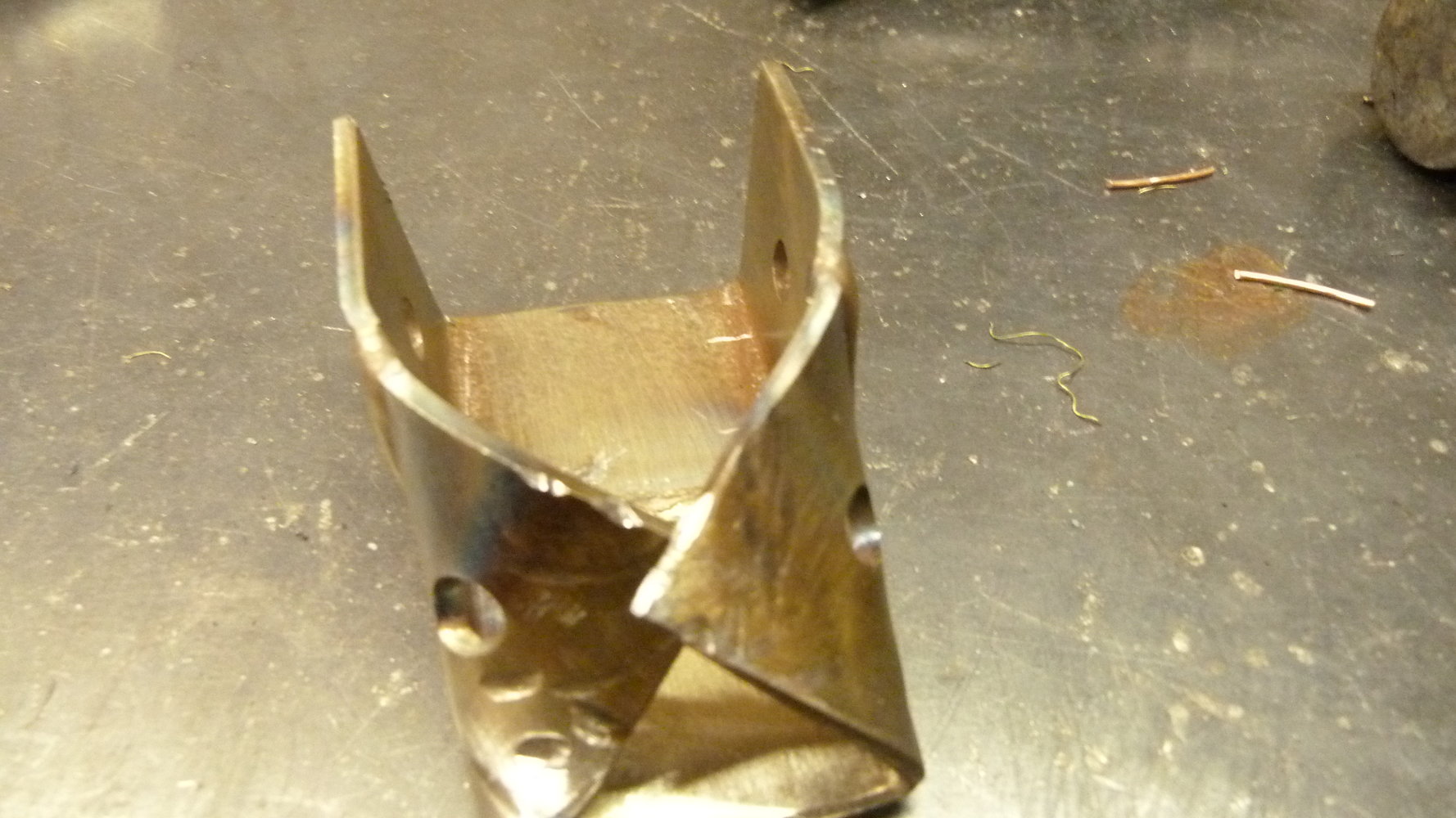

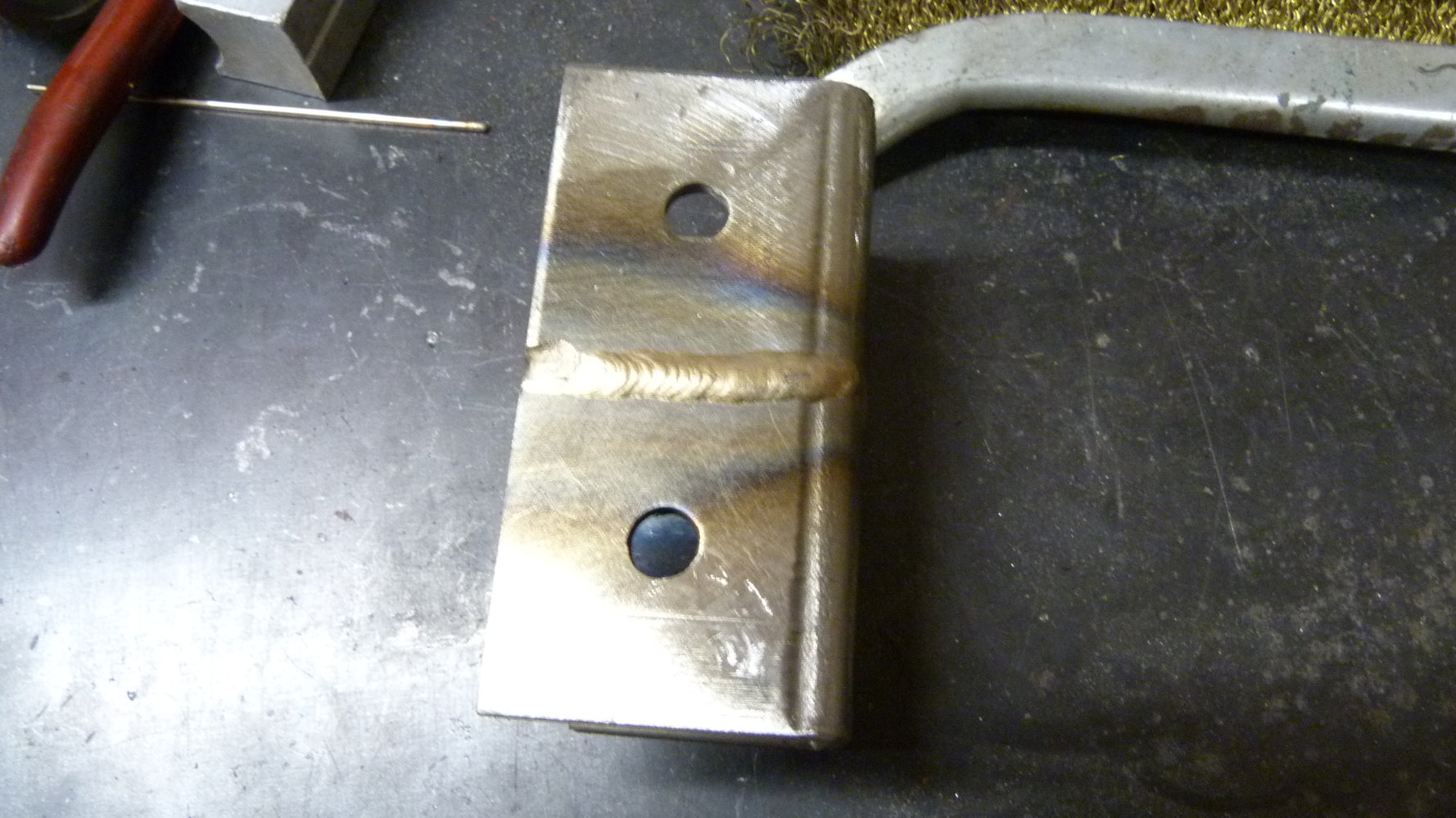

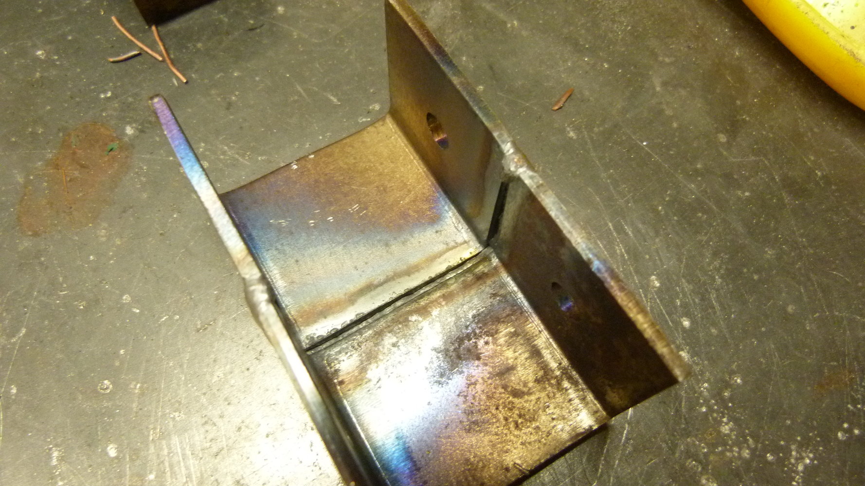

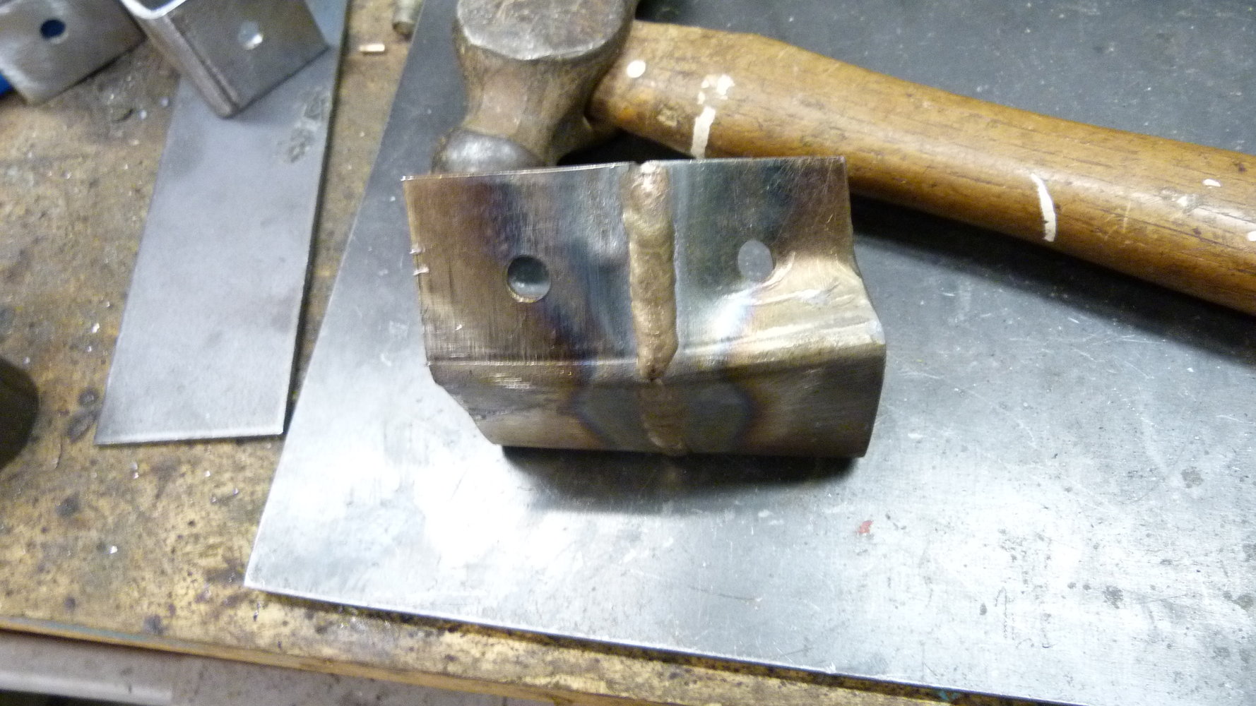

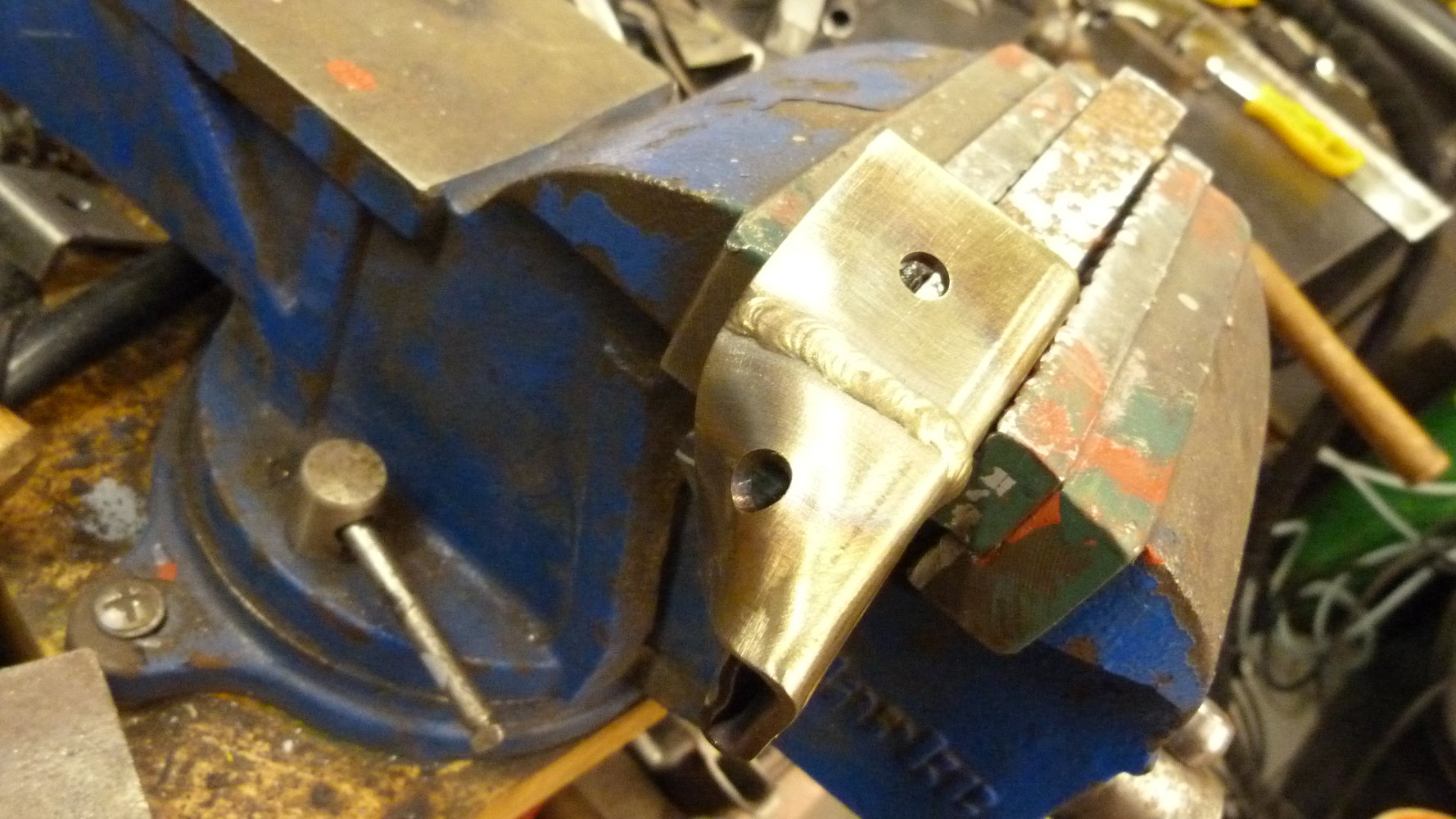

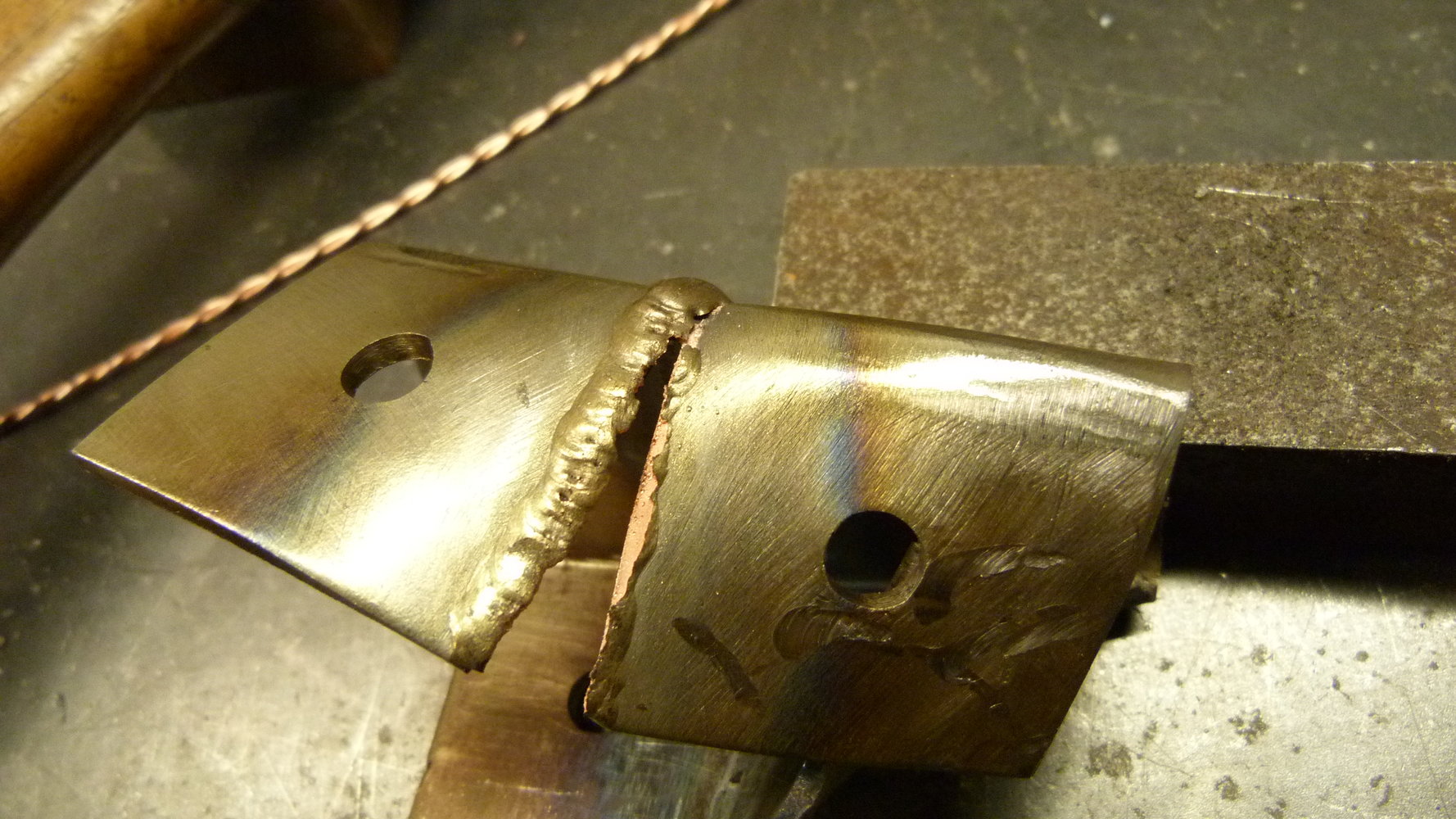

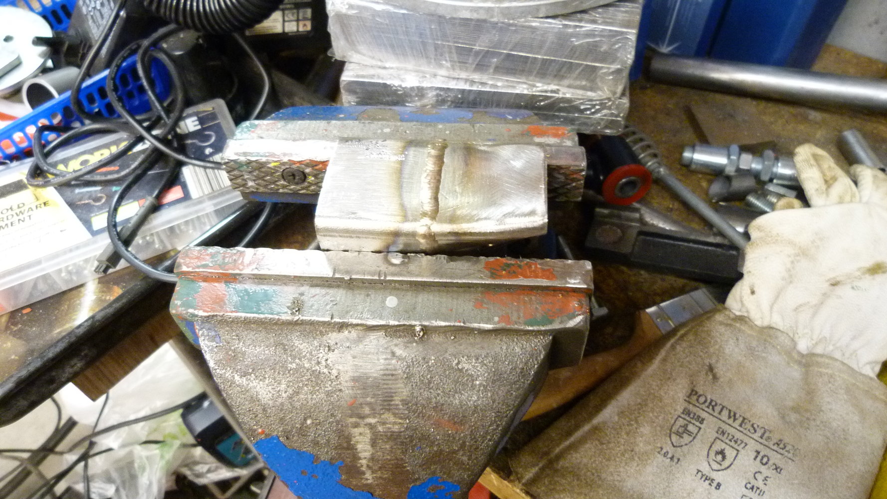

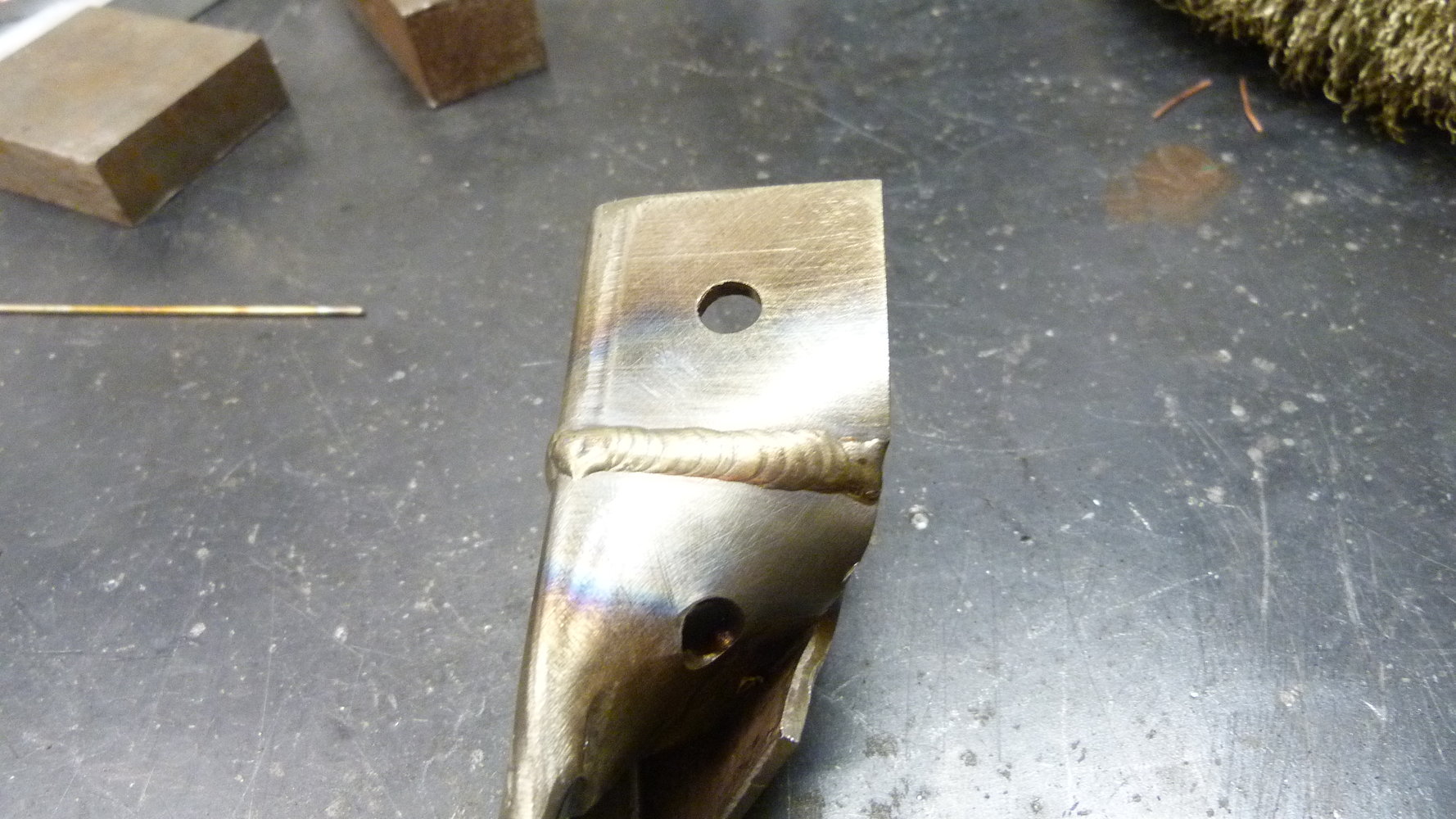

The reverse shows good flow to the back on the first braze but the two sides aren't half as good. I would put that down to operator technique. I got all three runs out of one rod and on the final side I was rushing to finish before I ran out of rod. Otherwise I might have fed a bit more rod into it. Also I felt the need to push on faster on the sides as there is less material to soak up the heat. I should have taken more time.

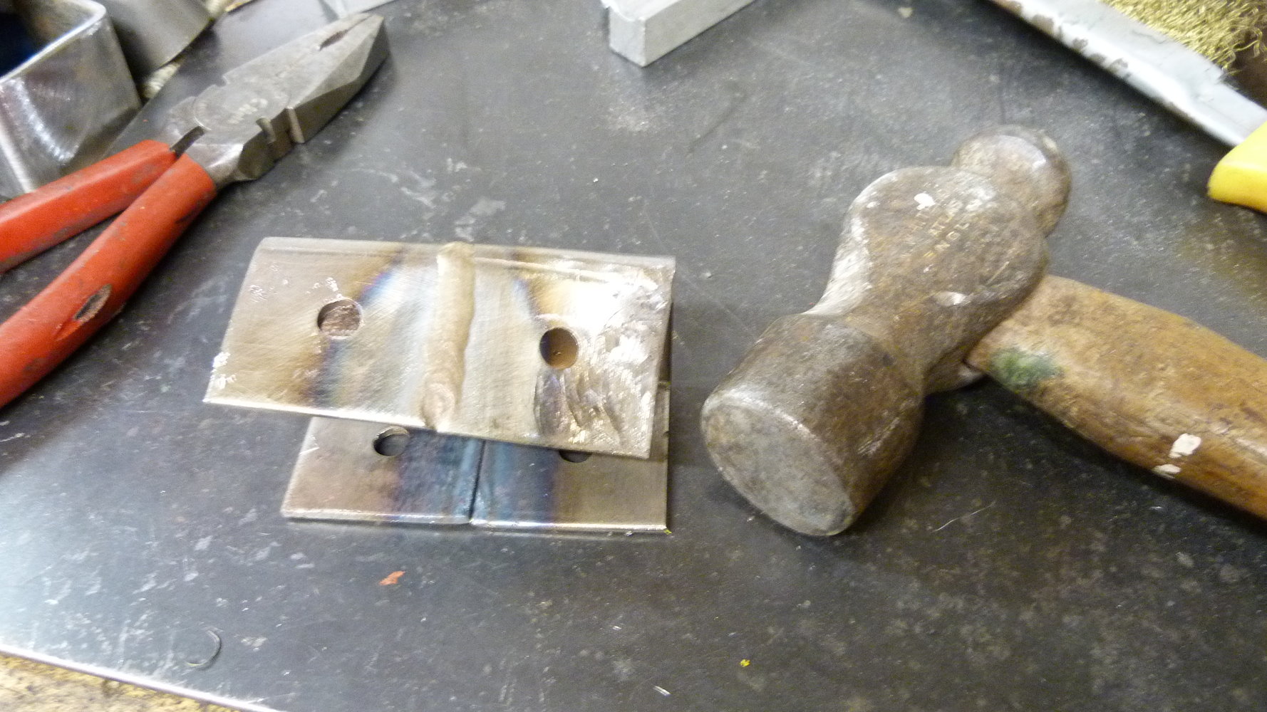

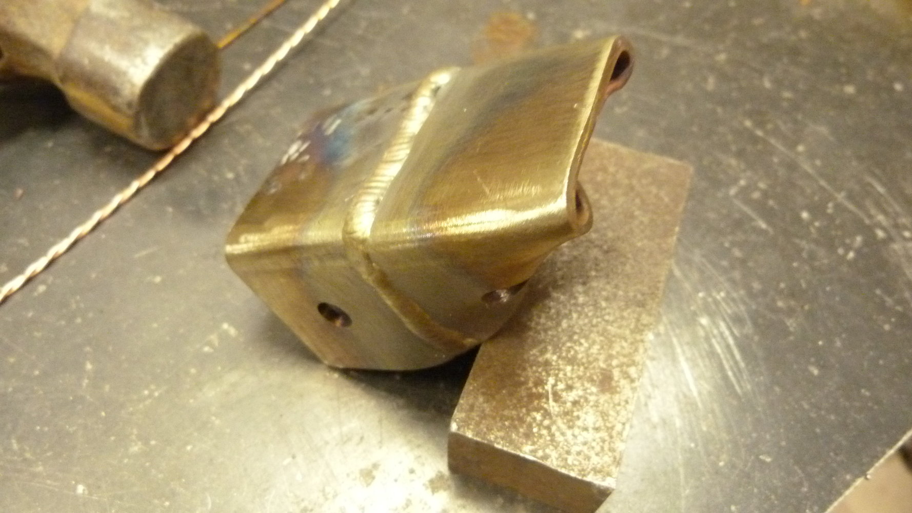

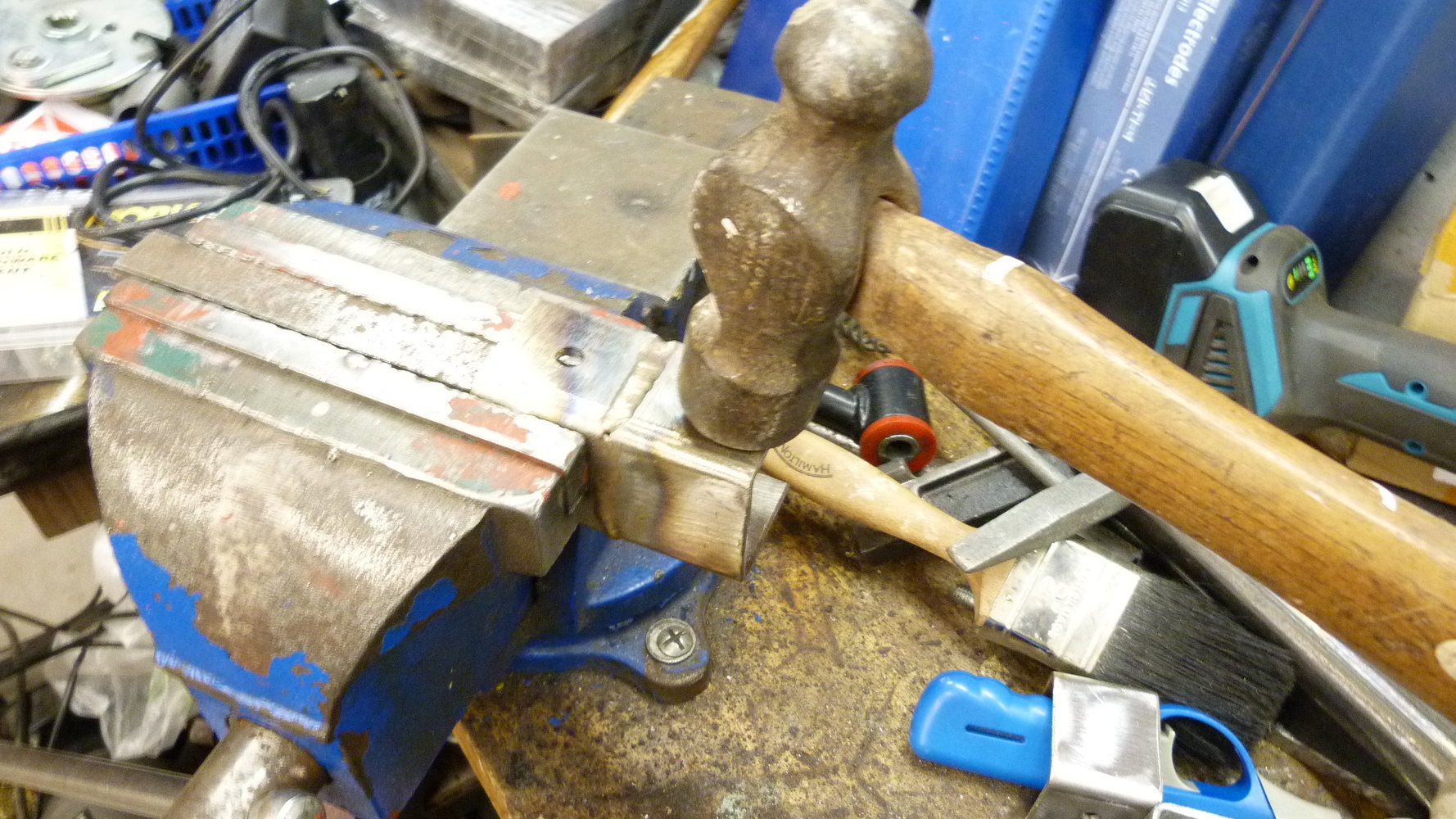

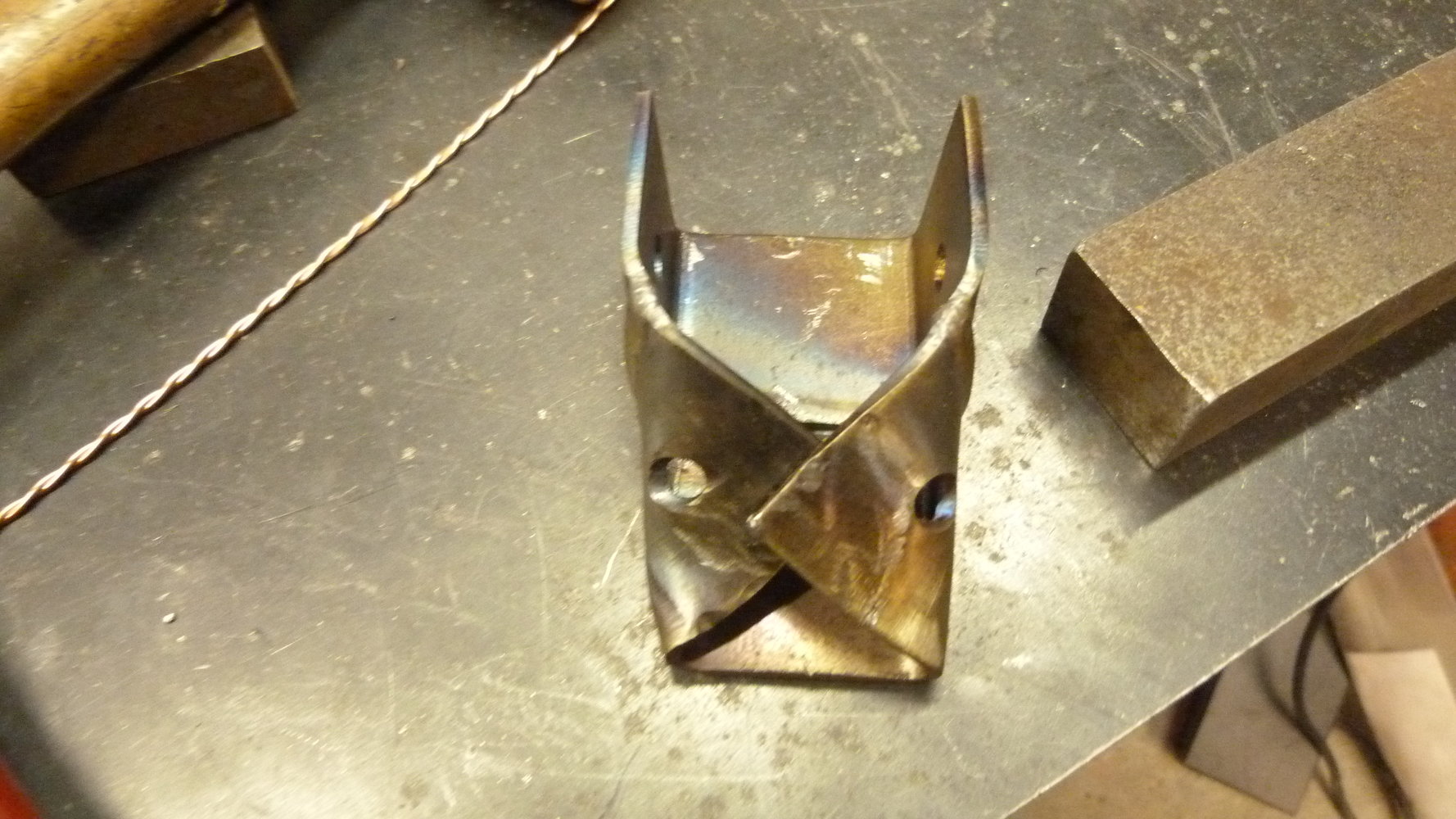

Survives the hammer test all the same. Yay!

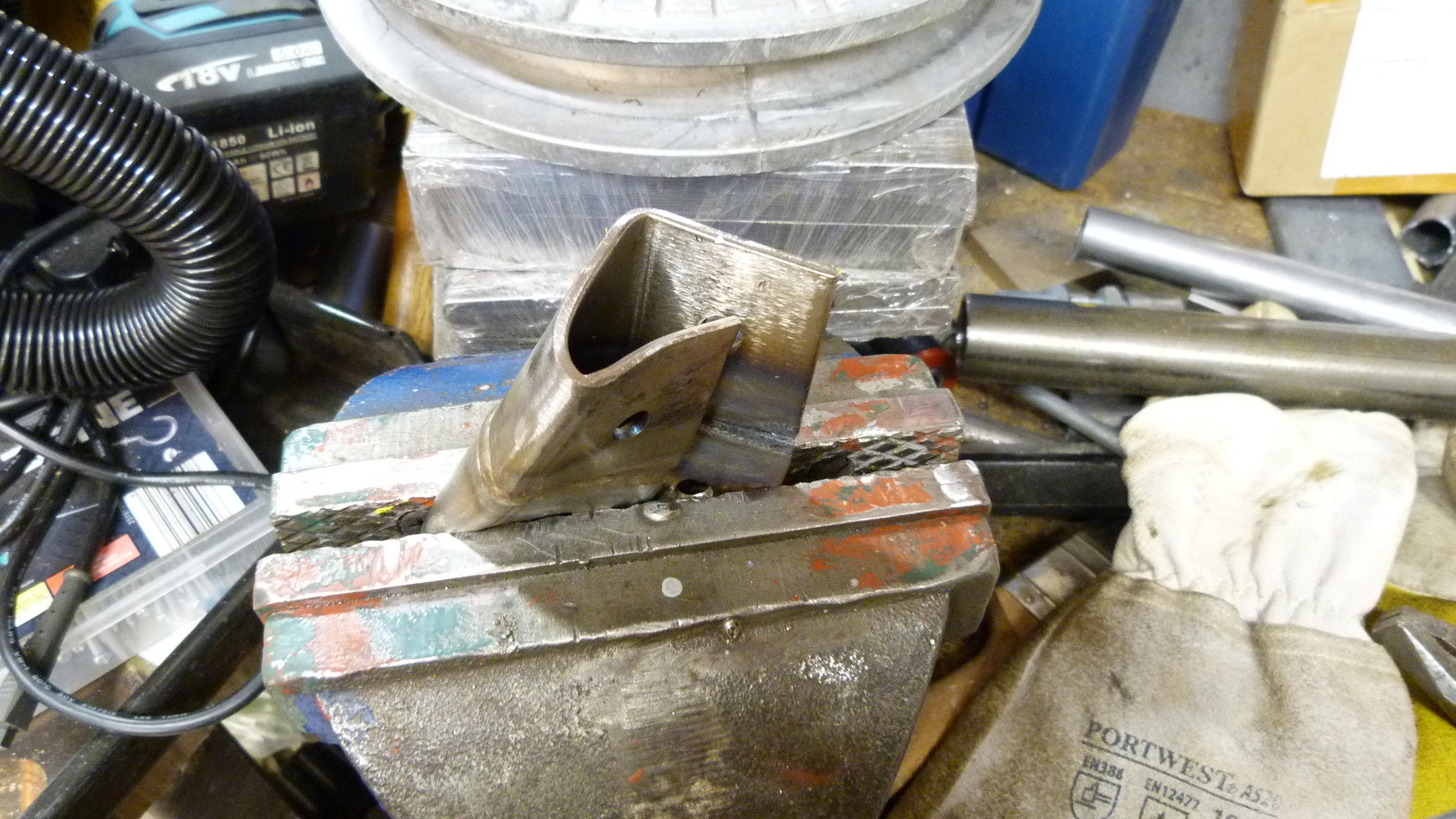

To conclude: I wont be brazing any suspension components like this. It is a handy technique to have I suppose. Good for stuff in a domestic environment that doesn't experience any great forces. It is very decorative too. If Aunty Mabel comes along asking if I "could just weld this broken heirloom" I will be brazing if for sure. It is very handy for one offs where you dont get a second chance or a practice run. The original material should be untouched underneath the braze. I won't be blowing through anything. I will definately consider this first with some exhaust builds of mine in future, Should save me cooking any stainless material or making a mess of thin walled tube
