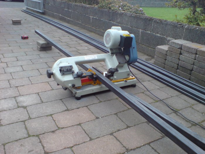

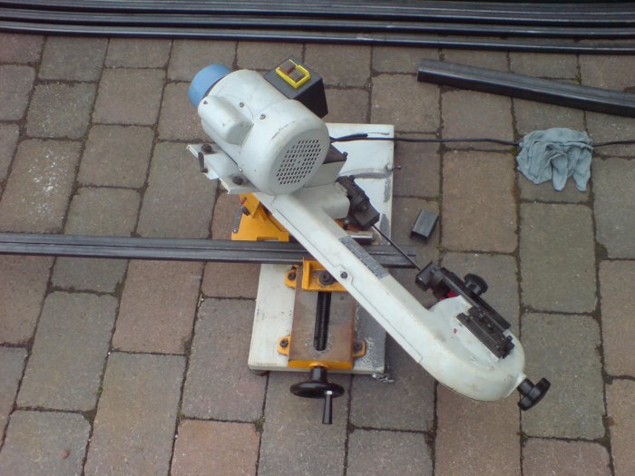

if you want a quieter machine get 1 of these
I had a abrasive cut off saw which was very noisy and the fumes off it were terrible so I got this bandsaw, it is quiet and gives a square cut, just get bi metal blades as they last longer.
Hey Sanny
What make is that band saw of yours ?
I have an Evolution 355, I think it is, TCT blade, goes through steel like soft butter, even if it sounds akin to a banshee screaming, not for long though it's so damn quick.
