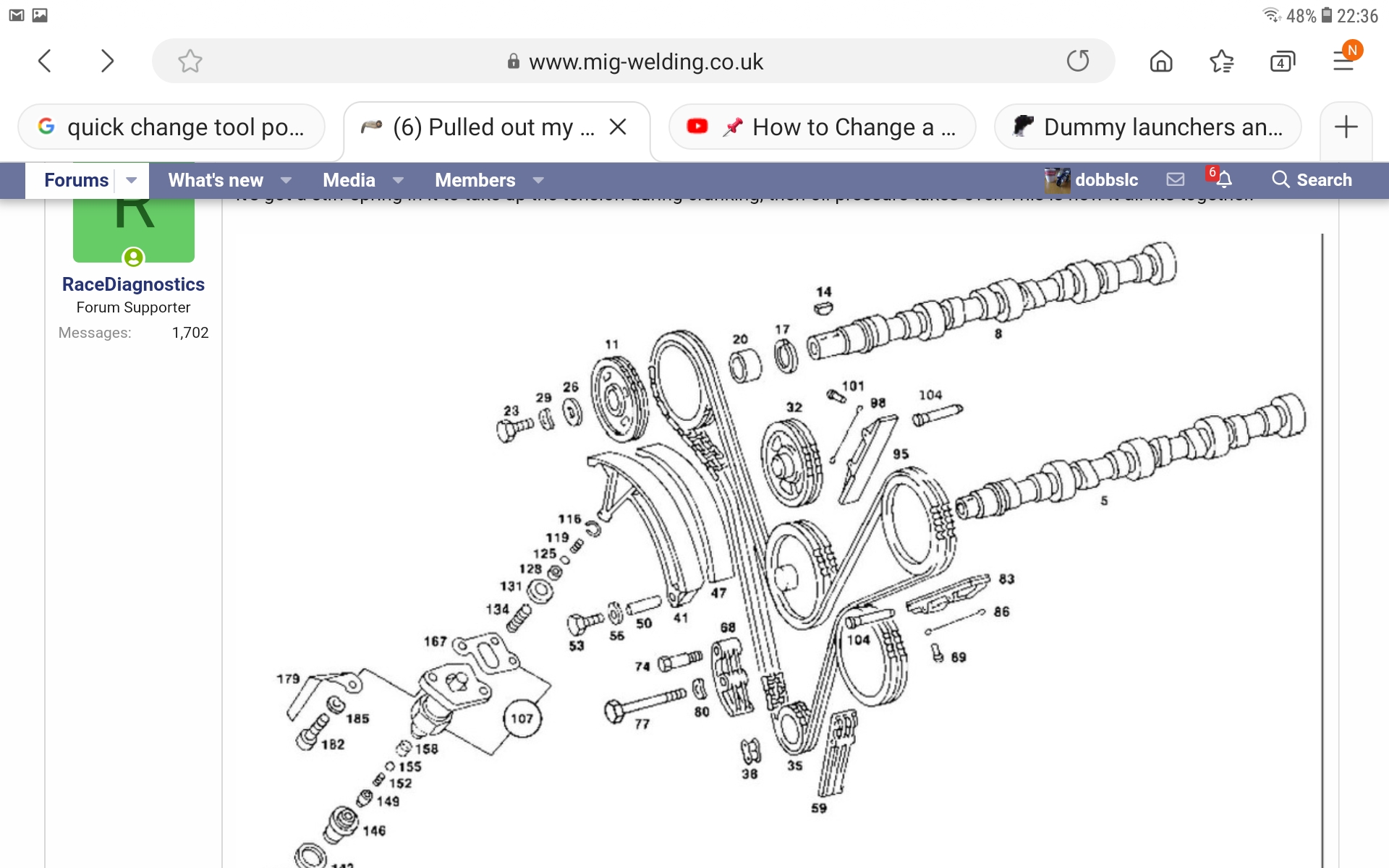

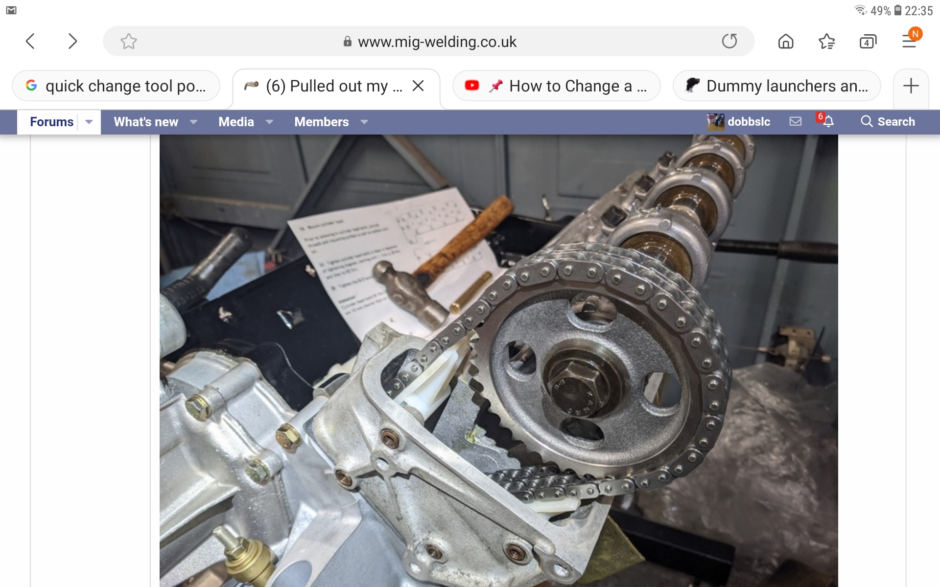

The lower tensioner with the curve , on incorrectly? It looks as if it is forcing the chain away from the sprocket , the chain shouldn’t put any strain on the guide like that, it’s likely to break
