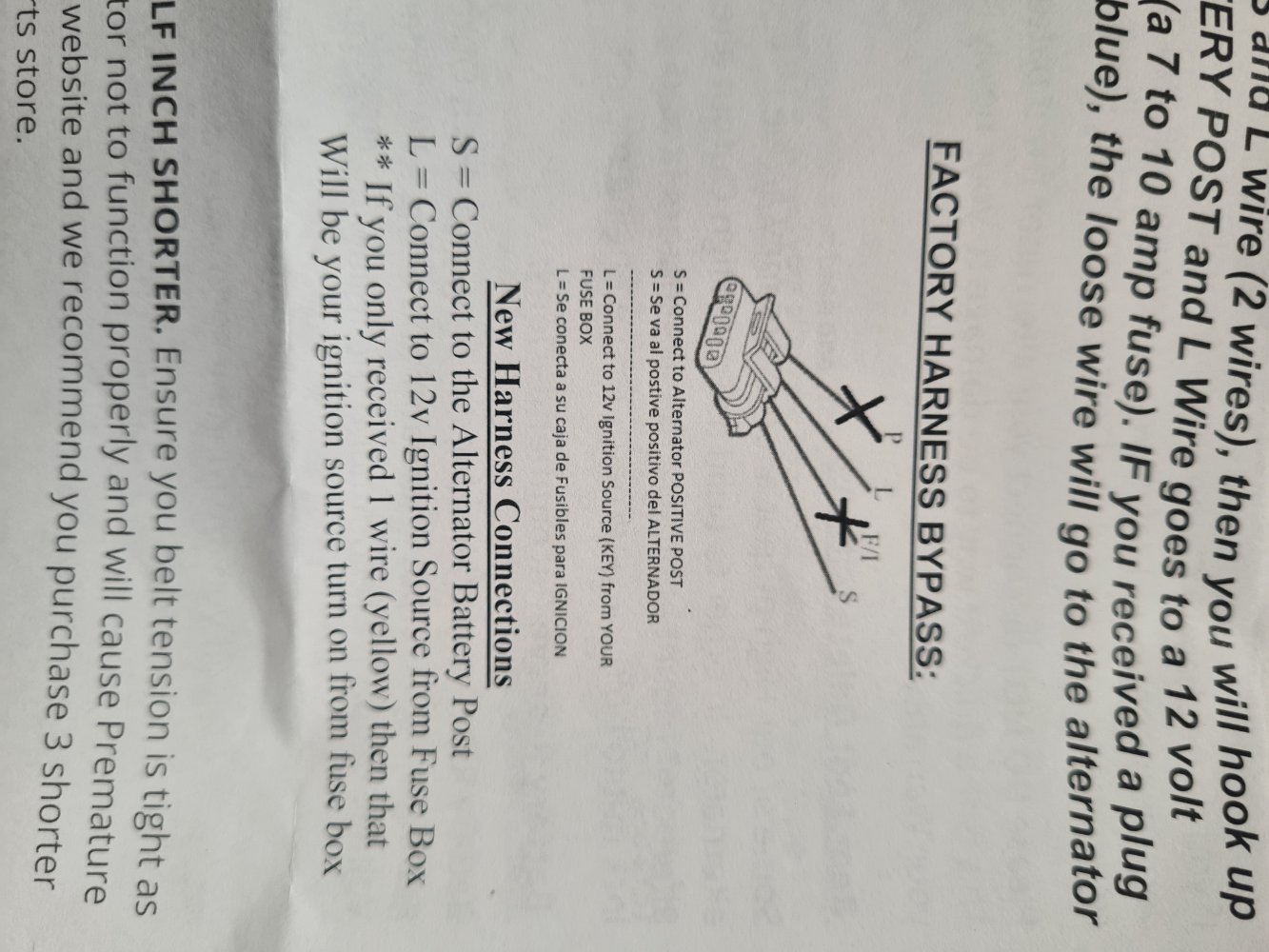

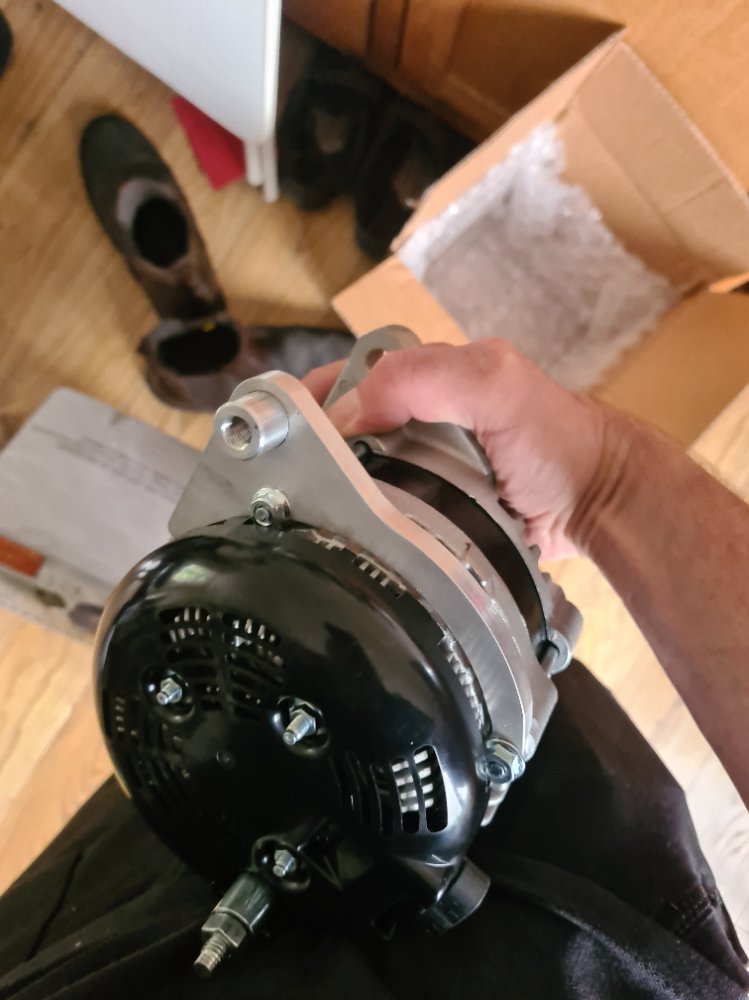

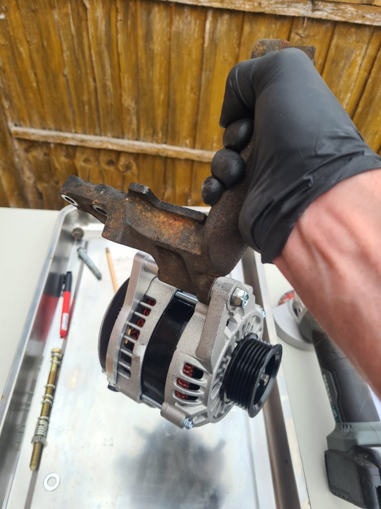

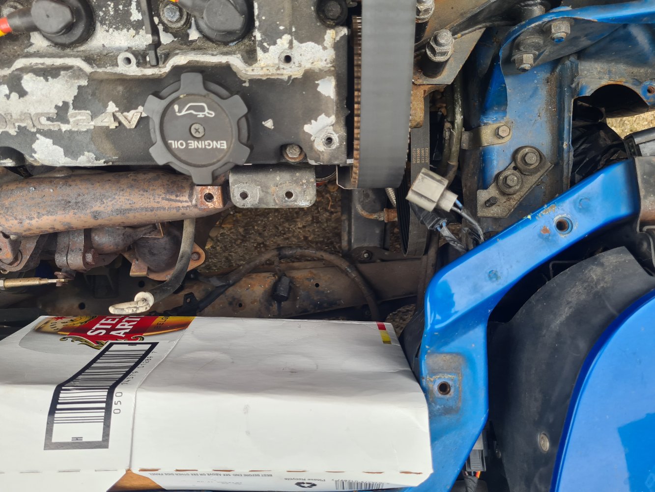

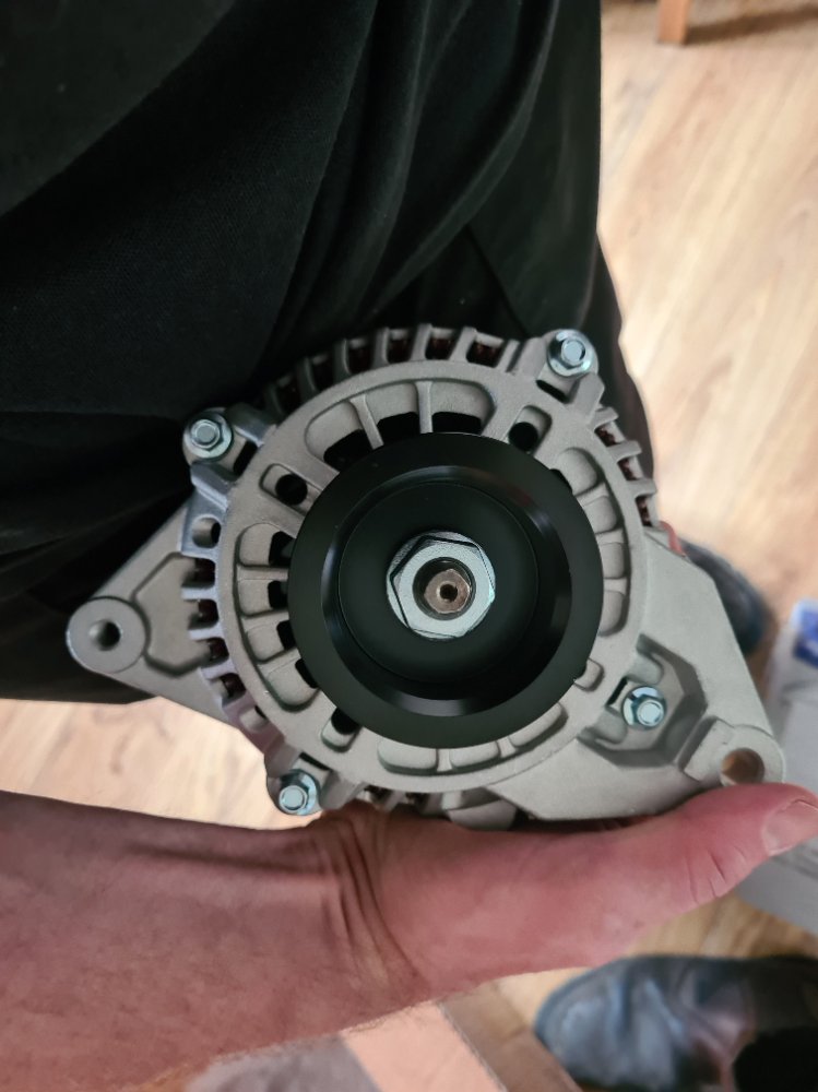

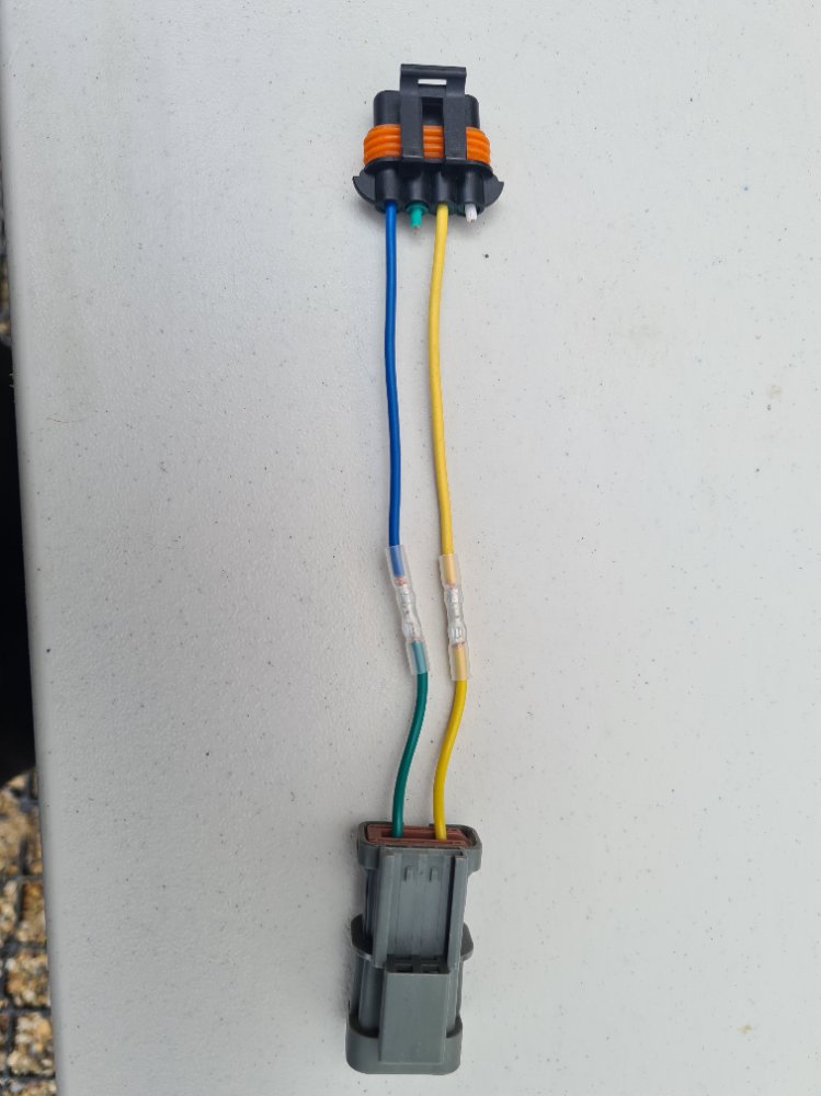

i did the diode mod to my VW T4
Weird! Would be a Bosch one as standard, thick red B+ and blue +61.
Please explain in more detail. Like saying. You stood in a bucket, pulled the handle and you floated 2’ in the air.
