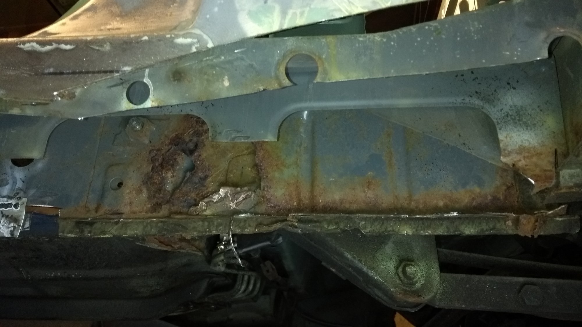

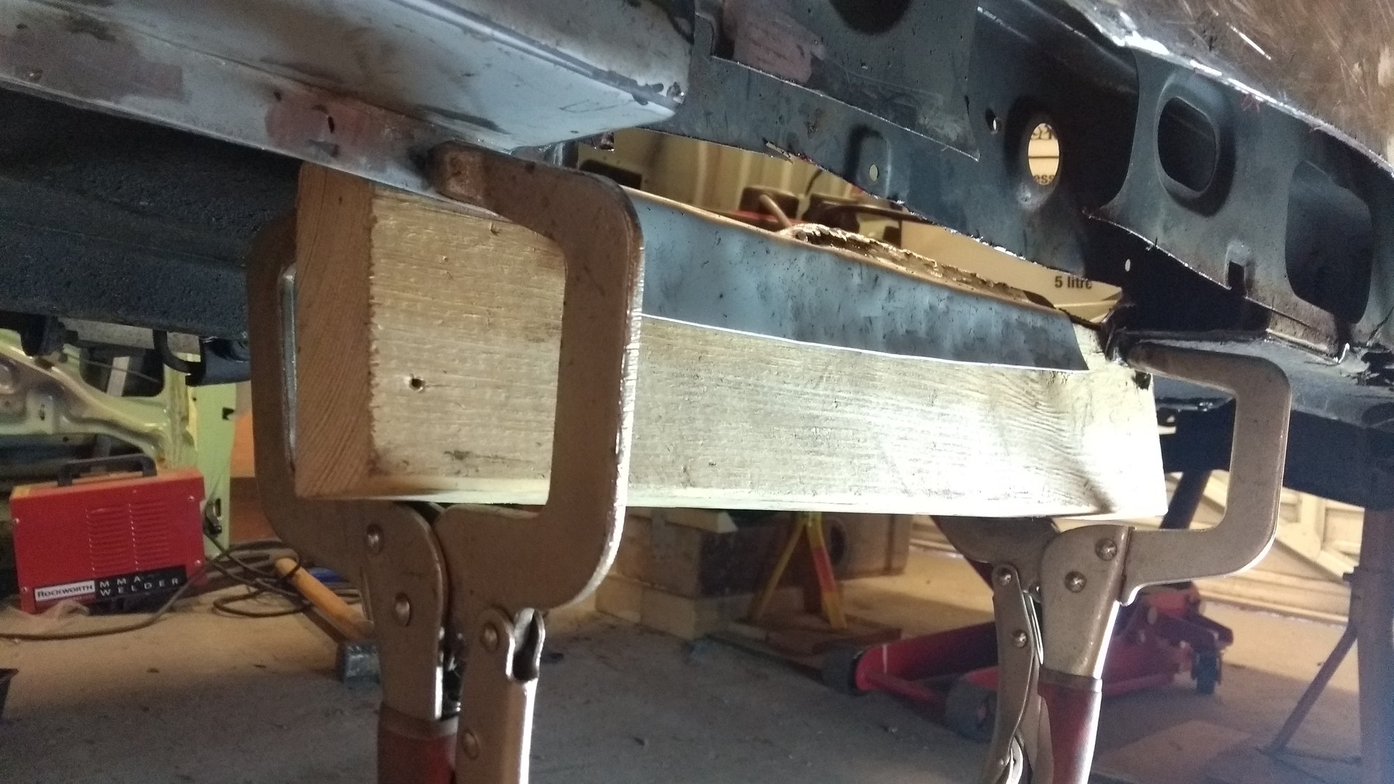

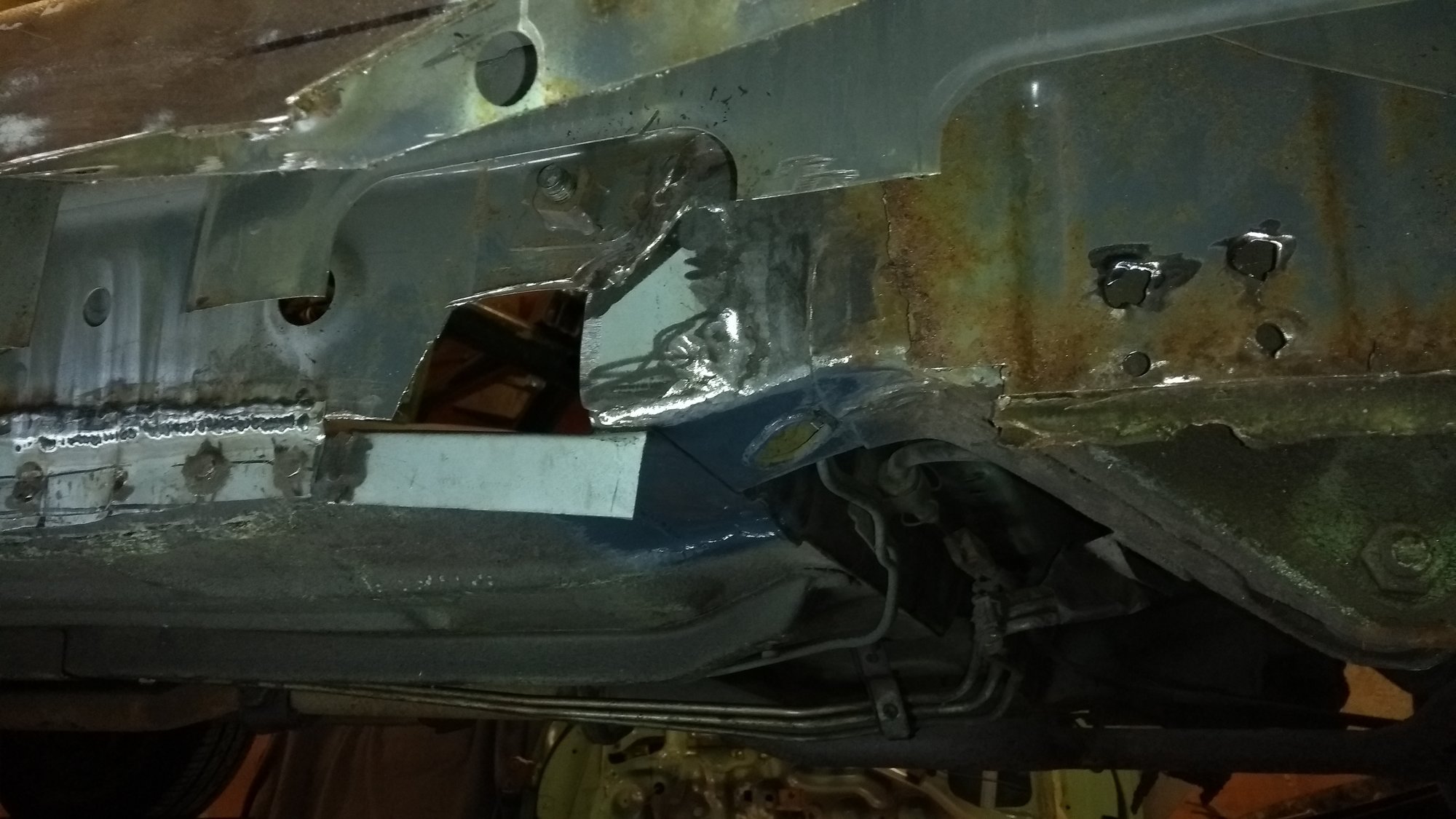

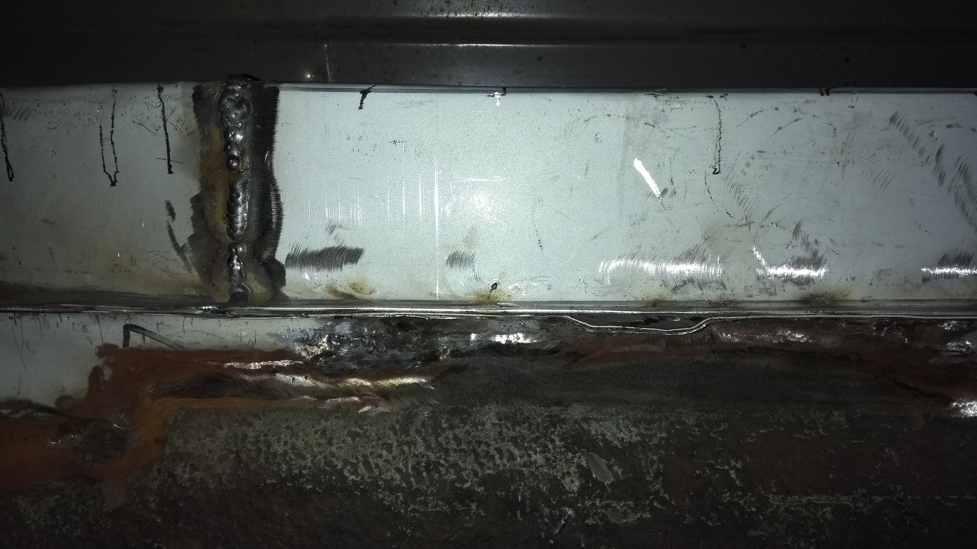

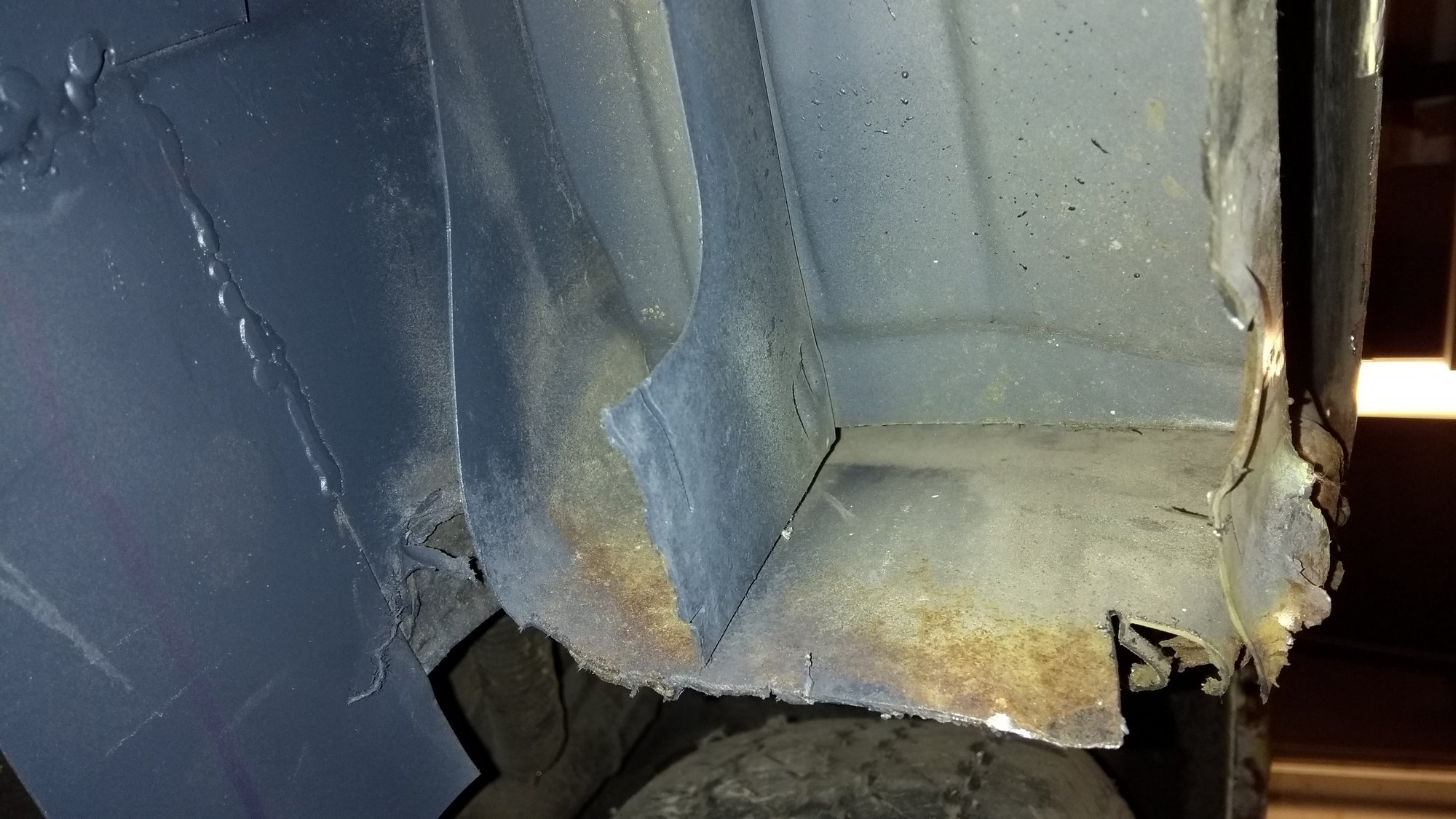

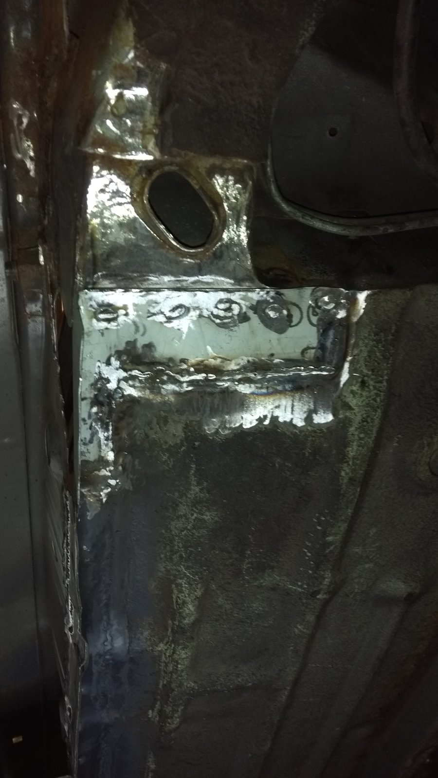

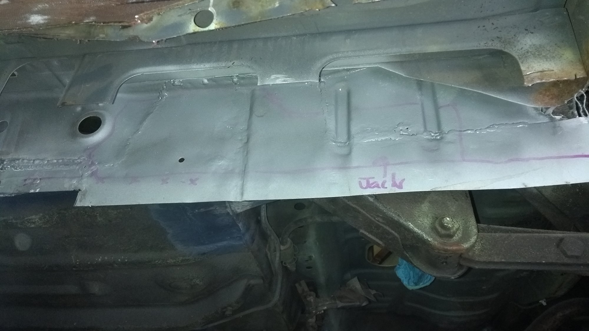

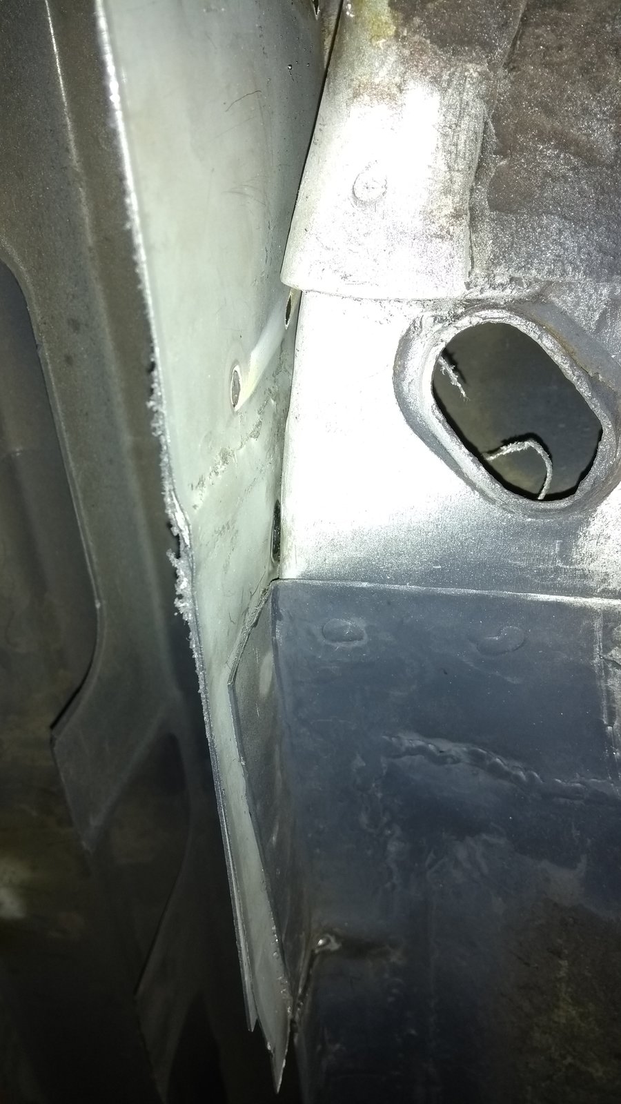

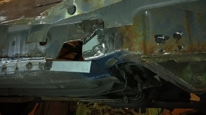

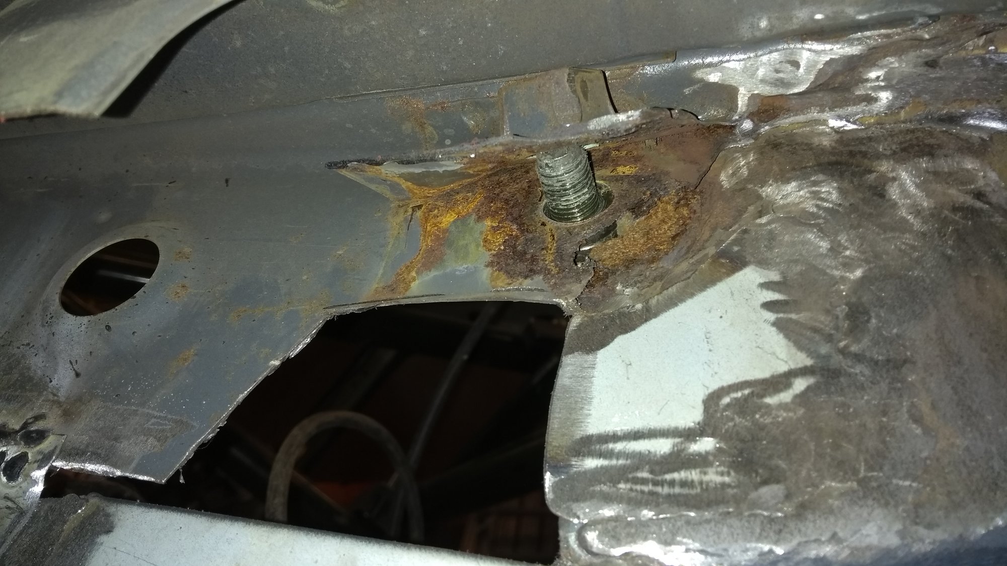

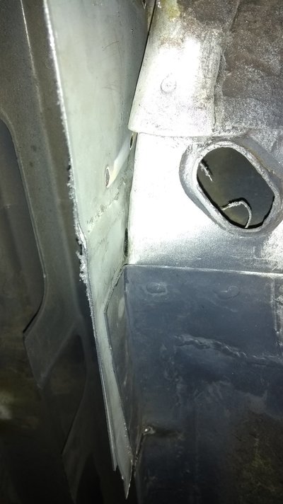

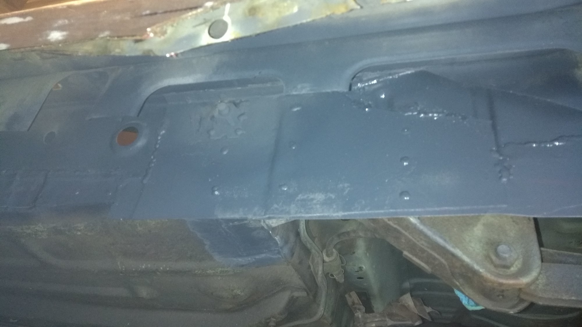

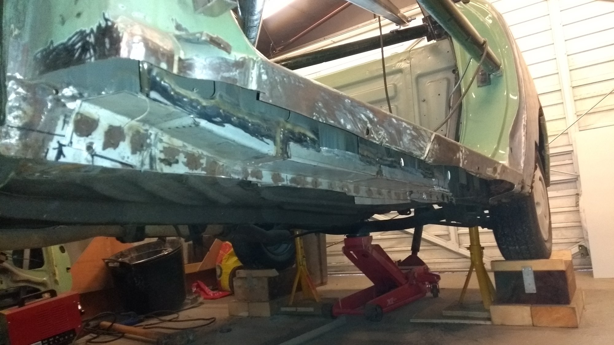

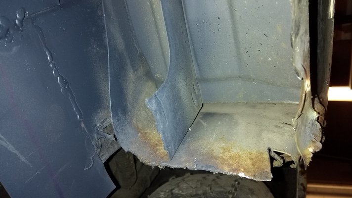

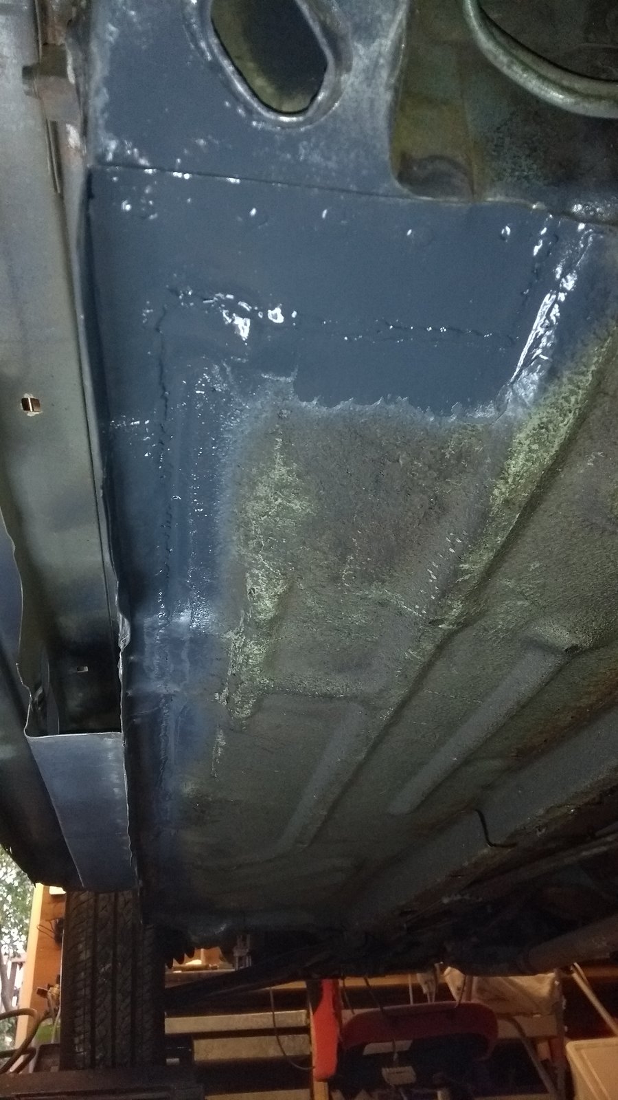

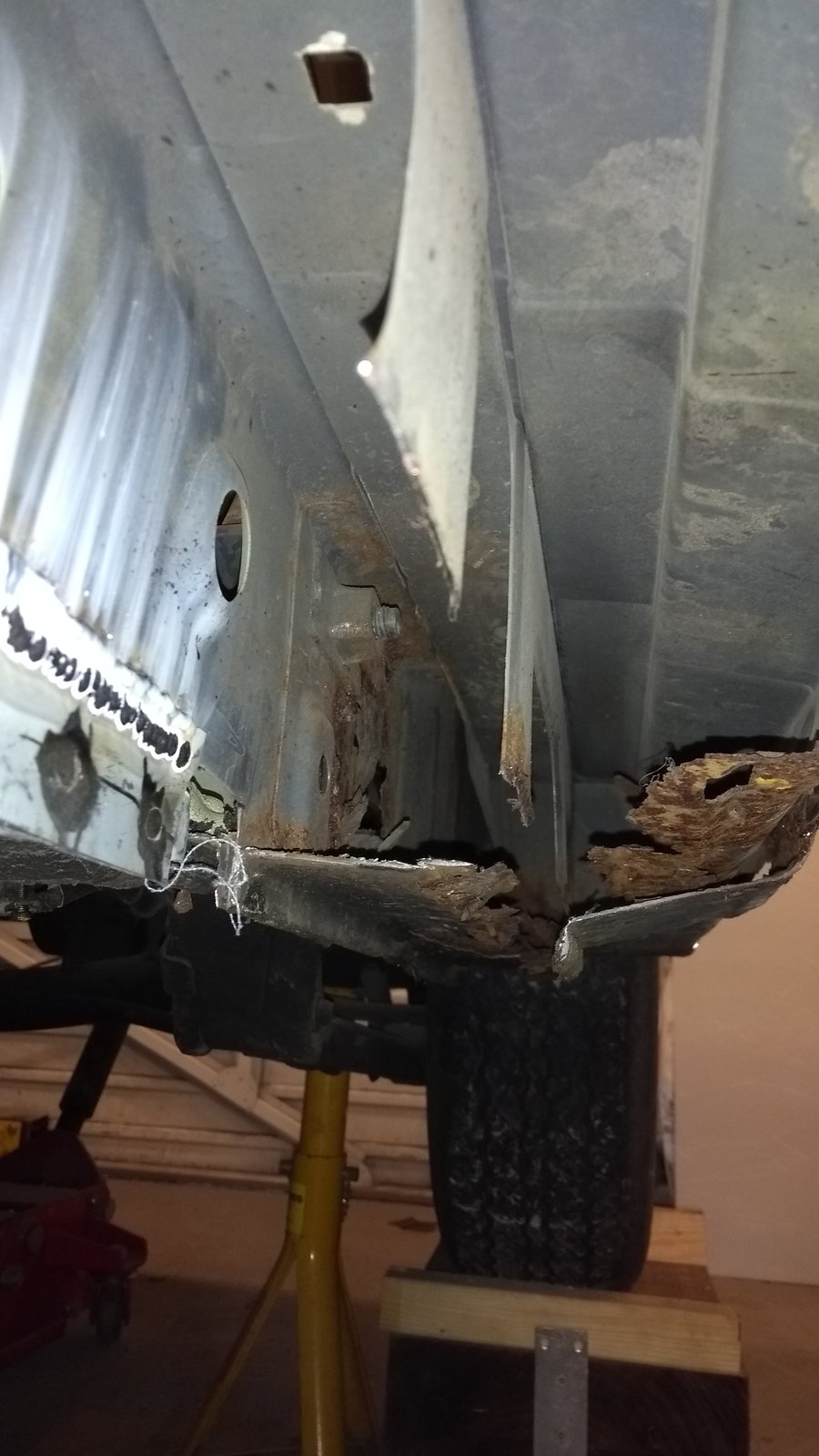

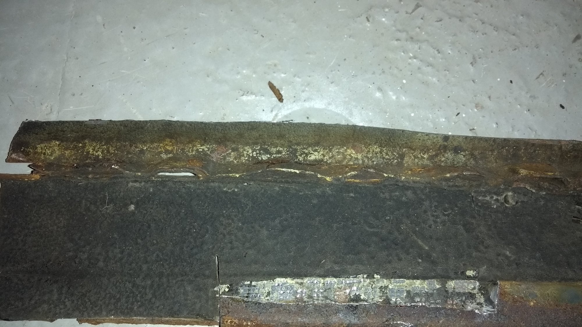

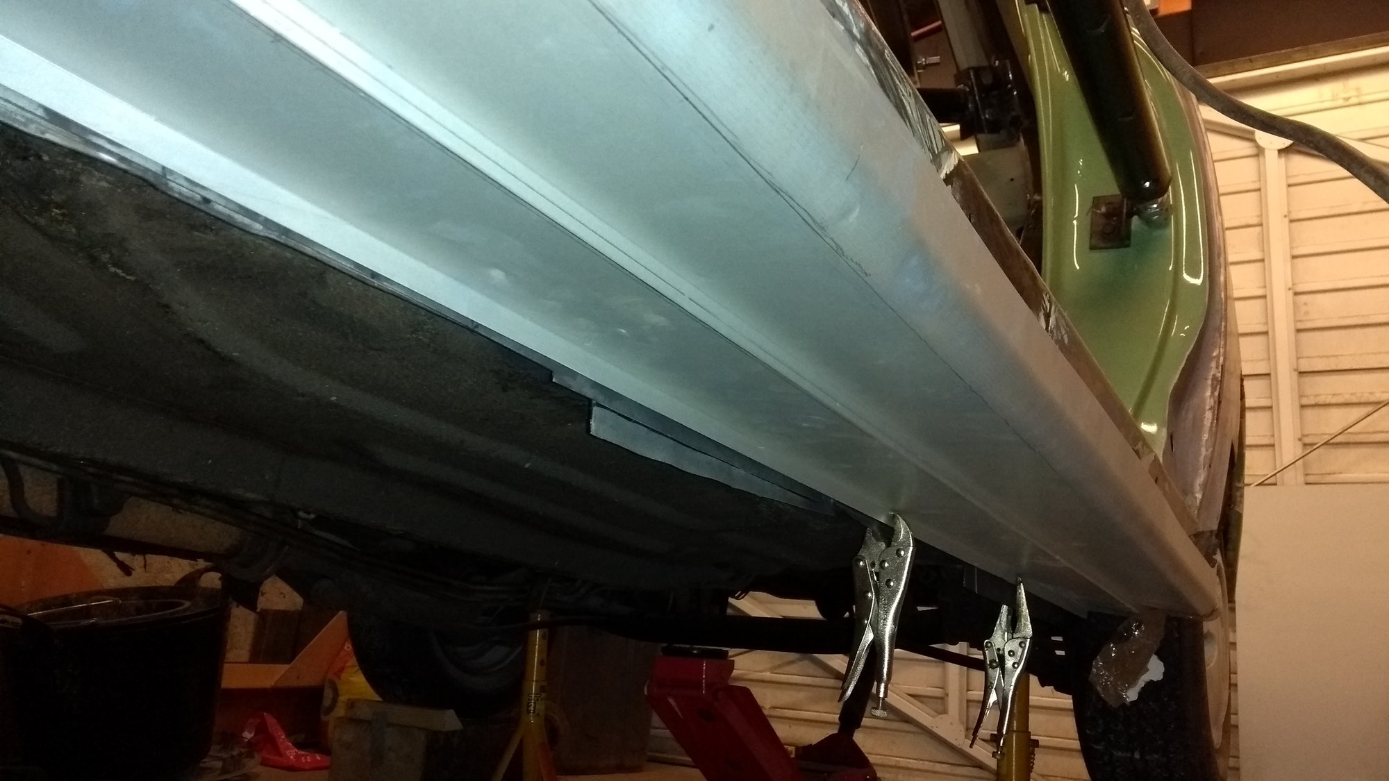

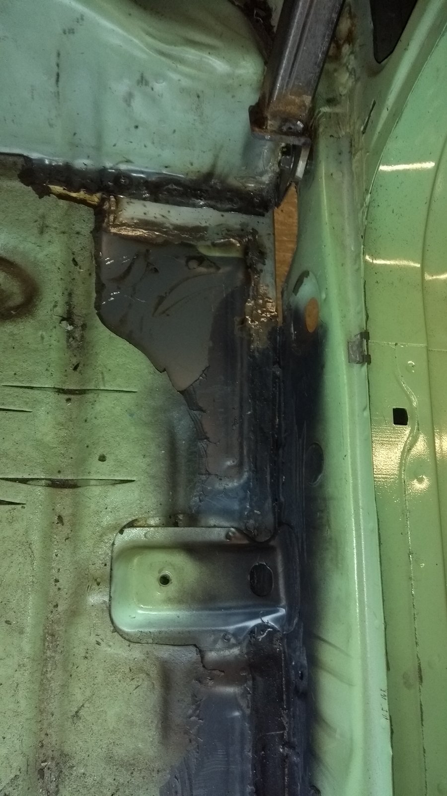

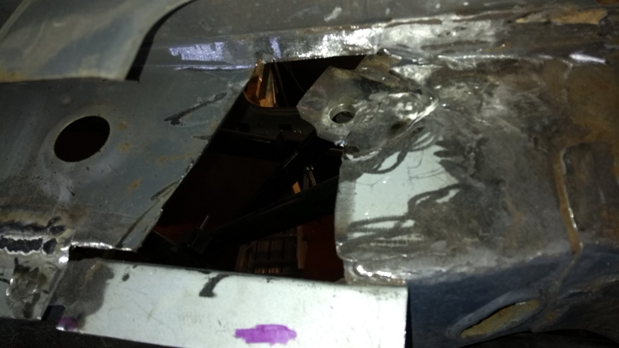

Then rinse and repeat (if only it were that easy!)...I'm trying out a new way of fixing the floor....the idea is to get the floor welding done then bend the lower lip in situ....seems to have worked....needs fettling of course. The butt welding of the floor is a royal faff...perhaps I should have lap welded instead....grrrr. On this piece I rushed the template and just didn't get the gap set right...resulting in poor penetration in places....resulting in me under the car welding on my back from the underneath....which I really really dislike!
