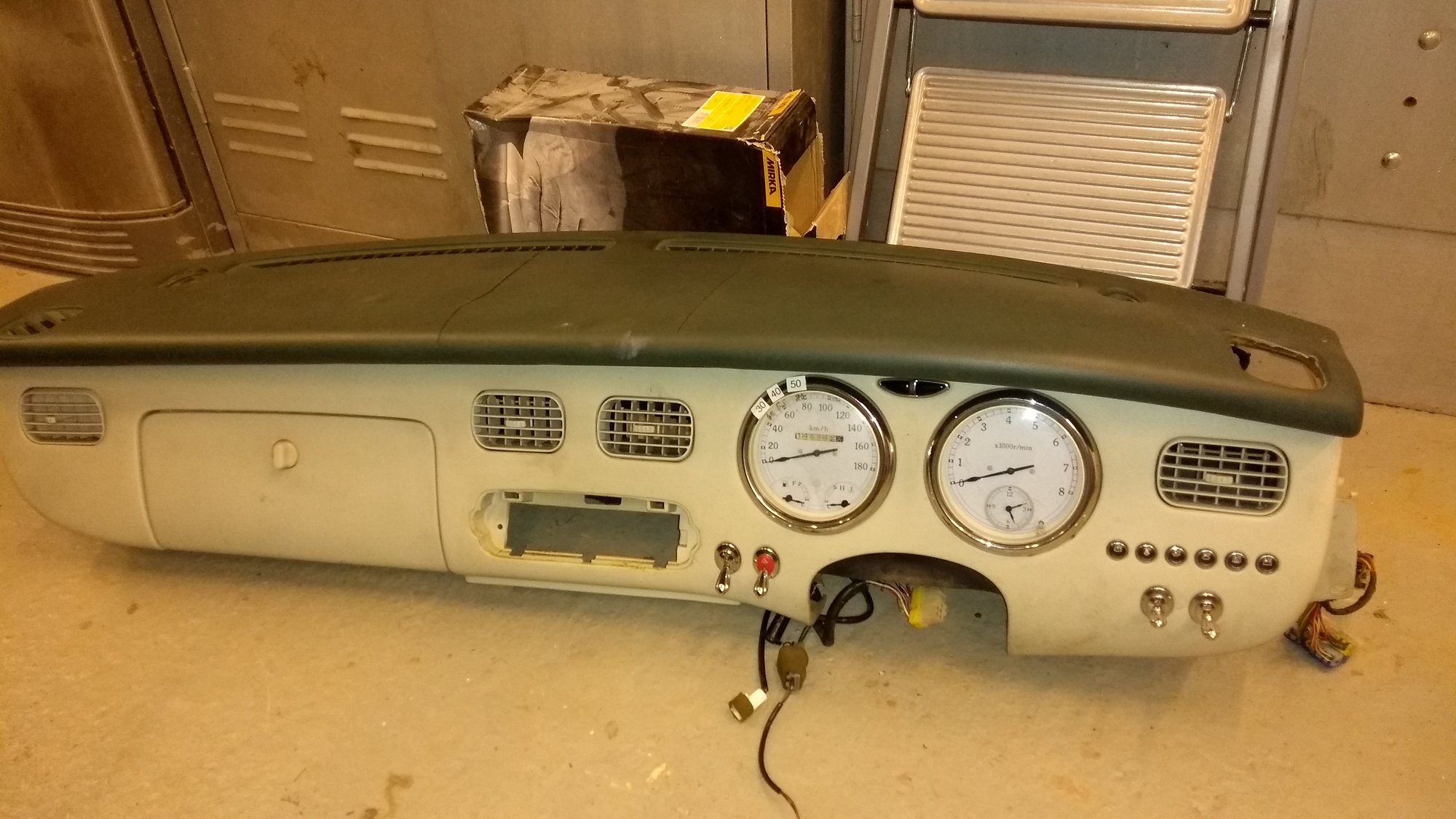

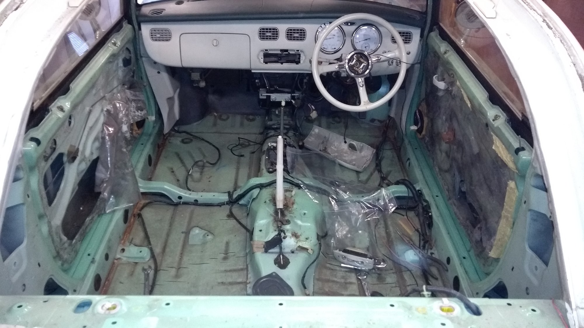

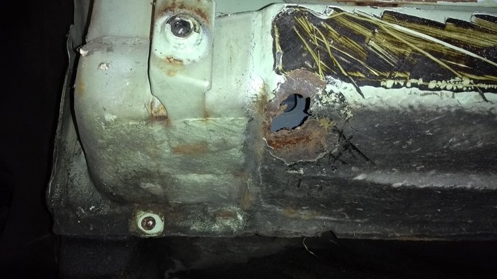

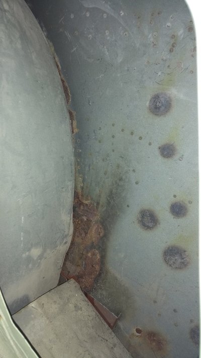

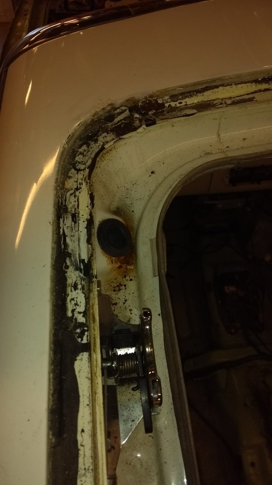

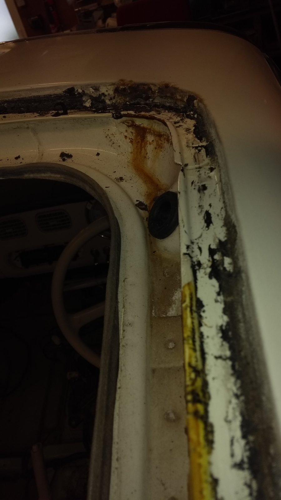

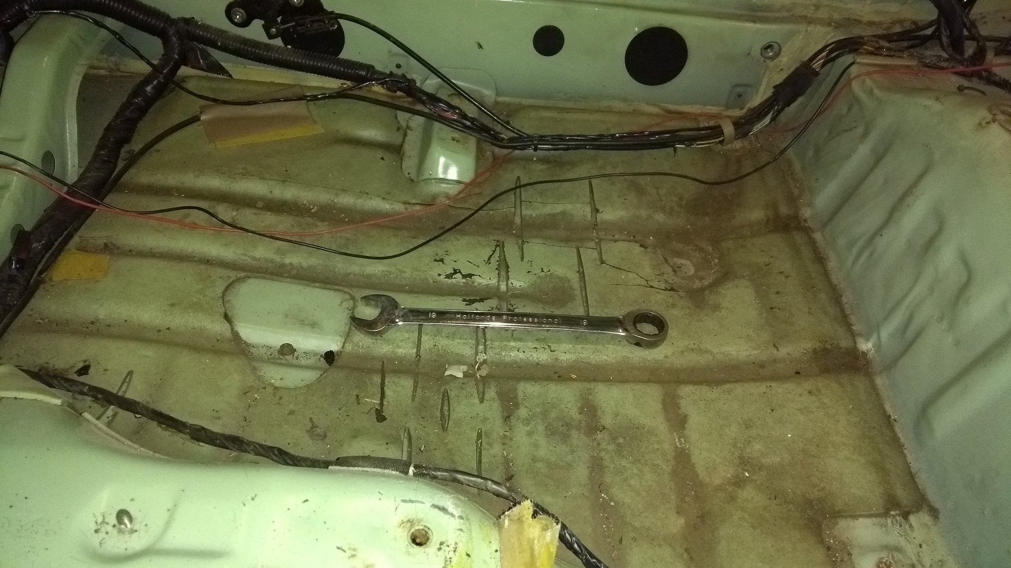

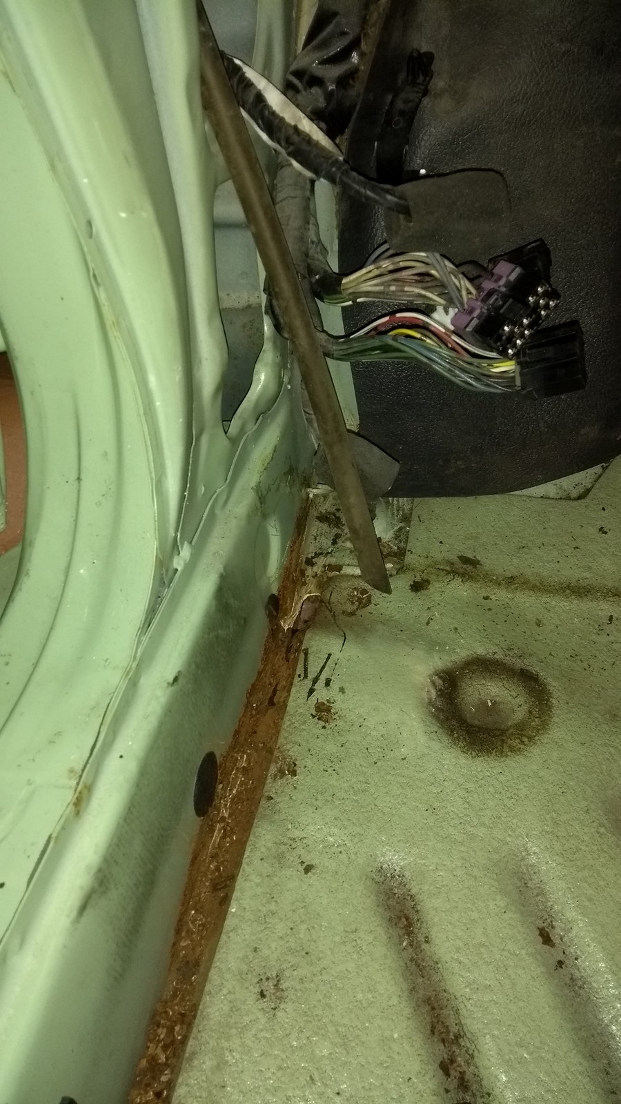

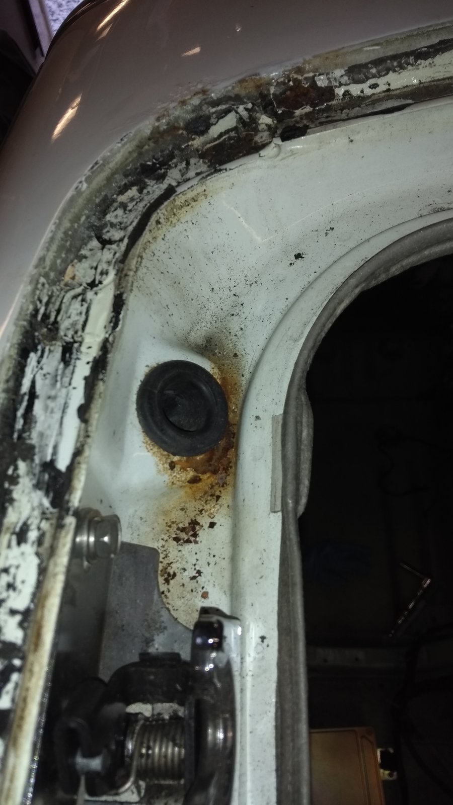

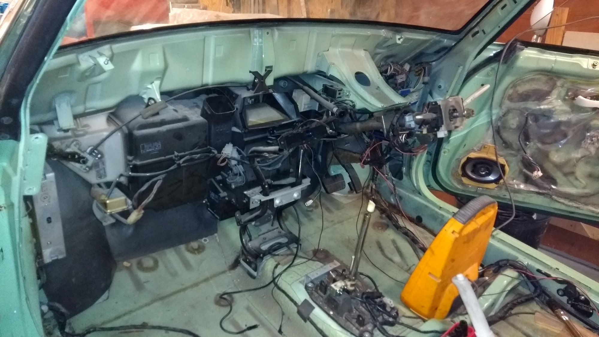

Next up was removing the plastics....I've managed to remove most of the plastics from inside the car except the dash. I also very carefully removed the roof seal...and I mean very carefully!! Easiest way to do it is with a small chisel and take your time. The roof seal wraps around the roof and the rear of the car....I can't imagine it's cheap if available at all!! Mine came off in one piece and is good condition. Figaros rust in the roof channels....this one isn't too bad but will need a little welding to sort. I imagine this would be difficult to fix without removing the interior plastics!
