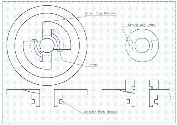

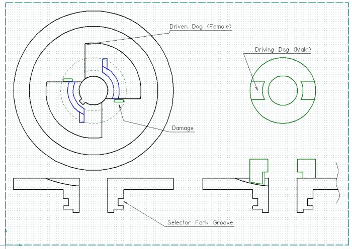

Would it be possible to build up the damaged area with a hard facing rod and then re-grind it I wonder?

I've not got it (the gear) back yet, they're charging me £20 to fill and hard-face the damaged bits. Then I've got to grind it back to size.
