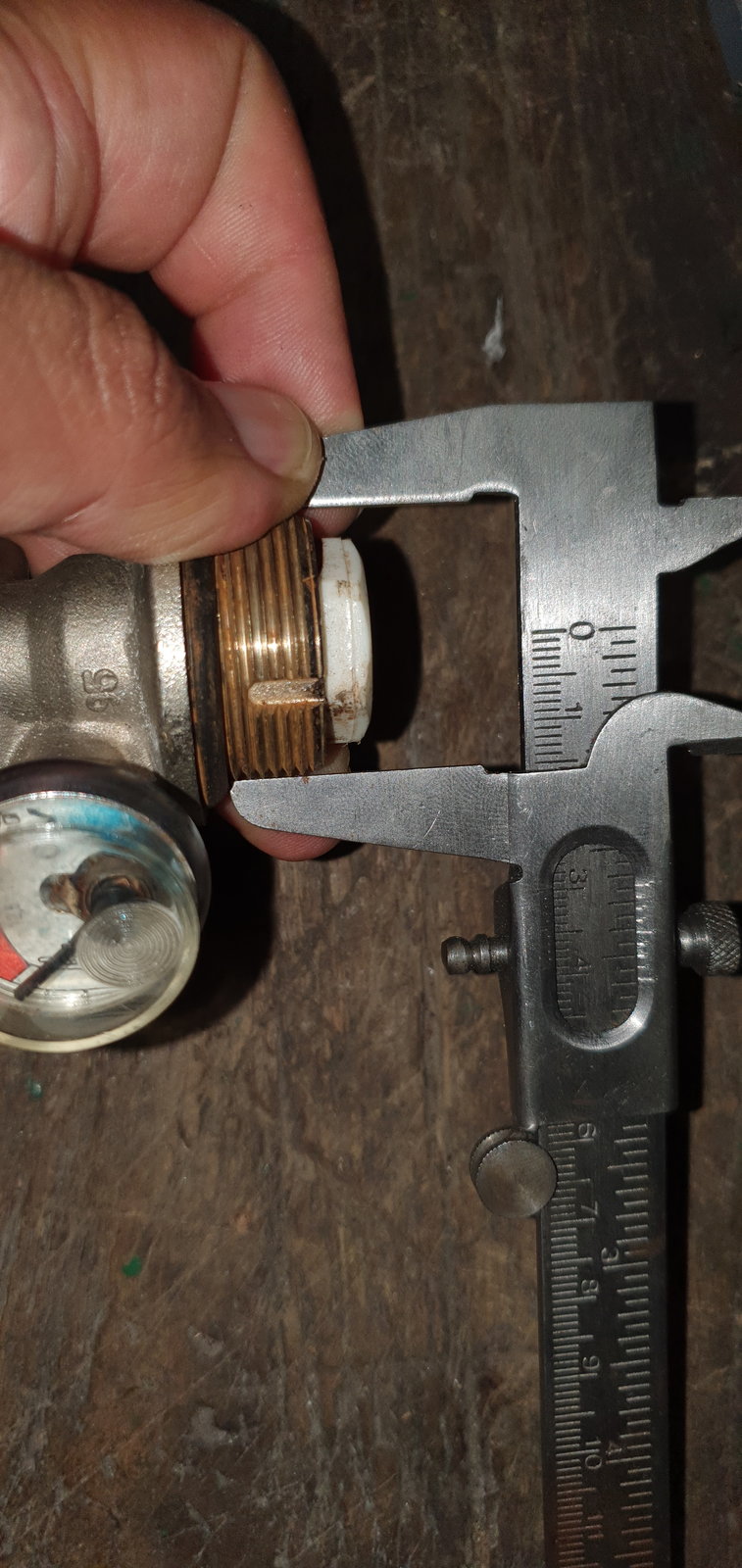

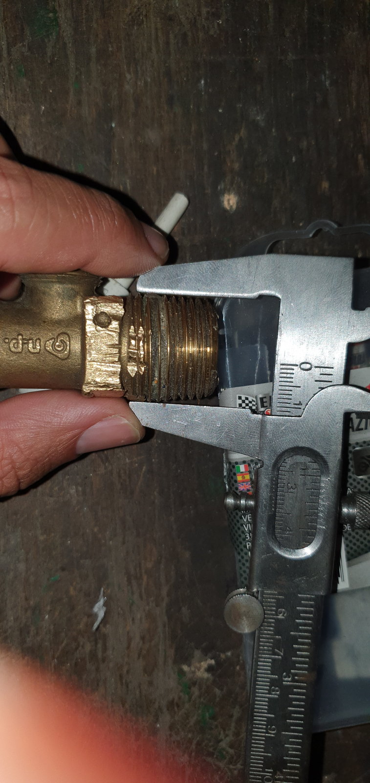

grazie mille provero ad andare a bricomanFirst advice throw away that caliper
It's hard to read because its cheap construction ,I used to have one of this but during technical school I've had to understand that's pointless , measurement instruments has to enough good because it's the base for every work and project .
It seems to be ¾" or even a metric thread , you'll probably have a tap and die set from Lidl like I do .
There's a thread pitch tool , which will say you the right thread
The thread seems to be not tapered so I'd exclude NPT
Strange but at least it's right hand so wouldn't be difficult to find
Give me few minutes I'll search if we can figure out the exact thread pitch and if we can find a correct nipple on eBay
Edit the gpl tank or maybe better say LPG since we are in this foreign forum is surely ¾" right hand so you should easily find it
Buy both NPT and BSPT on eBay
The other one is from the co2 fire extinguisher and it's surely an M30
i have tap and die set of parksideFirst advice throw away that caliper

It would be helpful for the co2 bottlei have tap and die set of parkside
but i dont know if the are npt or bsp
and i dont know which one to use for 1/4 or 3/8 .... i didn't study this stuff
on the manuale they show hmjusy measurment are different .......
