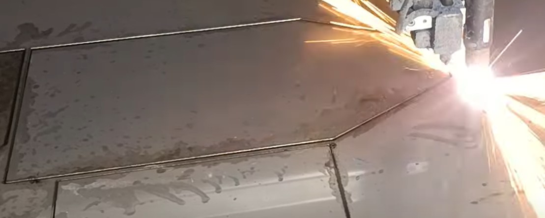

If you are going to do it with plasma partially bung one end and a hose in the other so you can fill with water but still have a flow, the cut will then have a nice golden edge to it, see pic below of the edge cut on my plasma with the water table.

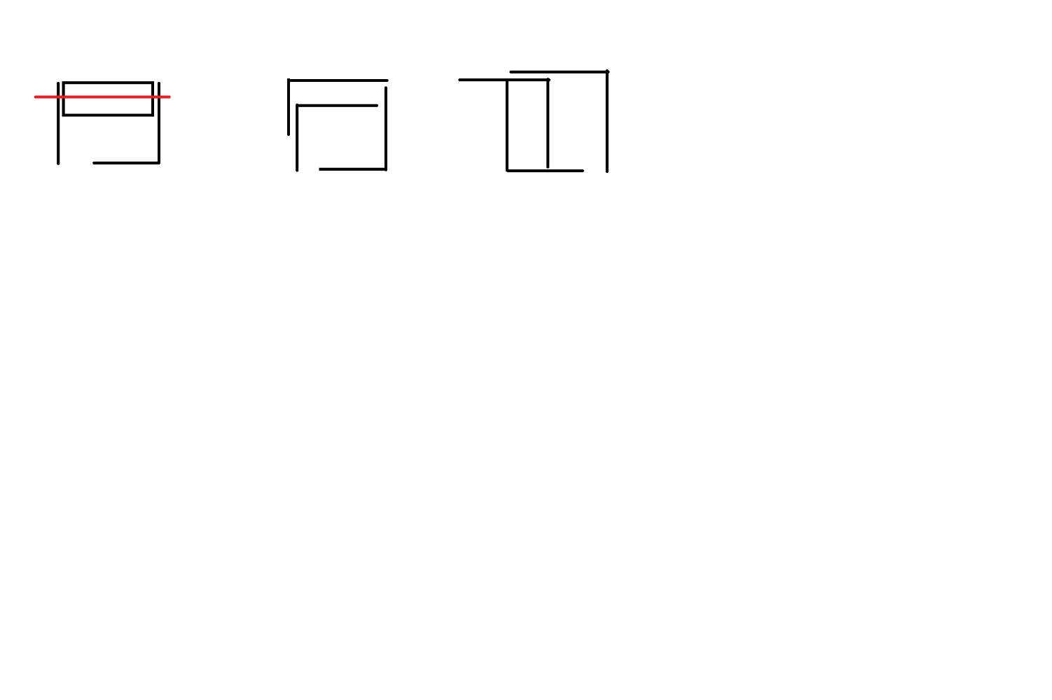

As has been said though, it will spring and bend and not be a slotted box any more. That may or may not matter depending on the use.
