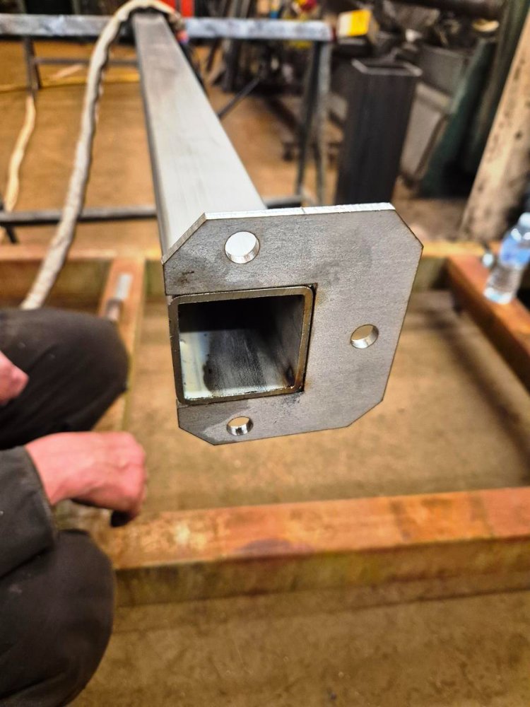

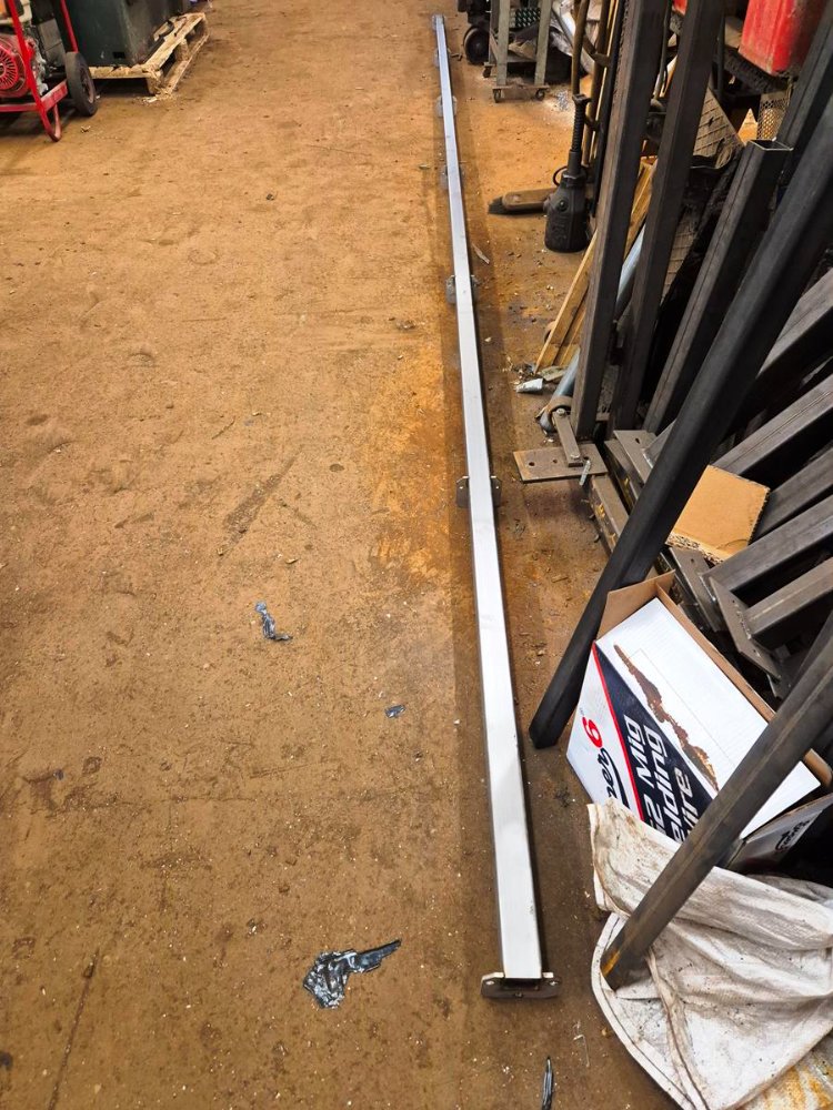

I know this is opening a can of worms but here we go. Material is 304 stainless 50mm x 50mm box 3mm wall, 6m lengths x 6off. We need to put a 12mm slot up one side and welcome suggestions as to how to tackle this.
Welded a couple of brackets on one anticipating it will try to spread but I appreciate this may close the door on a few options. My pal originally thought 1mm slitting disk but we are going to need a few to do 6m lengths especially 6off and it will take forever. I was thinking the plasma? anyhow, suggestions welcome:

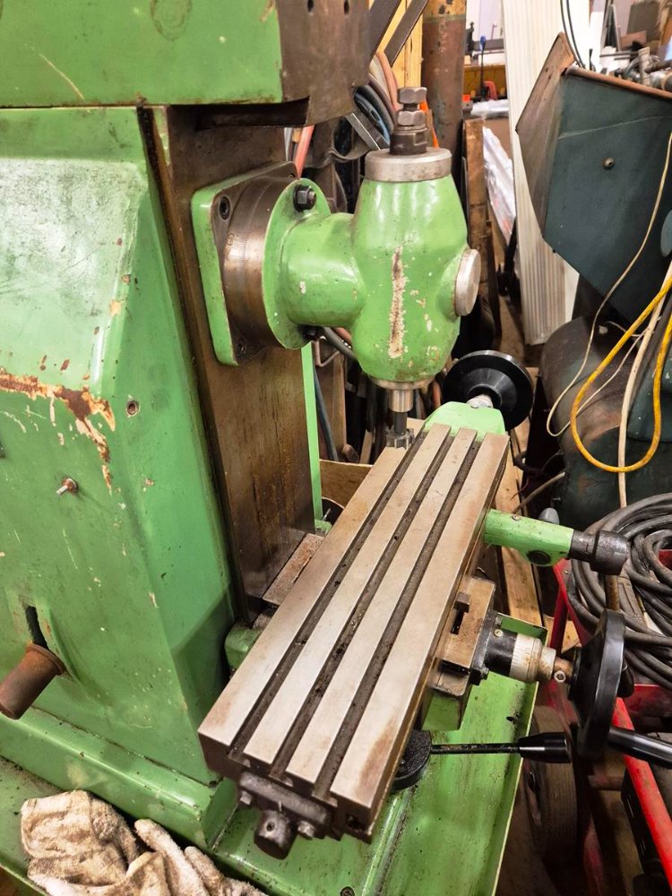

I did think a keyway cutter on the little mill? Going to be bloody tedious that.

(mark a centerline + 5mm either side. 2 x 1mm cuts + 10mm center strip = 12mm slot).
