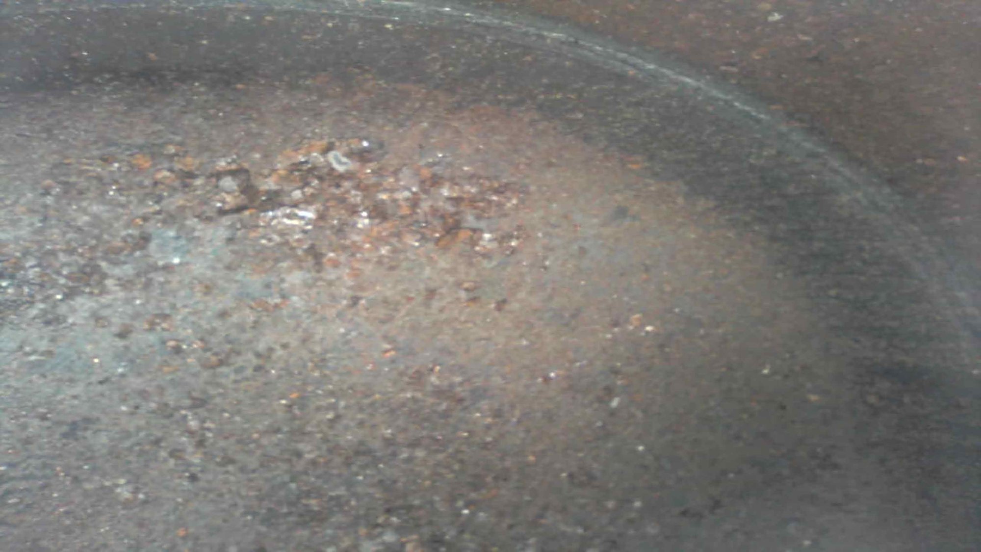

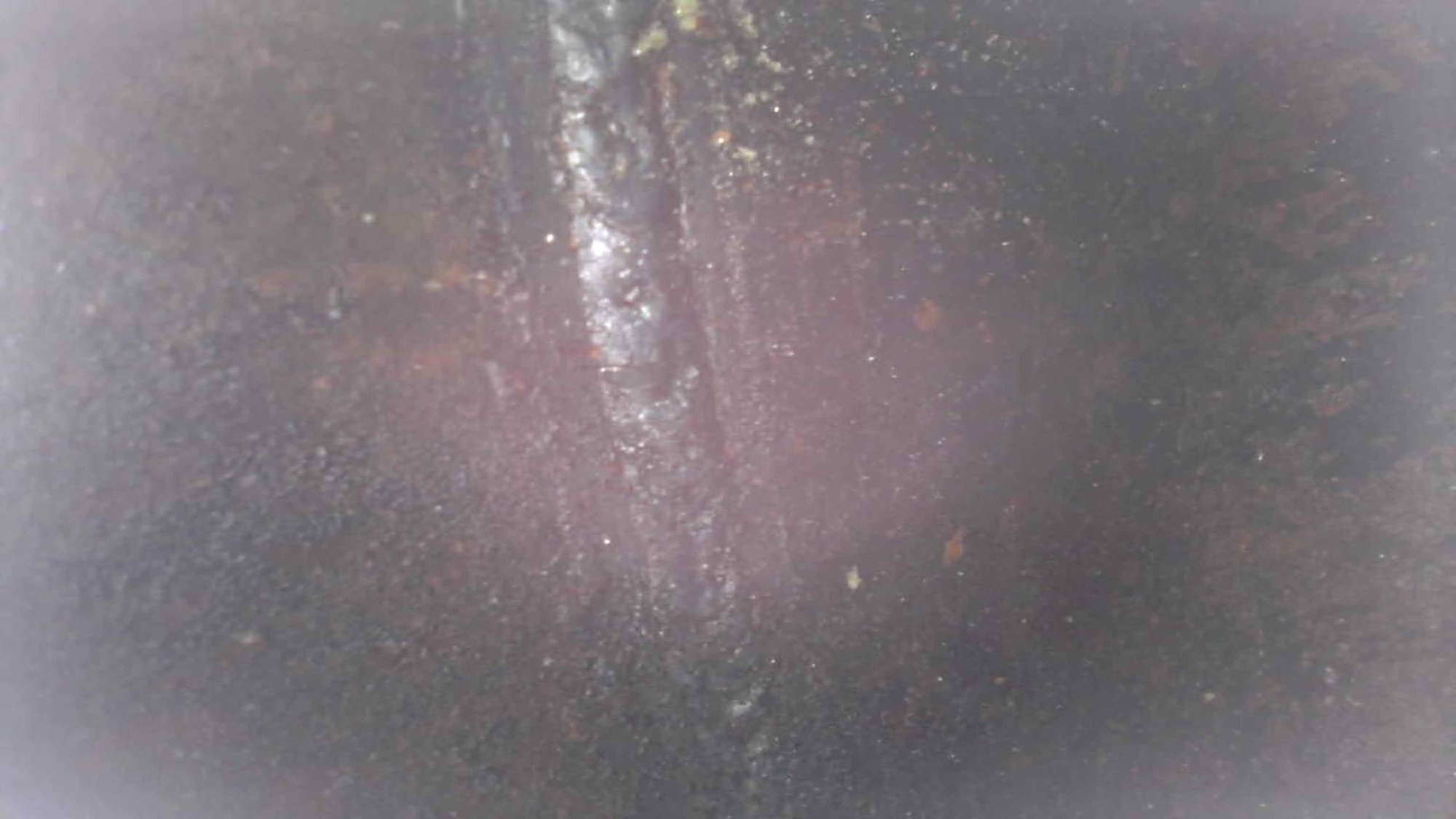

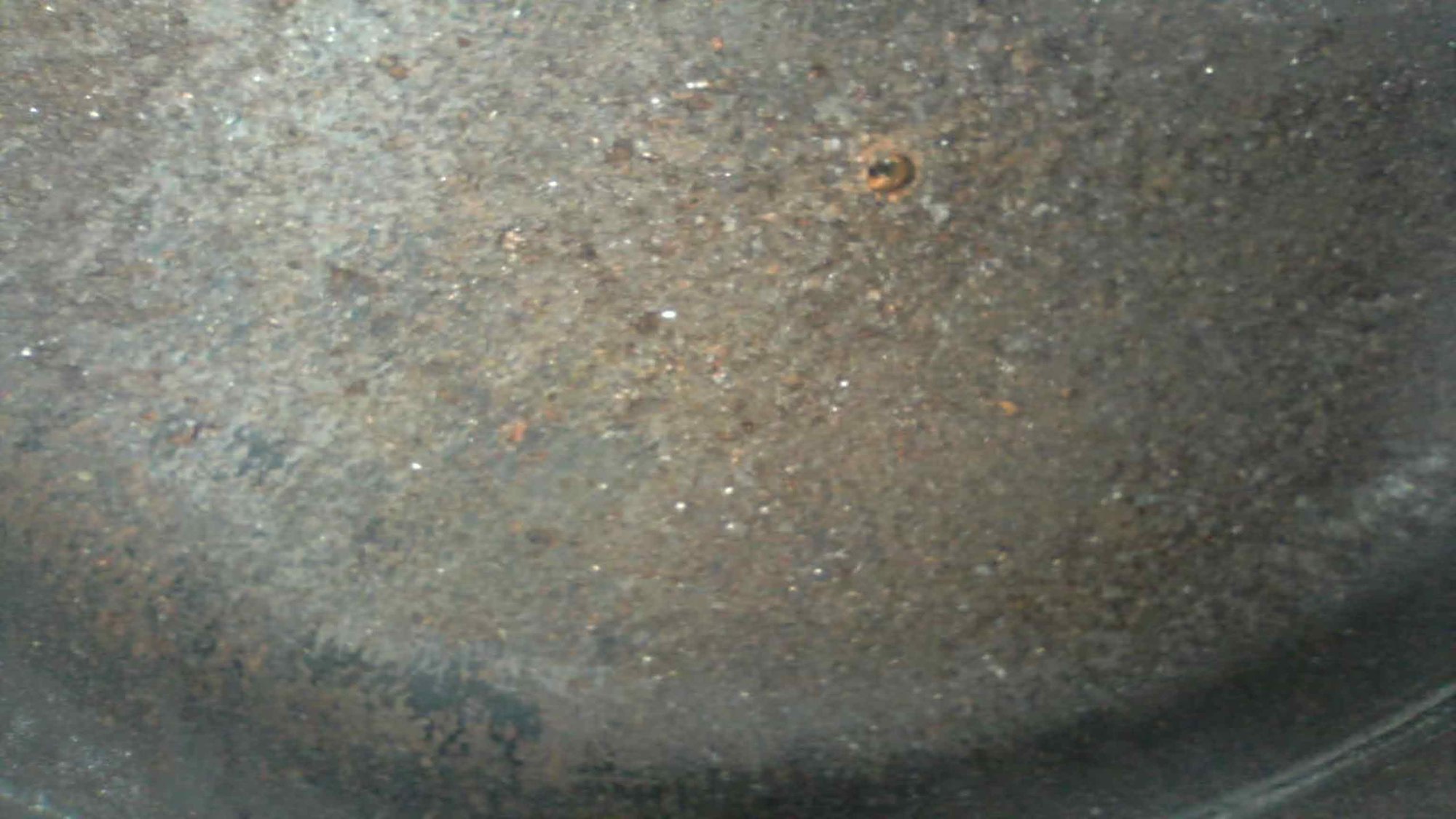

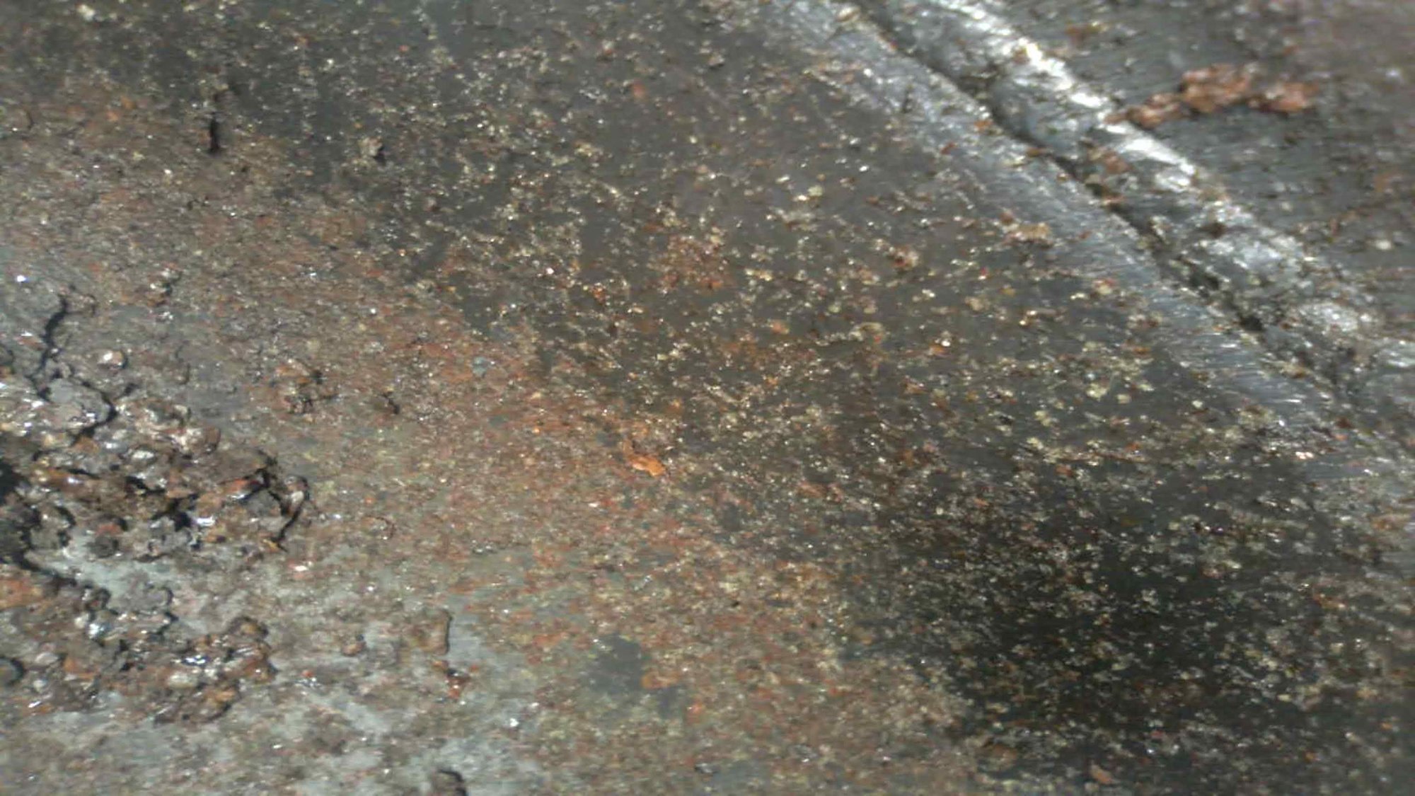

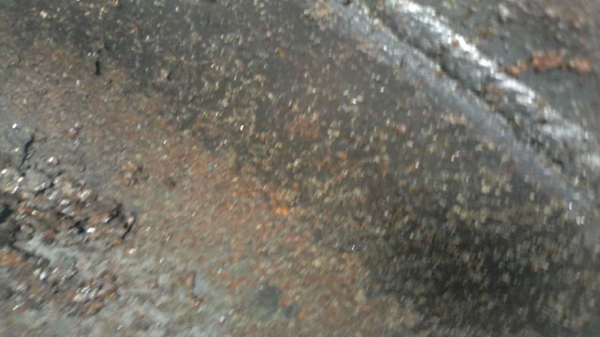

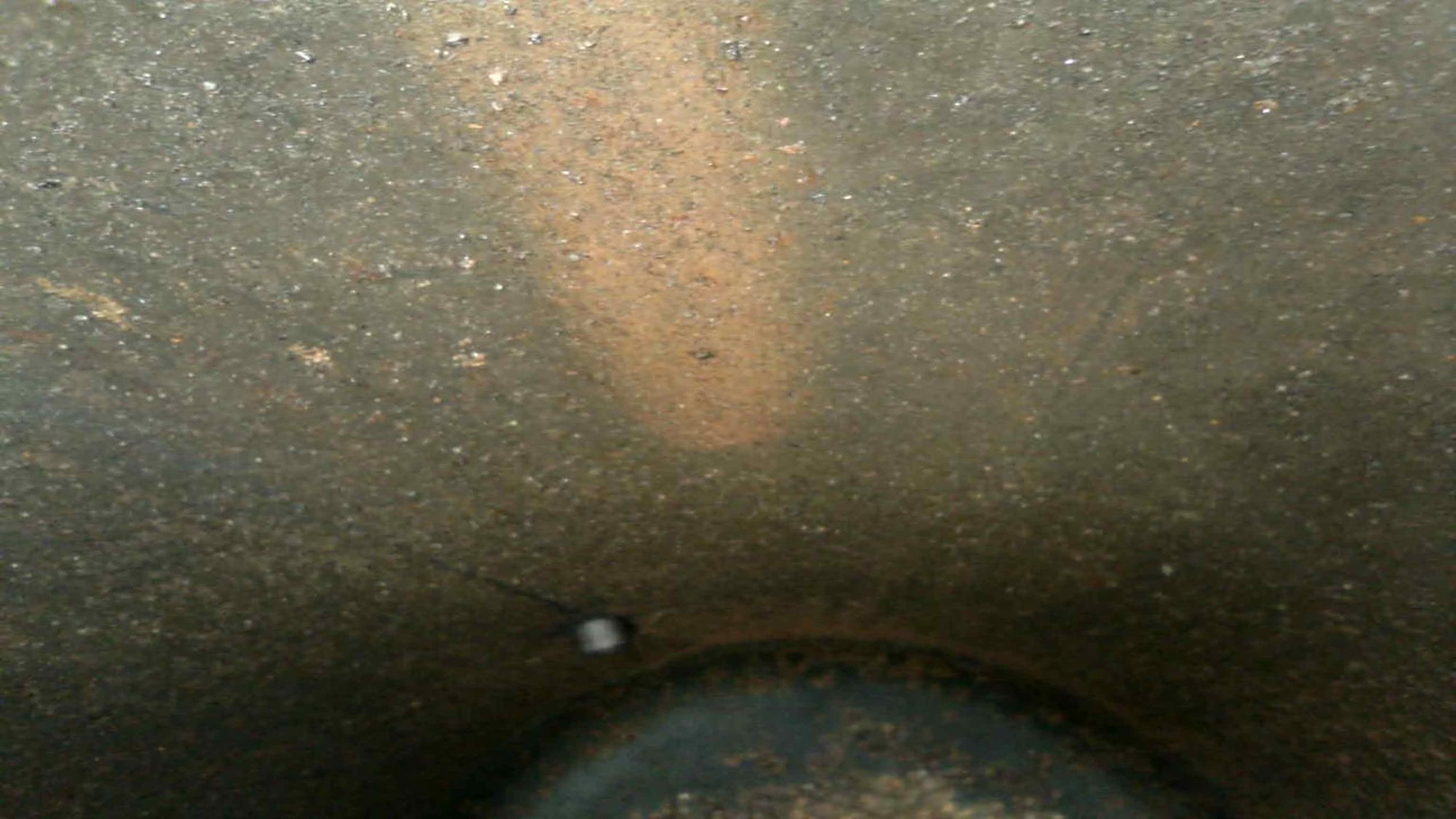

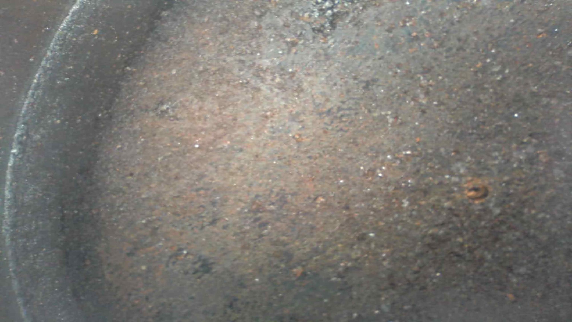

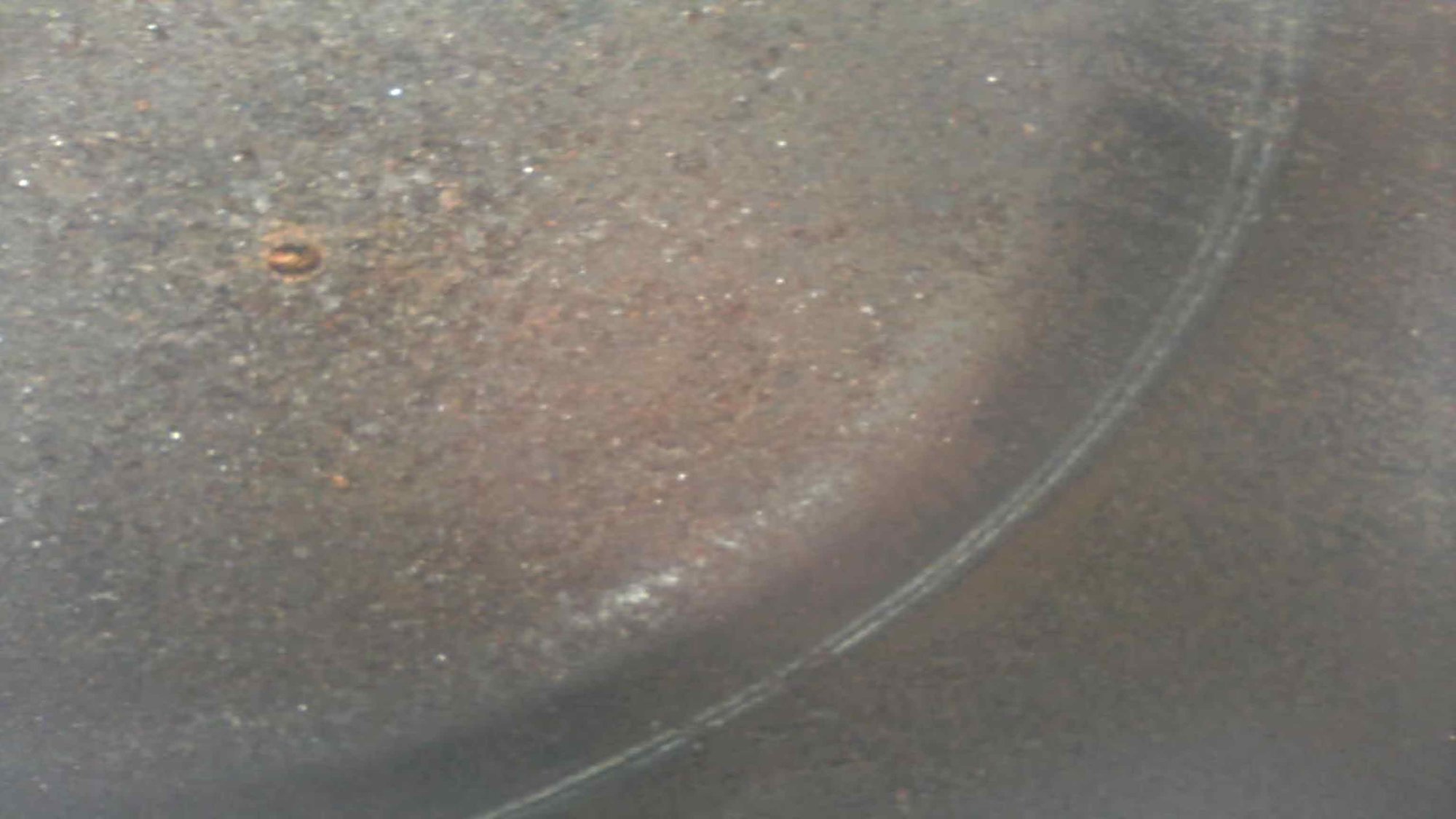

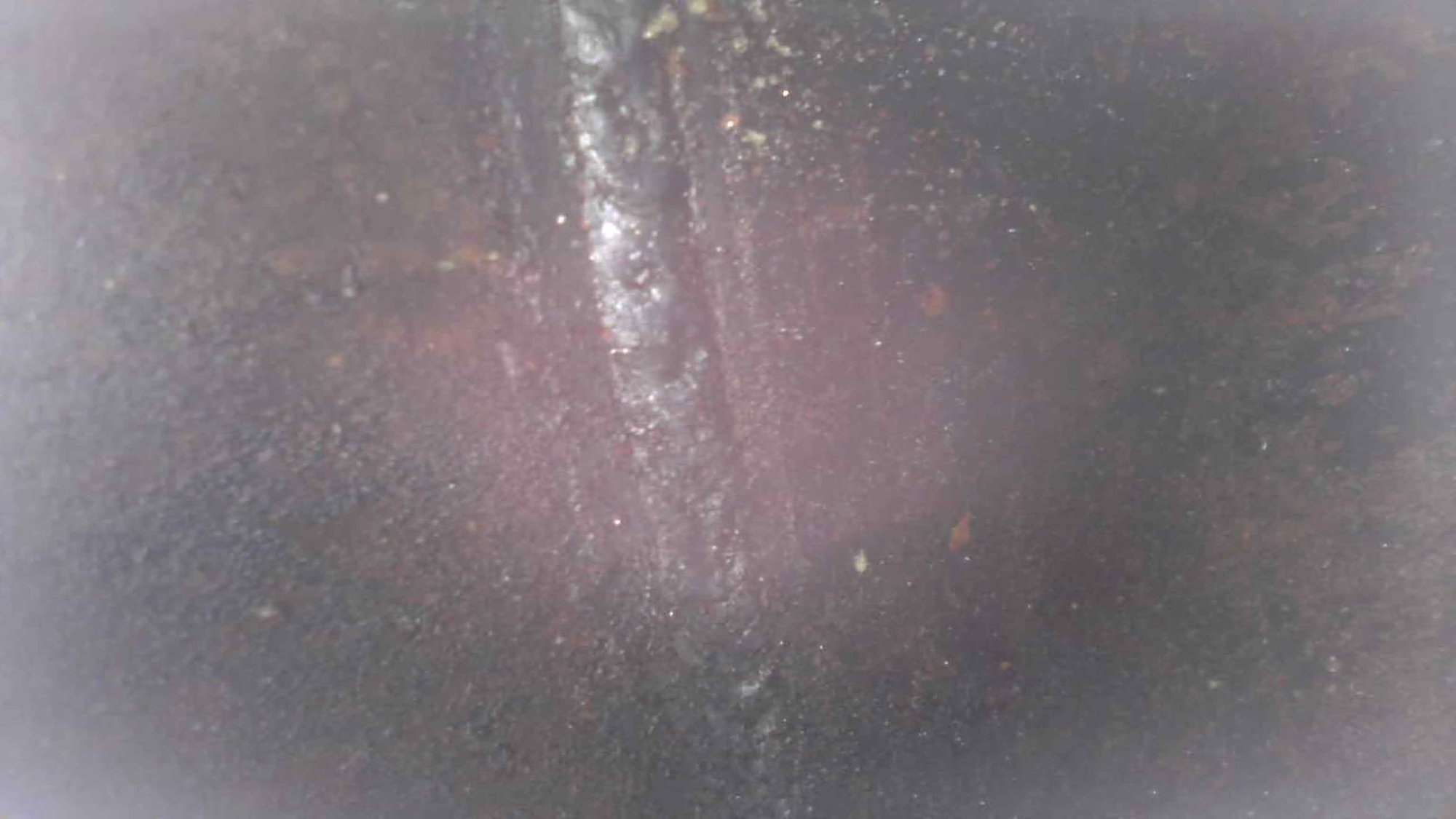

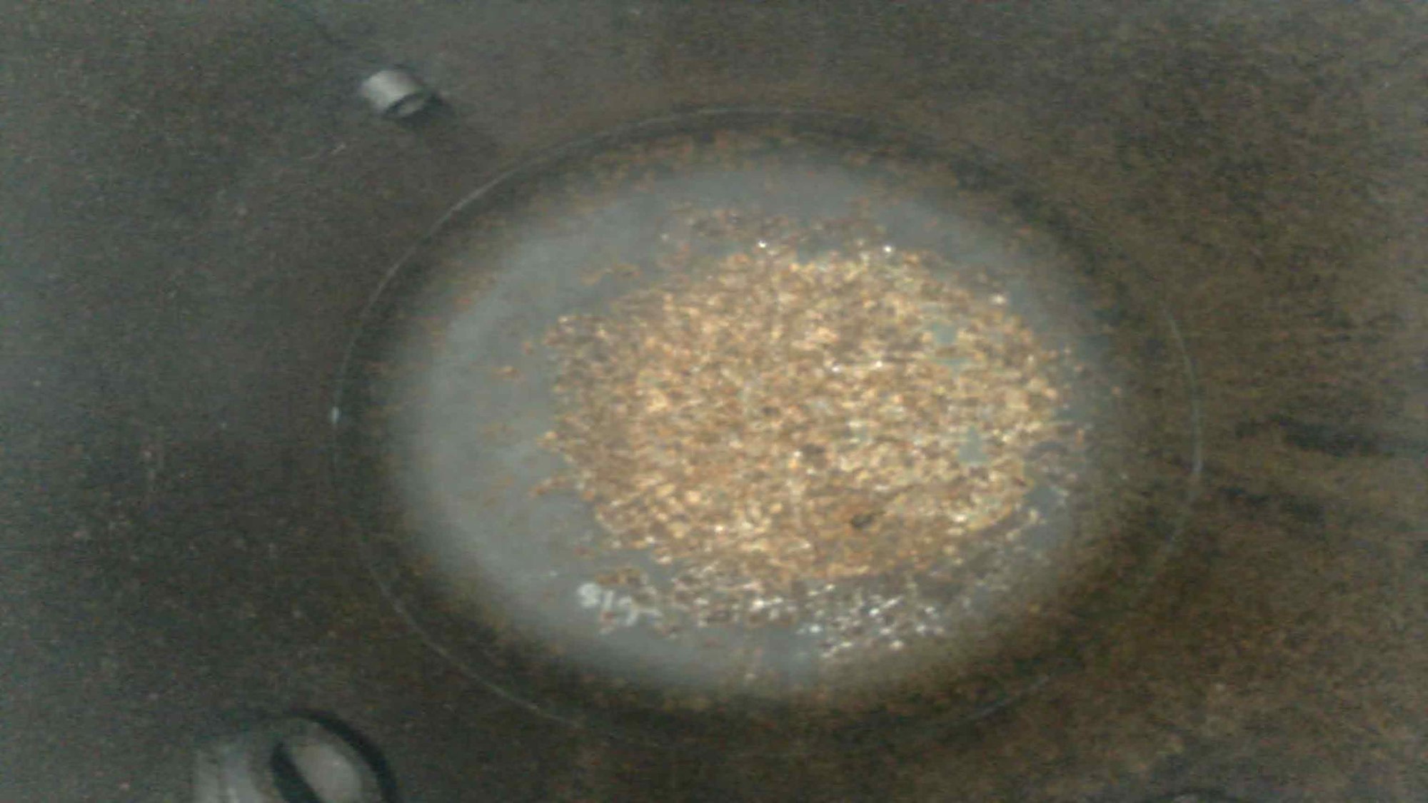

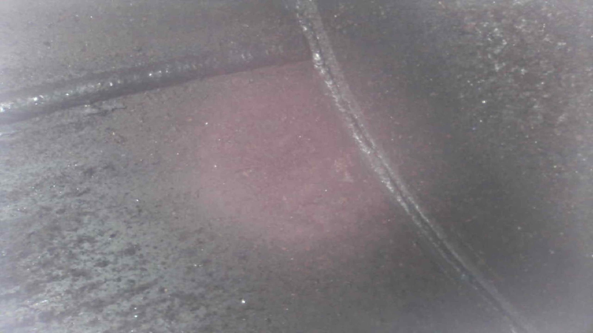

Ok chaps, apologies for the delay - first i had to wait for some stillsons to turn up so i could get the expansion port open, then i thought id better get a endoscope which can take photos, rather than trying to take photos of a screen. That being said, some of the photos are not that sharp, but i wonder if thats more me than the camera (I was trying to hold a light in there as well). Anyway, my first impressions (noting i am not in any way qualified) is that the corrosion is minimal, and the welds look clean and uncorroded, so its a goer. Anybody think otherwise?
These first ones are all looking down, at the bottom of the vessel, and the best i could of the weld. The drain port is just visible (with a slightly more orange rust circle around it).
These two are looking up towards the top.
