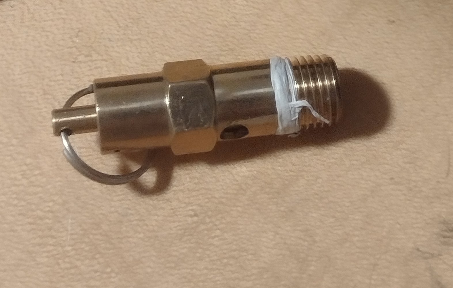

I stripped a few of these valves down today, to have a look. I can tighten the cap that retains the springs, I found a pair of circlip pliers that fit well. Now I'm wondering whether , they are set by different rated springs, or wether it's just a matter of the spring being loaded by screwing the cap in.I know? Not just 1 but two. Here's a photo of one of them.
I can't see all three of my pressure gages being wrong?
But as you say I don't like taking to many risks with compressed air cylinders.
I'll have ago at tweaking it in very small incruments and see how it goes.
Thanks for your advice
I know I sound arrogant, but I think I can run this one at 145 PSI when I need too for blasting motorcycle brake calipers and occasionally using my Lidle impact gun.

I tested hundreds of PRVs of various types in a previous job and whilst they were often a bit off, especially when old, they were generally fairly accurate. Where are you measuring your pressure from, and where is your PRV situated? On the tank or on a feed/ take off line?So' to recap. I have this week purchased two 11 bar PRVs , they cost twice the price of other generic PRVs but not the most expensive.
They both blow off before 9 .Bar
Is there something I'm over looking?.
I'm no expert , not an engineer etc' I trust the supplier, just can't understand what's going on? Can pressure gages go that wrong? It's a big differential between 8.5 - to 11 Bar?
I have seen electric motors that were overloaded fail in under six hours due to the increased operating temperature/current. Without checking the motor current when the compressor is close to max pressure. I always check current load on motors rather than rely on pressure gauges for operating pressuresI know it uses more energy and , places strain on pump and motor etc, but I only use it occasionally.
Some years ago I bought a good quality pressure gauge from the Budenburg company and kept that aside from general use so that it became my test standard for anything else I bought with a pressure rating. It did costs few quid, but I like having it to hand. Periodically, I used to send it off for calibration, but haven't kept that up.Without wishing to be all H&S I'd suggest that before you start adjusting them, it's worth getting a certificated pressure relief valve (there's a big difference between "yes we've tested it" and an actual certificate), or test your gauge against a known good (calibrated) one to ensure it is correct.
