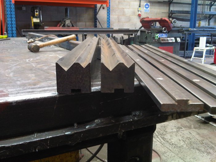

when i worked an omada machines back in my sheet metal days, when doing long work you,d find that the tool holders sometimes have a slight length difference causing uneven bends,
although the machine could be adjusted on both rams to ensure the correct angle all the way along, we found that slipping in small strips of paper ontop of the punch holder gave us a really good precise way of keeping a neat fold. just thought i sling this in,lol
Small bends in the top tools mainly. Very slight but enough to throw out the bend. Need to see about getting some refurbished.
