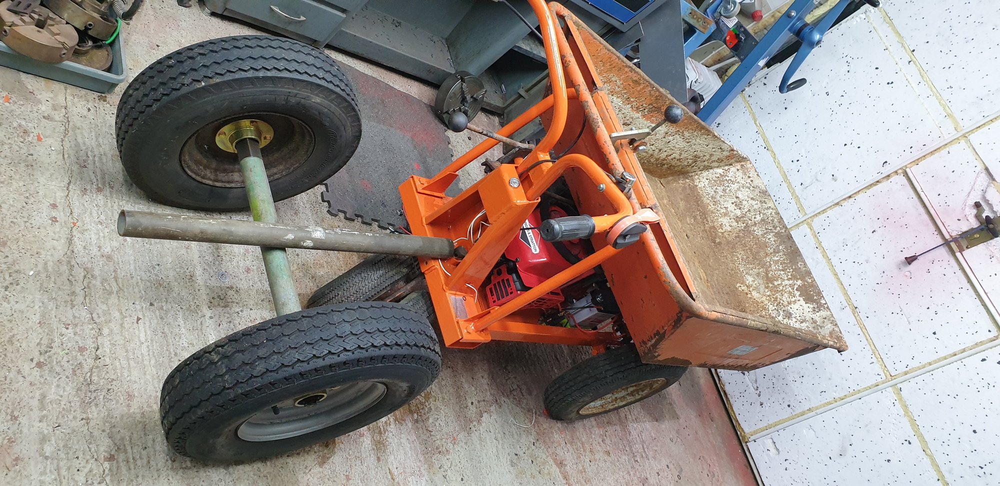

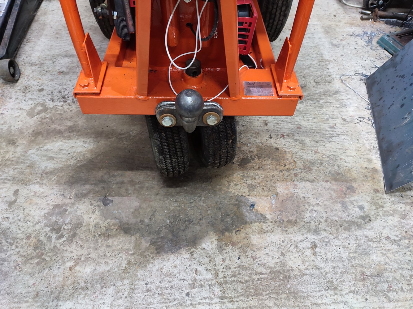

so i now have a project engine to pull apart and see why its spewing oil everywhere
dont know what was up with the original plug, was getting a good fat spark but
new filters and plug arriving tomorrow anyway. I can also use the mower engine to replace a few missing screws and covers on the barrow so no great loss
if its ******* oil not meny things can do that
watch out for if its been tiped on its side this is most of time oil in the ways or in exghust this will normaly clear after a few times of use
cheak gaskets some times they are blowing
problems with valves
problem with pistion and rings

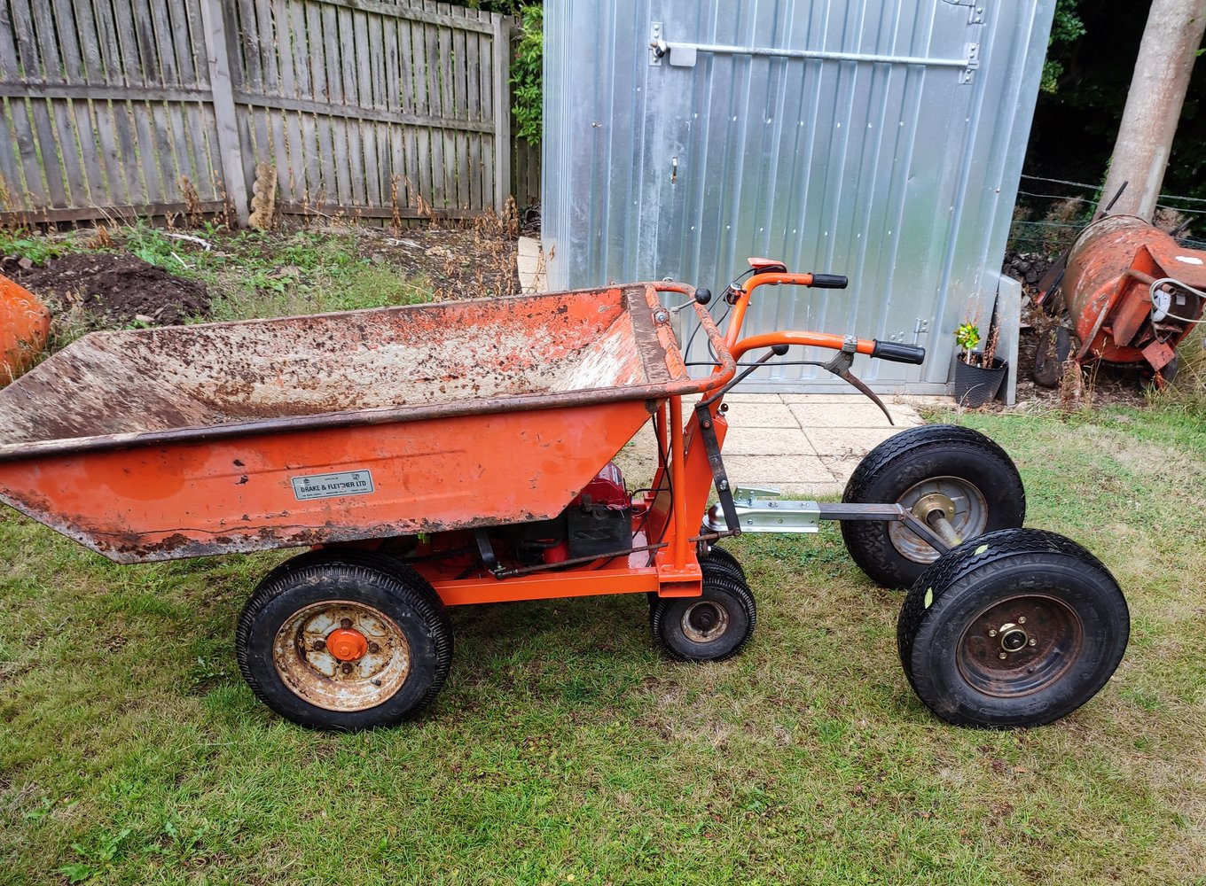

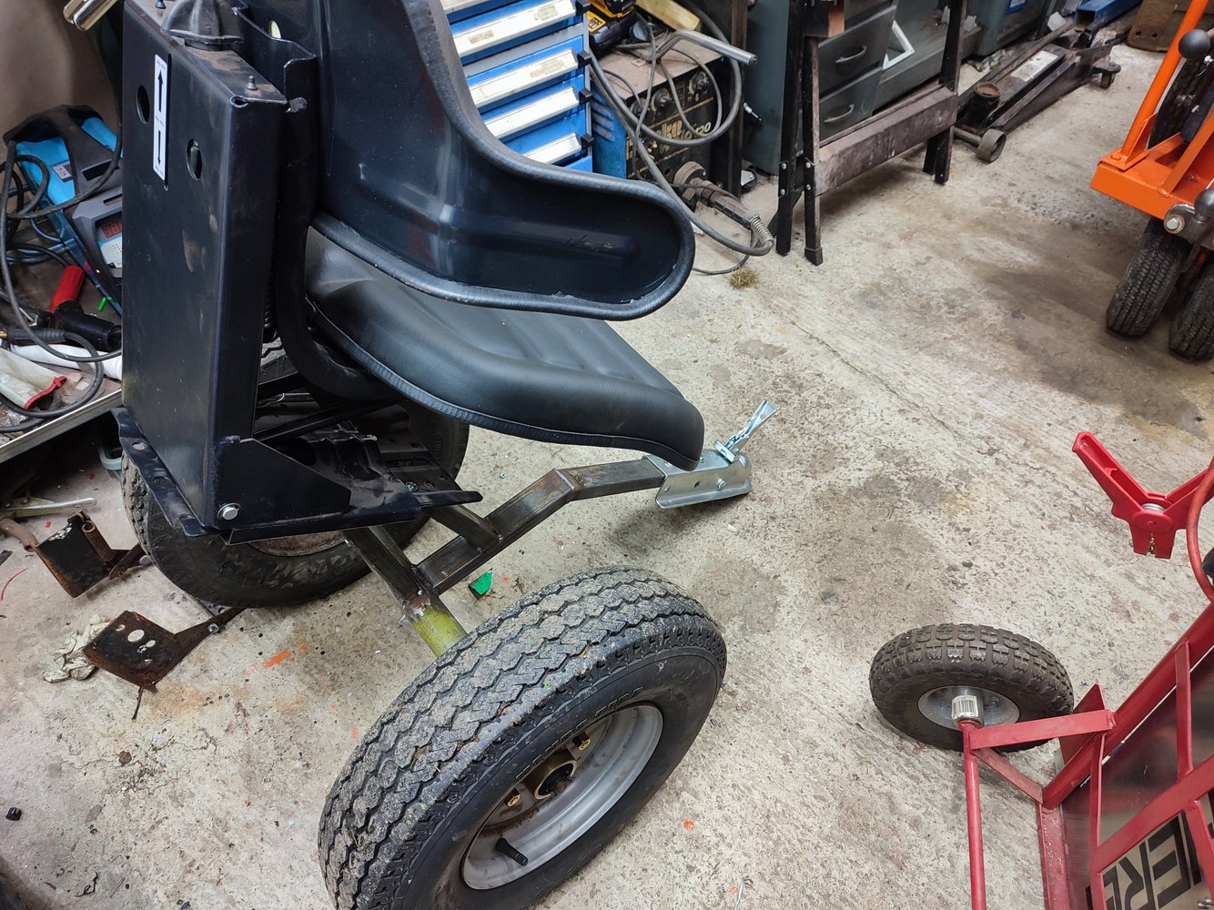

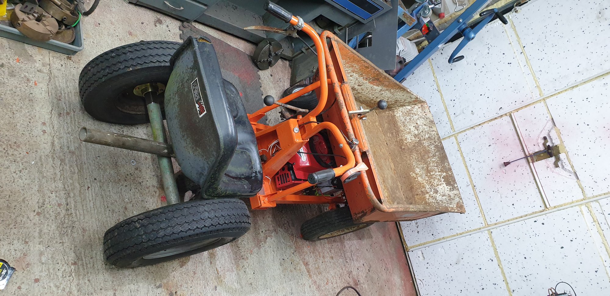

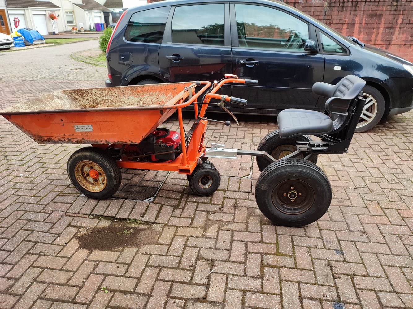

bit late to return them. It actually works quite well! Awful turning circle and it takes a bit of wrestling in reverse but it's got promise. What's more if the space doesn't permit it can be unhooked in seconds.
