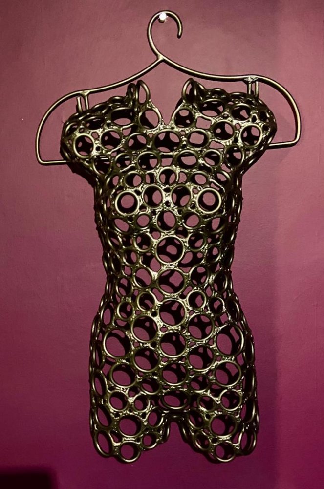

Plan A get the body made in this style, then weld short threaded stems all over the shop for the daffs
then get it powder coated green/

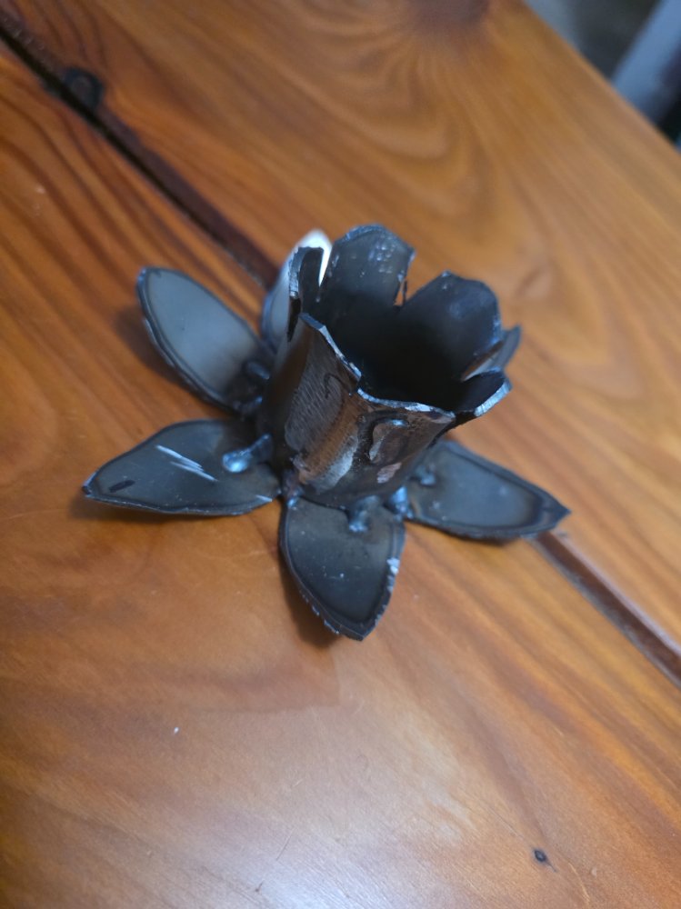

meanwhile make the 470 daffs like this. But get them laser cut. This is a lash up to get an idea of what I need .
Big thanks to forum member #Ichris for finding powder coater and laserpeople locally.
Weld M8 nuts on the backs of the flowers and get them powder coated yellow.
These will be done on a frame with M8 bolts welded onto it so a bulk process.
The actual process will probably be like this. Tack nut onto back of flower, screw stem into nut, weld stem onto body ad infinitum. Remove flowers, screw onto frames and get both lots coated. and reassemble
Issues? how hard to screw the flowers onto the studs after coating? will the powder coat need masking off? 500 of the suckers or will I be able to muscle the nuts on?
I have worked out a way of attaching a die onto a cordless drill or screwdriver handle to tidy threads if necessary
Studs? I dont fancy using threaded bar. 500 bits to cut with threads to dress on each one and thread visible on the length of the stem. Messy. I think use bolts. The ones with most of the length not threaded (they must have a name). and just chop the ends off; I can give this job to a young mate. Chop, bend, chop, bend ad infinitum.
