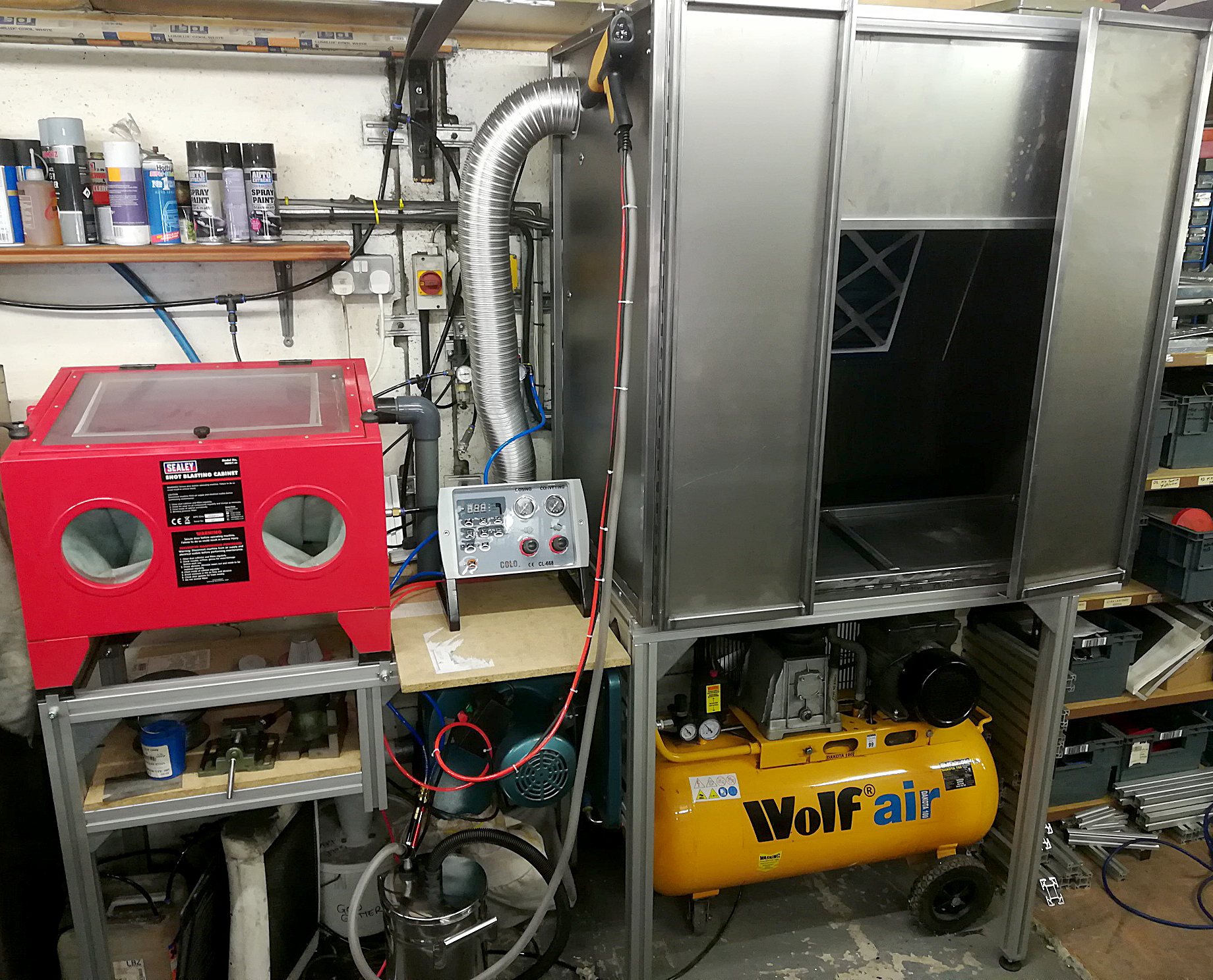

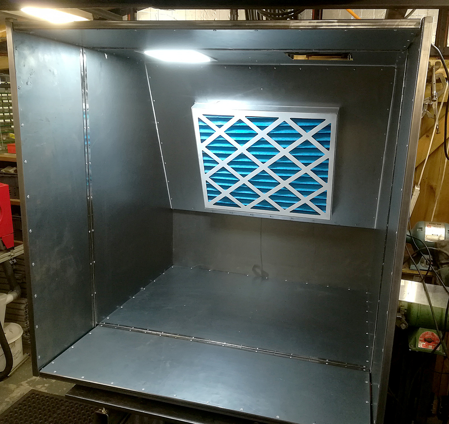

Fully assembled, only one light as the other was DOA

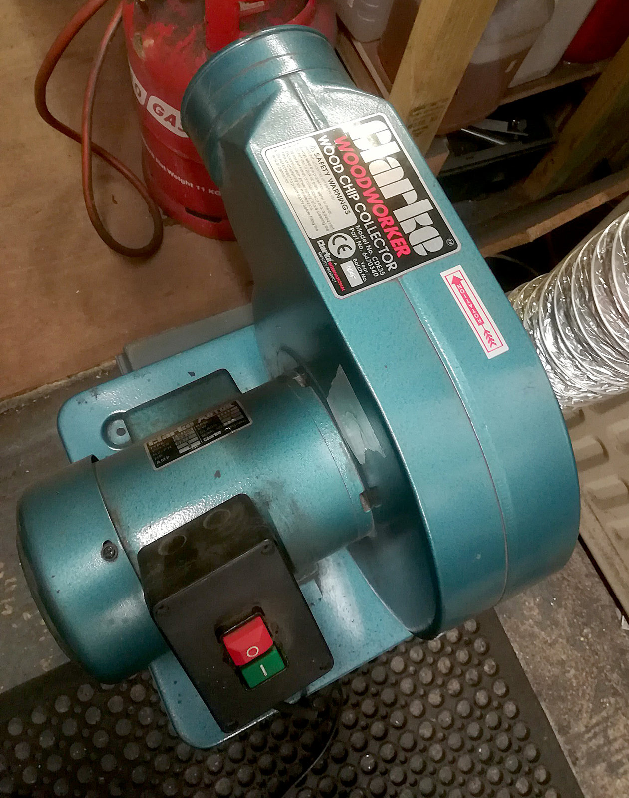

Blower...
Hooked it up for a quick test, shot some powder in the air just inside the front, most of it dropped to the floor and the rest slowly drifted rearwards - looks like it might all work![]()
Turn the filter the other way so the pleats are facing down, as over time they will sag placed in that way
