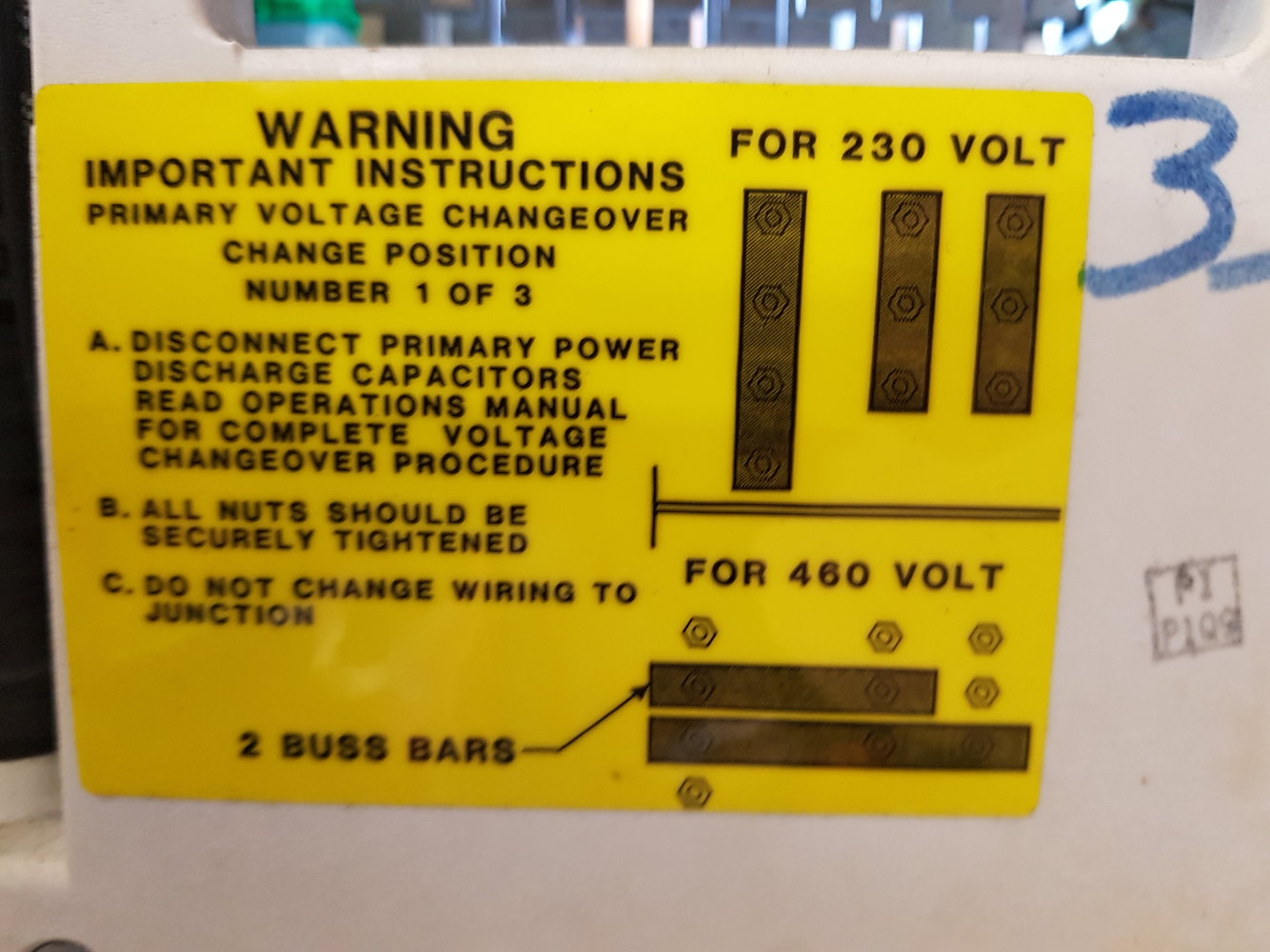

I picked up a 300SS a month or so ago,
I was wondering if it was of any use as a stick welder,
It has no leads with it, that should not present to much of a problem,
I would need to change it to 240v single phase, which lowers its output as said above,
Would anyone have a link to a pdf manual please, TYIA

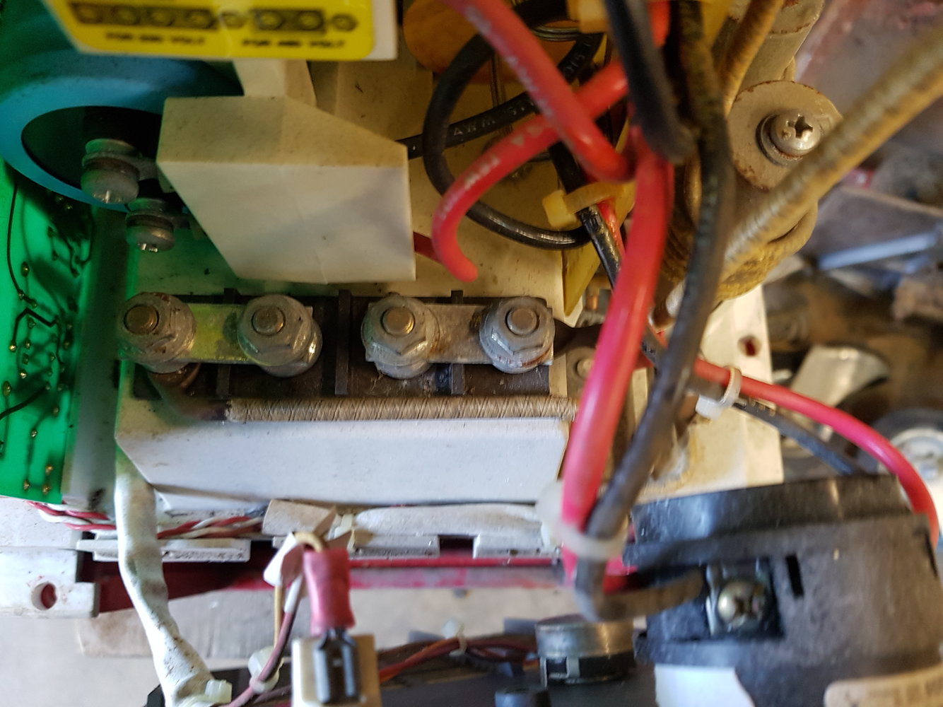

Thank you for the pdf fileLooking at the front grill the first thing to do would be take the case apart and clean the dust out

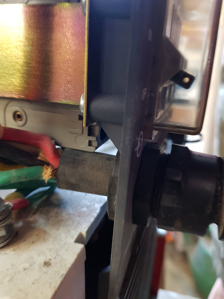

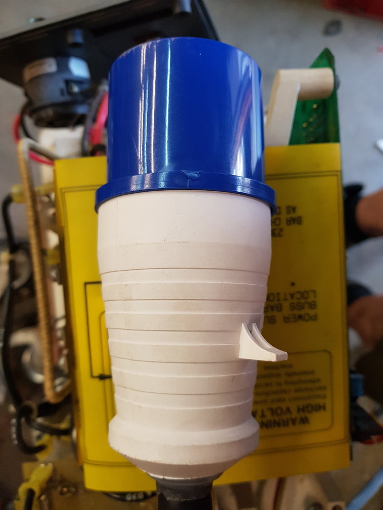

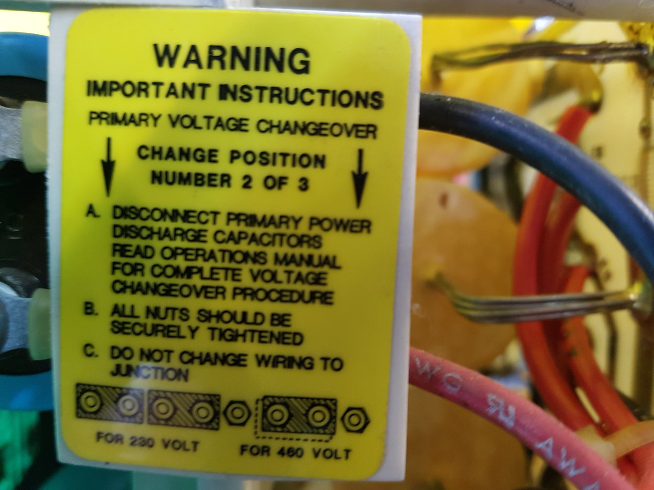

That does like quite clean inside and nice plane instructions on how to change for different voltages

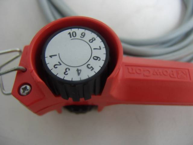

I have had the PowCon working today, it didn't blow up,they are one of the best around
