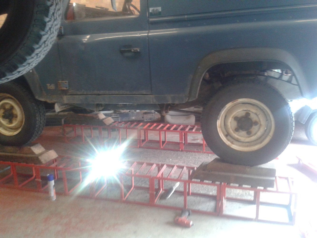

Just had a look.Ah 'the death trap' thought by some on here haha.
Did you ding the link.
It worked a treat.
I like your lifting solutions- especially the large Acro-prop axle stands! (Funnily enough I'd been thinking something similar, as a builder mate has loads of Acro's, and I've seen just how much weight you can lift & support with them).
I've been looking at Air Bag Jack's too as a quick lift solution.... but never laid eyes on one let alone used one.
Are they good?
(I was thinking they'd be good to get height, then pack under wheels, drop bags, pack under air bag jack - repeat till at desired height etc).
Air bag jacks seem like they might be good - no idea if I've enough cfm/Air though (I have a 1972 IR30, 150L, and/or a 100L Clarke belt-drive.... the latter ideally as its a lot easier to move!)
