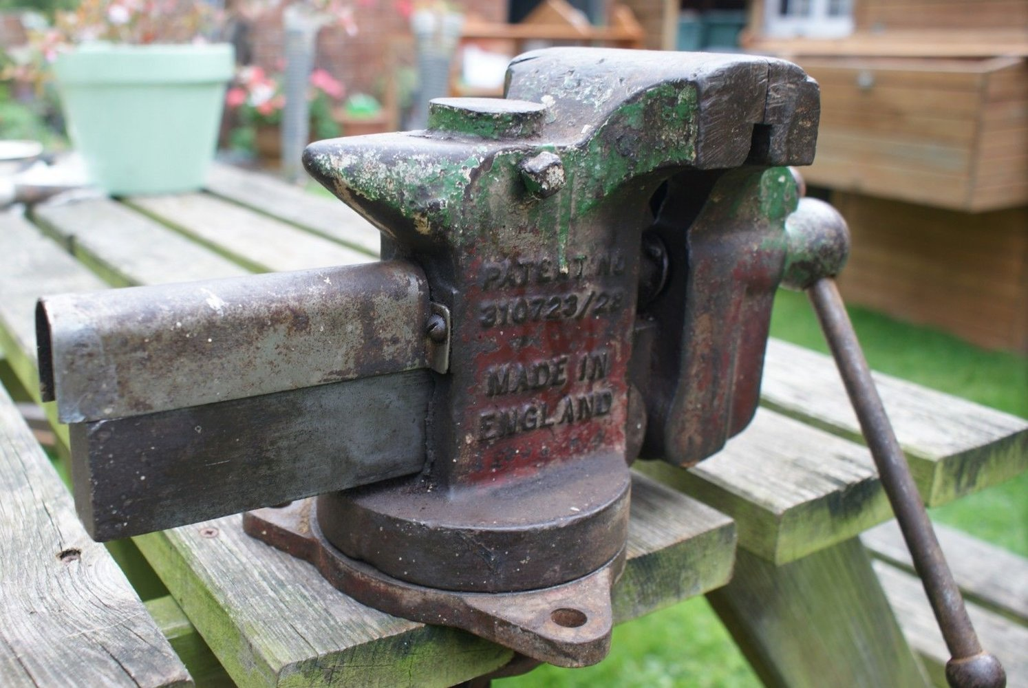

This is the vice I have, minus the swivel base

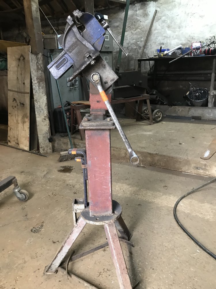

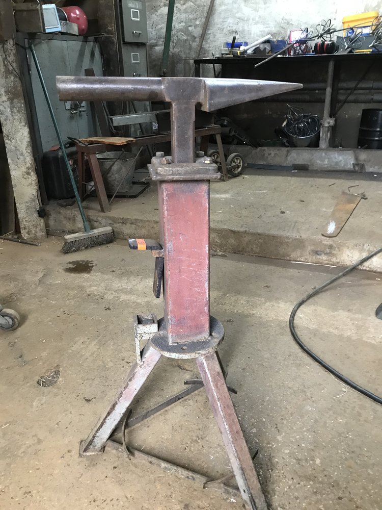

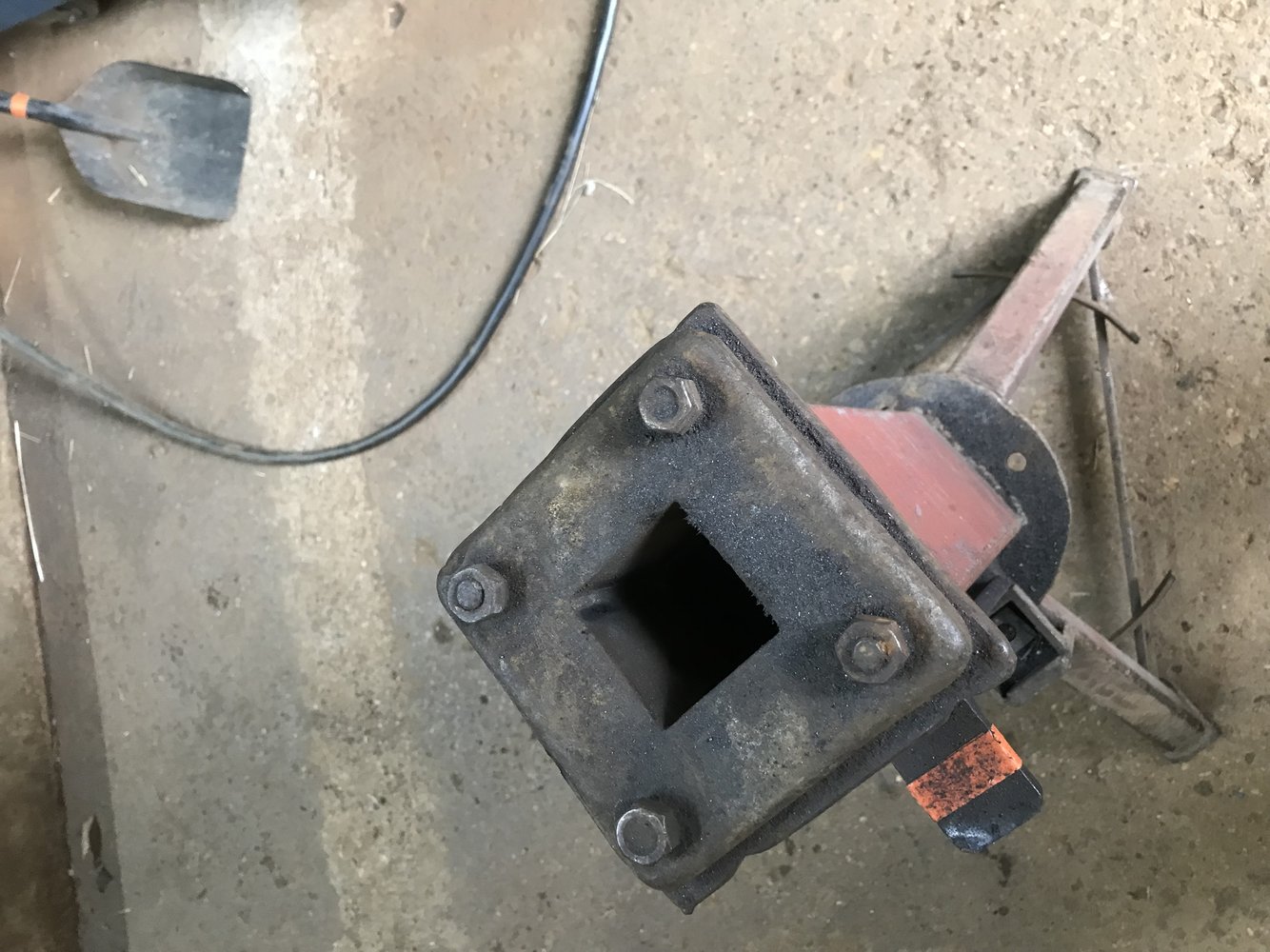

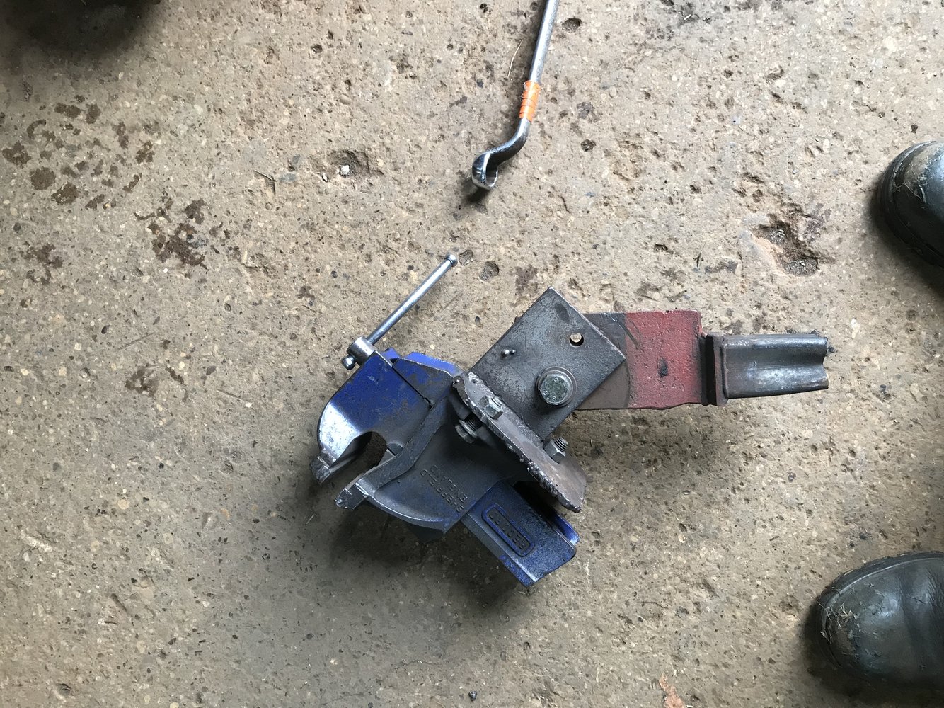

That a neat little contraptionVice is removable just nocks into tapered stake holder other tooling can drop onto the stand.View attachment 446814View attachment 446815View attachment 446816

What does the underside of your vice look like? Could you use or adapt the pivot bolt (or rod or threaded hole) somehow for mounting the vice to a stand? A pin could be added to prevent it from rotating. That might allow you to mount the vice without doing anything invasive to the vice.I will drill holes through the round section, but I will loose the swivel option, that’s not an issue
The threaded section has snapped off, will post up a picture later onWhat does the underside of your vice look like? Could you use or adapt the pivot bolt (or rod or threaded hole) somehow for mounting the vice to a stand? A pin could be added to prevent it from rotating. That might allow you to mount the vice without doing anything invasive to the vice.
