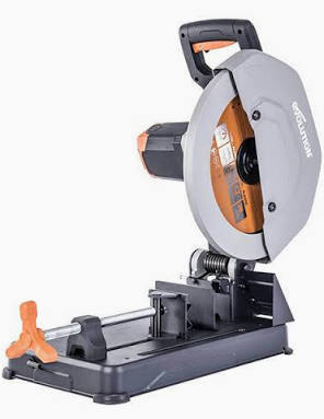

Hi everyone I have a Makita cutoff saw 355mm abrasive.
I've been very happy to have discovered one of those , bought it, restored etc.
Today I've took it with me for a side job but I'm now extremely disappointed.
First of all 355x30mm disc are impossible to find in my location.
I've had to make an adapter for 25.4mm disc and ok.
I've cut all the box tubing no problems.
Time to cut the angle iron now the big struggle.
45° cuts, the vertical side has been cut no problems but the side lying on flat not.
The workpiece became Red hot and even stalled the saw
It wasn't anything extremely hard to cut.
Just 40x40x4mm angle iron.
I've finished to cut it using my cordless Makita knock off angle grinder no problems.
But eventually batteries died and had to stop working because I didn't take a corded grinder with me as it was supposed to just remove burrs and nothing more.
Now I have a big 250mm cold saw but it's stationary and I have to restore it prior to be able to use it.
Impossible until I get my workshop built.
Is there anything I can do to improve this saw just to keep up working with it till I get the other one running?
I don't know maybe a particular cutting wheel?
My only need for the cutoff is cut straight at an angle without having to stay there and trace every single cut.
Because at this point I keep using a grinder as I've always done since I've started to play with metal.
Useless to say that it's extremely time consuming and not even accurate
