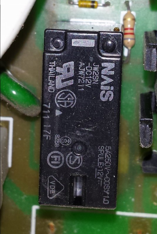

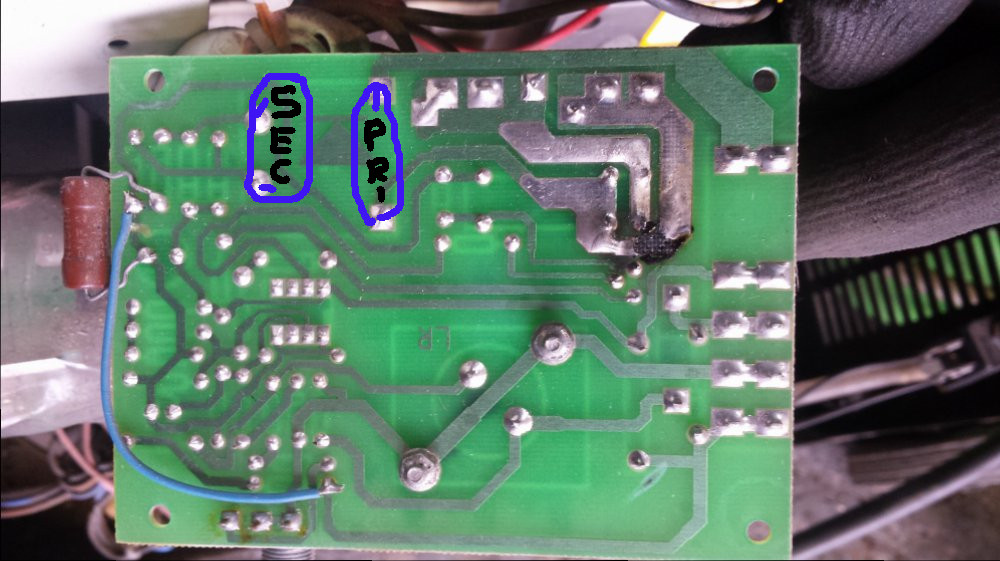

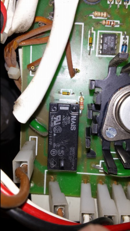

The relay it self would not have caused the track to burn out, so my concern is that you replace the relay, wire the track and switch on and it just burns out again.
You have to find the fault on the set.
Adrian

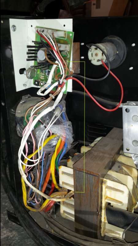

The selector switches are typically on the mains side and the relay switches mains to the transformer, I am thinking 6 position multi-pole switch, that has three main connections and a low high as well, so position 1 is A & low, 2 is A & high, 3 is B & low, 4 is B & high, 5 is C & low and 6 is C & high. My old Cosmo 145 was like that. Or it could be multiple taps on one side, think I can see 6 coloured wires from the selector. The main difference here is the control board has no transformer so a bit like they use the rectified output to power the control board?looking at the welder front panel it has a separate mains switch so power selector switch should be live only so no dead short there
so your thinking the output from welding transformer / rectifier powers the pcb ?The selector switches are typically on the mains side and the relay switches mains to the transformer, I am thinking 6 position multi-pole switch, that has three main connections and a low high as well, so position 1 is A & low, 2 is A & high, 3 is B & low, 4 is B & high, 5 is C & low and 6 is C & high. My old Cosmo 145 was like that. Or it could be multiple taps on one side, think I can see 6 coloured wires from the selector. The main difference here is the control board has no transformer so a bit like they use the rectified output to power the control board?

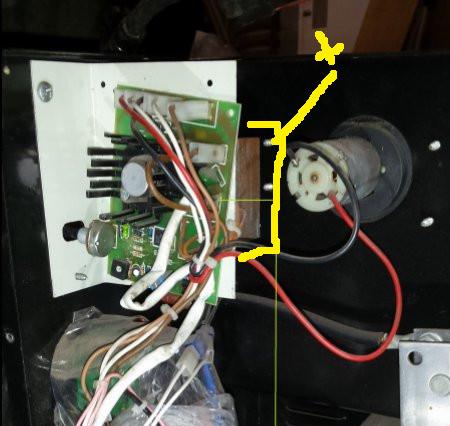

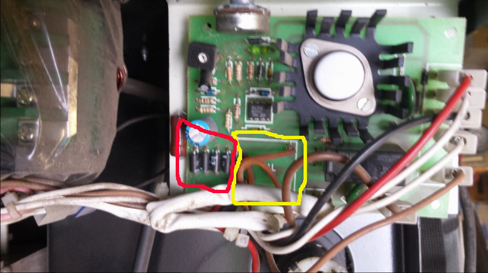

but it cant be fed from the welding rectifier as the welding transformer isn't energised until the relay is operated so it has to have an external power source to power the relayI am not sure? I think this bit of the board (in yellow box) should normally have been a small transformer.
the bits in the red box are 4 diodes as a bridge rectifier for the likes of the speed control, in my mind at least as above it is the trim pot and the main wire feed control.
You would not want a mains driven speed control so can only assume it is fed back from the rectifier?
Adrian

I'm guessing a small transformer mounted somewhere, could also be part of previous repair, I cant find any nutool mig diagrams or any awelco which is I think the company that made themI know, that is what I finding hard to understand, that thin track you mentioned before on the board takes mains to a T1 pin then there are brown wires going off the board, and brown wires coming back on on where I would expect the secondary windings to be, wondering if there is another small transformer tucked away we have not seen, I notice there is signs of rework on the board already with an external resister and cut track?
Adrian
