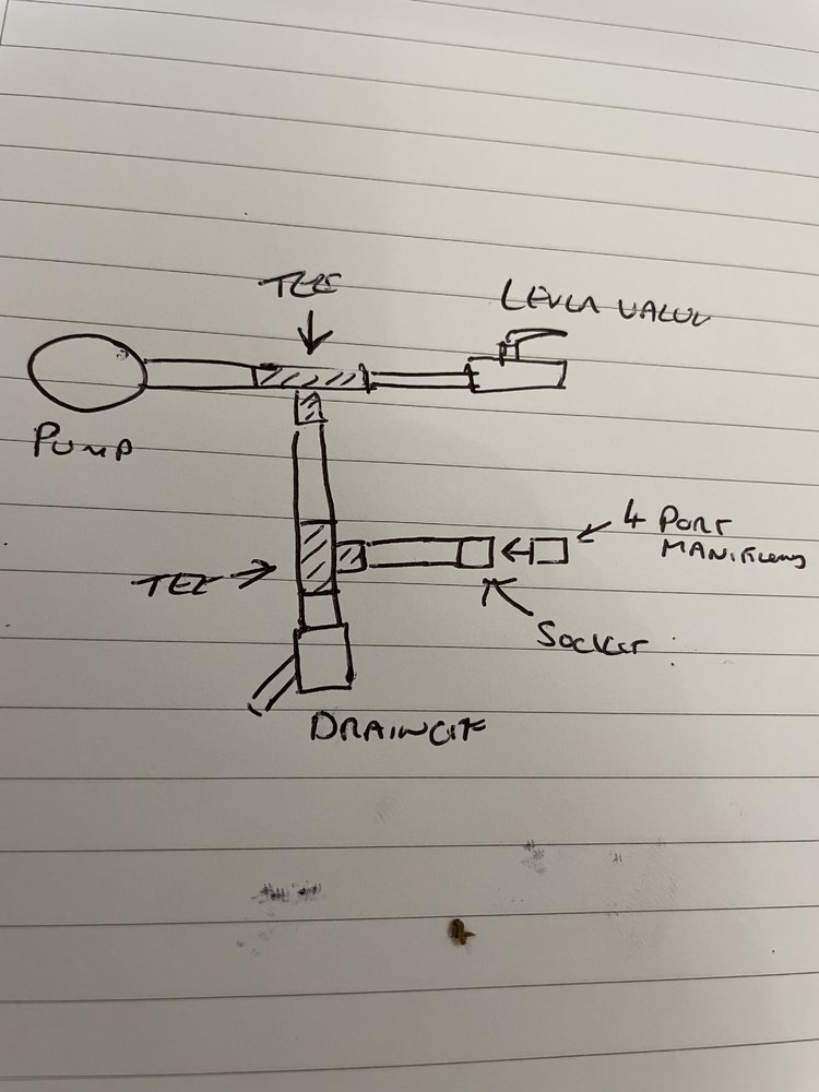

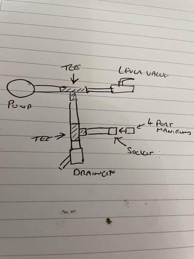

you could either use a series of 22 x 22 x 10 copper tee’s , the last number denotes the branch size . Solder them in line , so all the 10mm branches face out to make a DIY manifold , or if you want to go down the route of pushfit or similar try Screwfix 217KR .@Sam` , good call on the lever valves , havent found similar manifolds (yet) so looks like mix n match might be like you said.cheers

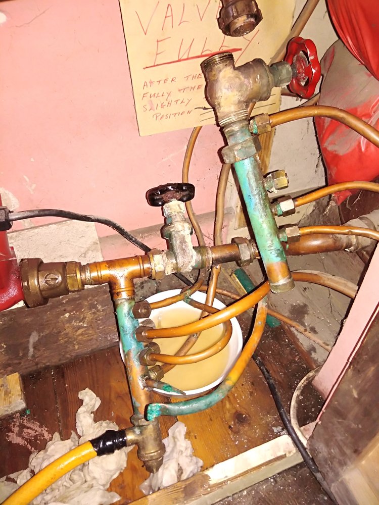

as the pipe dont have much movement or spare length to play with dont think I would have much success with the 217kr , really need metal with similar ports and then push fit converters possibly , I see what you mean about the 4 way brass converter but how does it fit in the system , the T s are again another option but then you need converters to valve size as well ....might be I have to use old one , block broken port , solder around base of other ports to strengthen , but that is asking for trouble in reality.You

Like this …Got to replace 2 gate valves and manifolds on the central heating , wheres the best place to buy ? thanks
