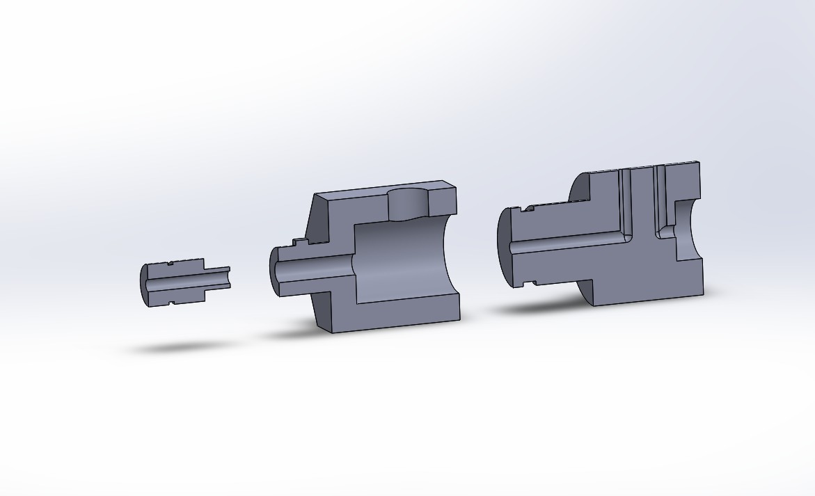

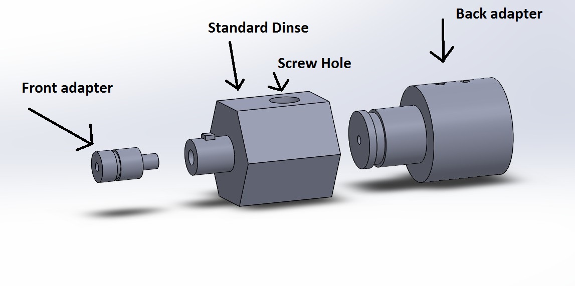

Square holes really need broached in some way but I have seen ones that seem to be pressed in so possibly the key is rounded at one end and pressed in.It can be made easily
The only tricky part is the square notch on the dins. I’m sure your kit could cut that out mind. Other than that it’s a simple lathe job.

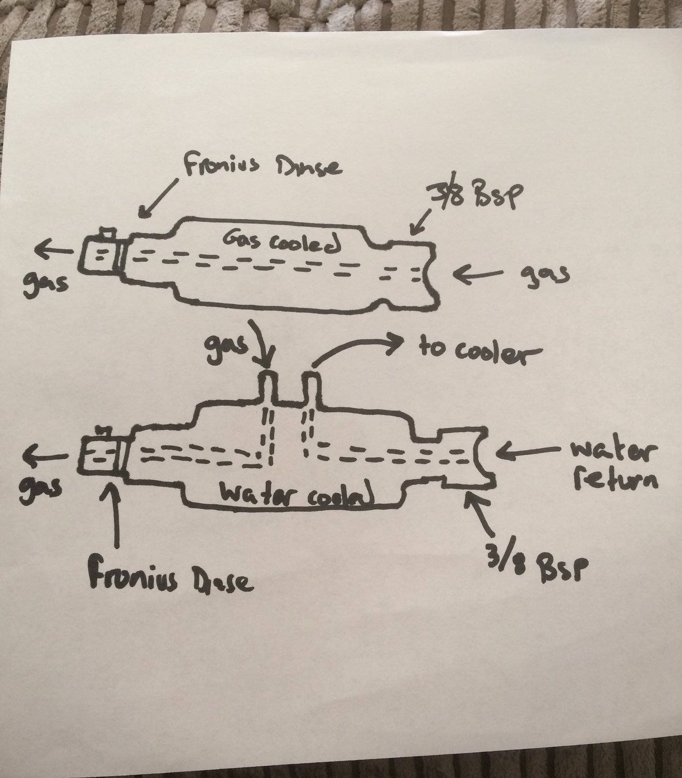

No drawing I’m afraid. I’ll find a pic

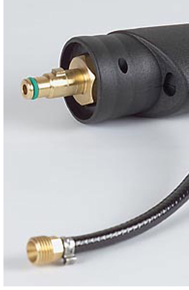

No it’s even easier than that. The other end is 3/8bsp male threadIs the large diameter standard size for a dinse? If so then it may be fairly easy to start off with one of them and thus not have to bother messing with the key.
I think we are at crossed purposes here.No it’s even easier than that. The other end is 3/8bsp male thread
Probably not worth my time making them as volume would be low. I am more thinking of a way a standard one could be adapted for someone with a lathe to easily make for themselves.If you can make them easy and relatively cheap you could make a nice little earner. Not only are those adapters very expensive but they are not easy to come by. I got lucky with mine. The last time I saw a water cooled one was on rapids site for £200 inc vat. Even the water cooled one wouldn’t be too difficult. It’s just drilling the two channels and tapping for barbed fittings.

I have a pillar drill, angle grinder, Vice, dremmel, micrometer, vernier. I can solder really well. The square key could be cut and soldered into place. Solder holds 4tonnes/Sq inch if done right.
(I dont have a cooler and dont plan on weldng at say 200 amps plus where an air cooled torch will smoke your pinkie.)
I could make a cooler, I have a pump from a washing machine, (maybe use one from a PC overclock cooler) an equipment fan, I would need a heater matrix off a car as the radiator. Could do it £50 Id guess. Plus cost of the de ionised water/Glycol mix.
