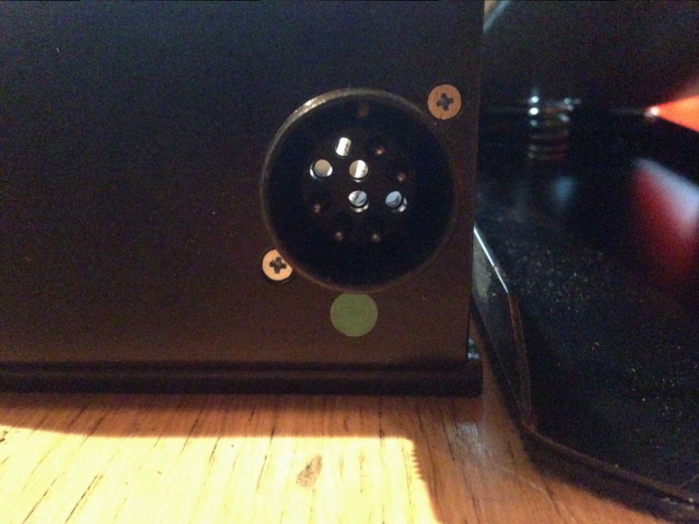

A little bit of more bad news for you. Your ck tig torch ain’t fitting that machine either. It’s an odd shaped gas through dins plug. ....
It can be made easilyYou got any pics of it Richard?
Could it not be made relatively easily?

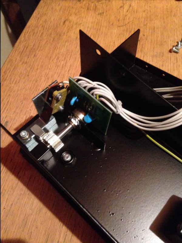

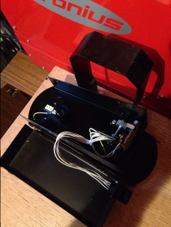

Some guy is using CAN bus on a project in work. It is a bit subtle. Your right its difficult. I can do the hardware design to produce CAN differential signals.
What is difficult is finding the CAN ID for the pedal which will be unique and then how the pot or rotary encoder position is converted to data, often a CRC (Cyclic redundancy check) is computed and added to the sent word.
There is a guy on you tube doing it with a pot into a small uprocessor. If he helps me Im in with a fairly remote chance.
Looks like Ive stitched myself up here, just about the worst mistake Ive ever made.
