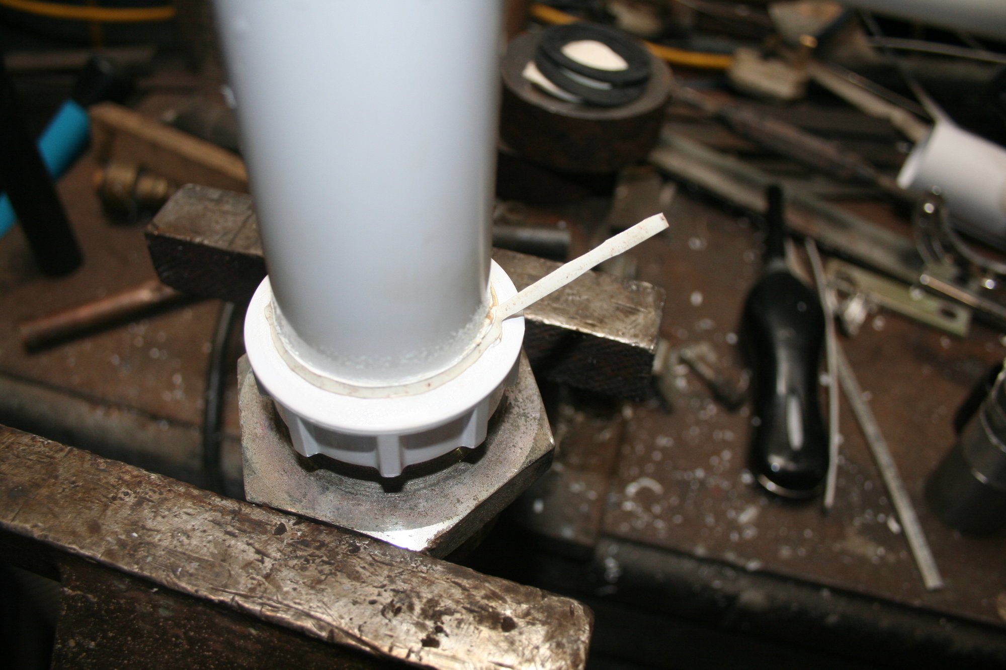

Don't be expecting miracles.
It is welding and you wouldn't expect to weld steel and have an invisible repair with no further work.
Plastic is the same and you need to dress the excess plastic from the weld area.
Only photo I have to hand is of the tig welding rod holders I made and you can get a reasonably tidy joint.
This is ABS and the filler rod was cut from the same pipe
