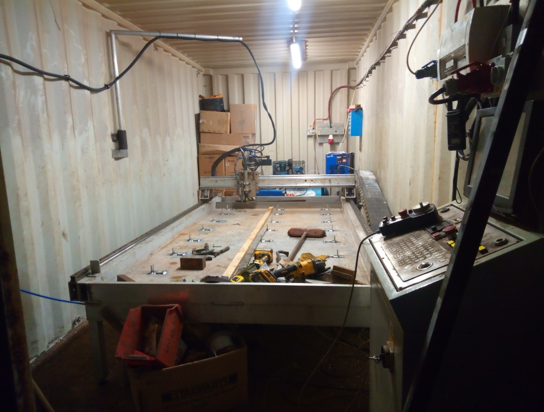

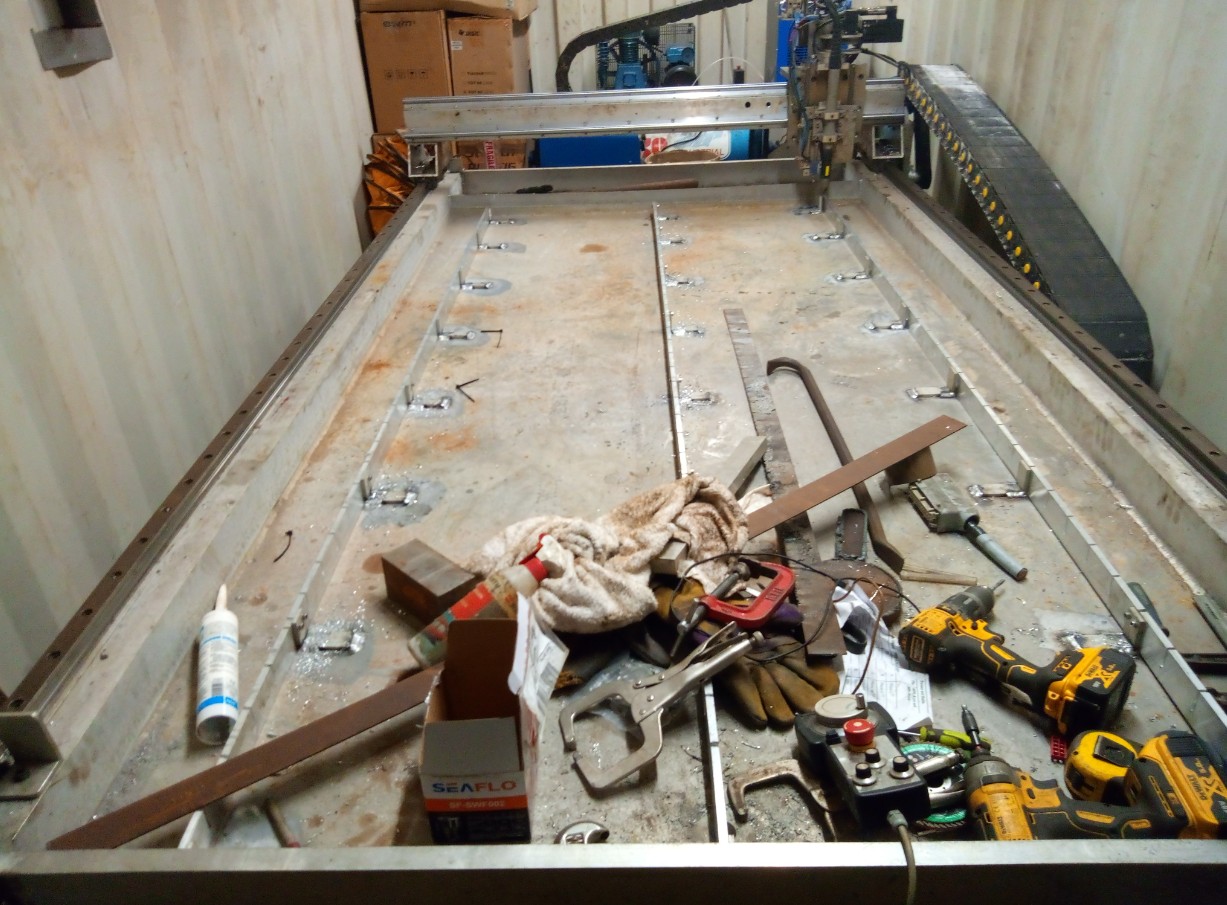

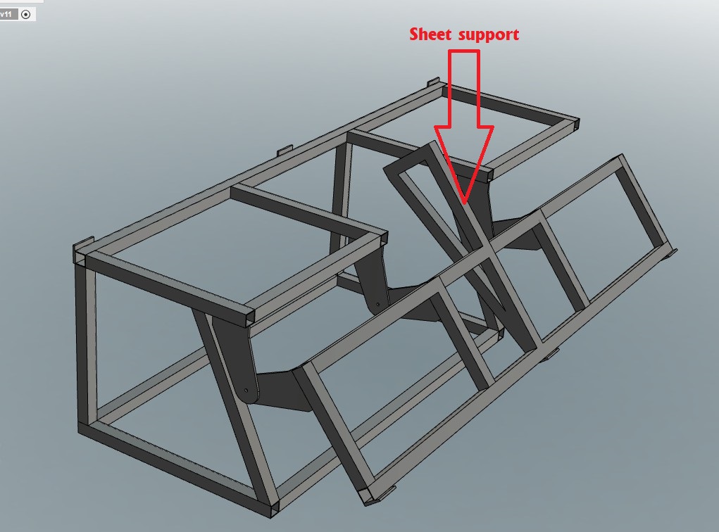

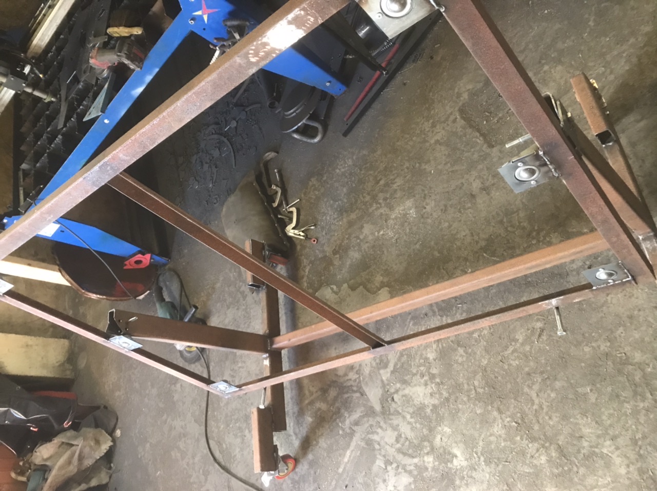

I want the tilting part shorter so that I don't need any locking mechanism once horizontal as the sheet will hold it down.
I have a back rest as you can see in this pic that will mean the sheets won't drop down as I tilt back to horizontal, presume that was what you were meaning?
