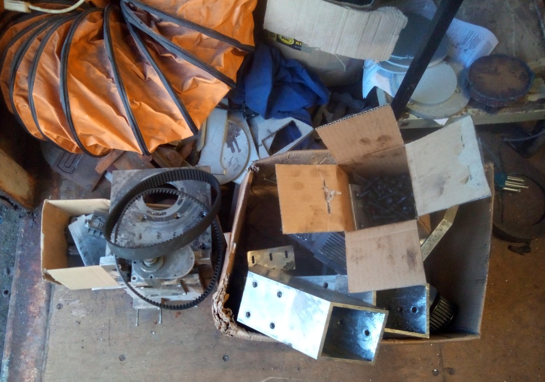

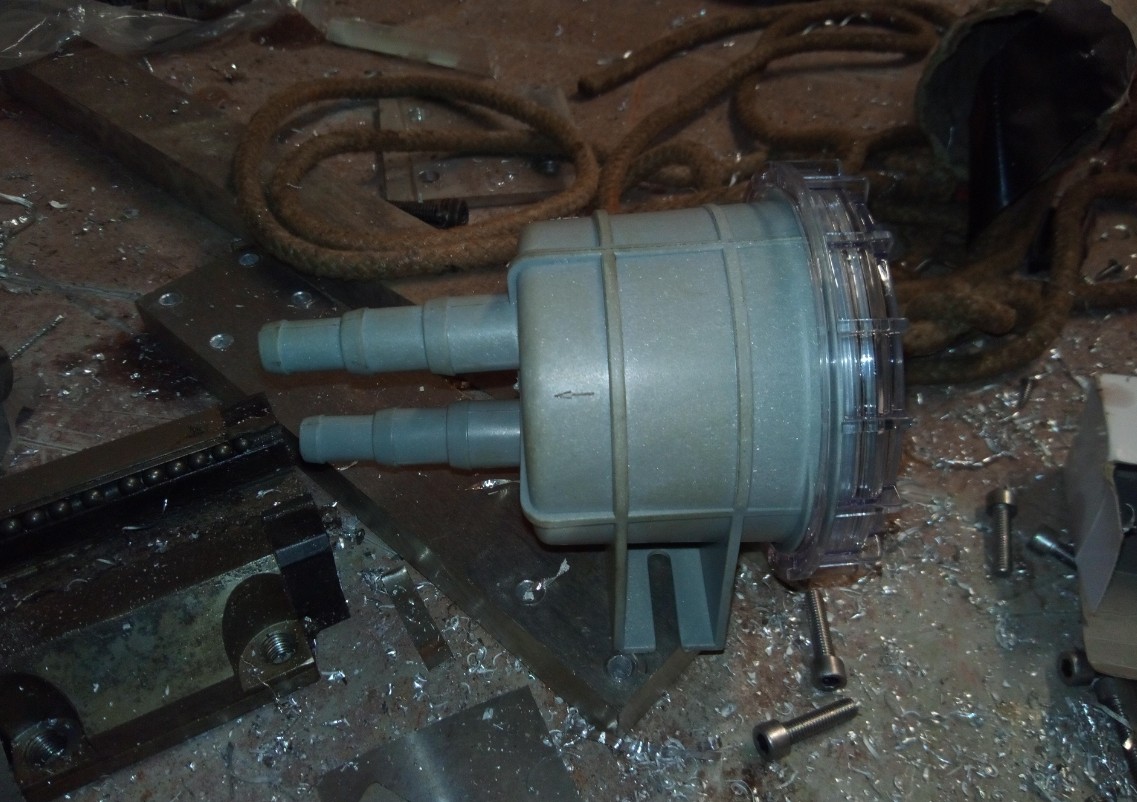

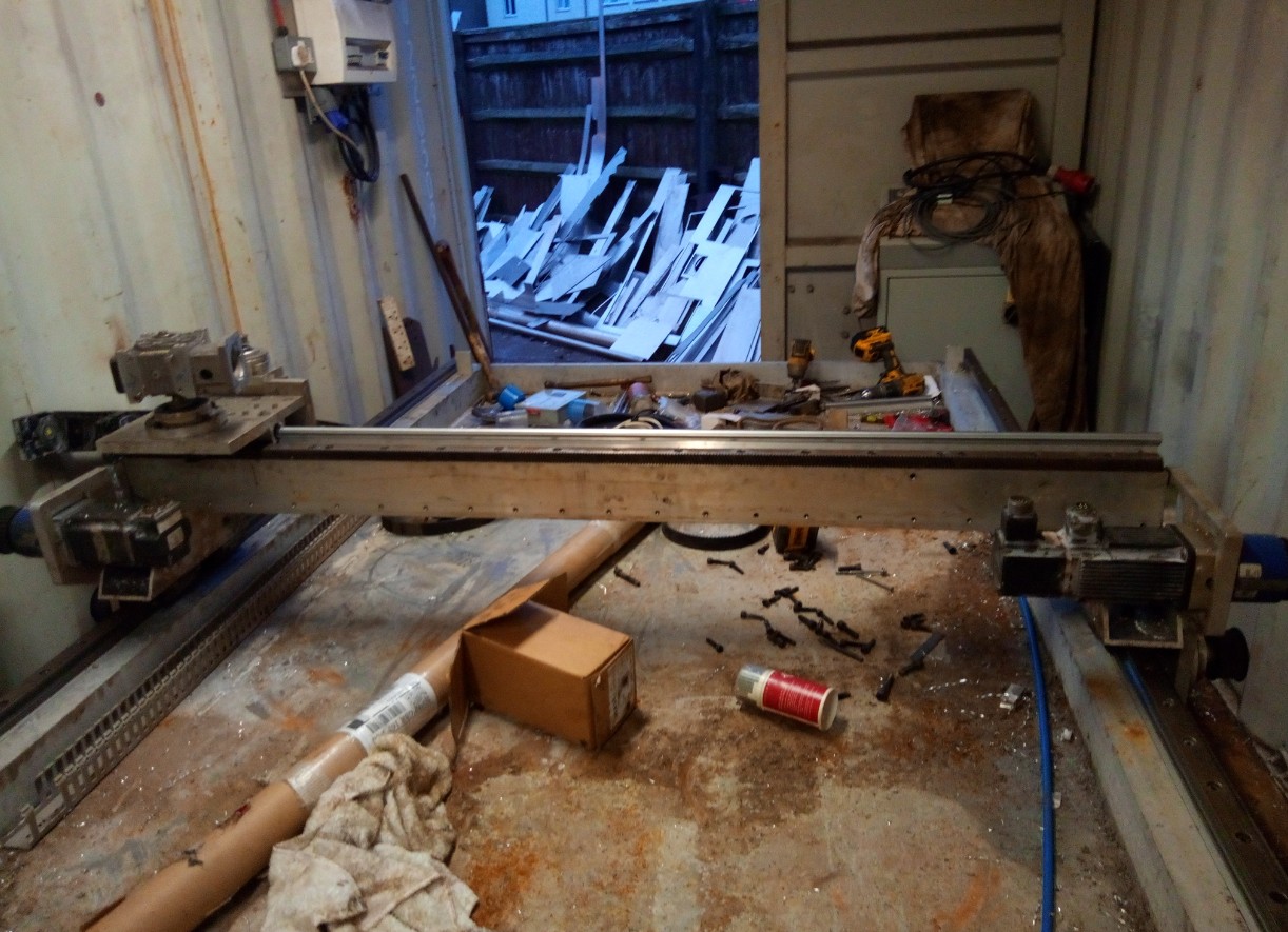

I decided to go for the 60/40 pulleys as originally planned, I thought what the heck its only money

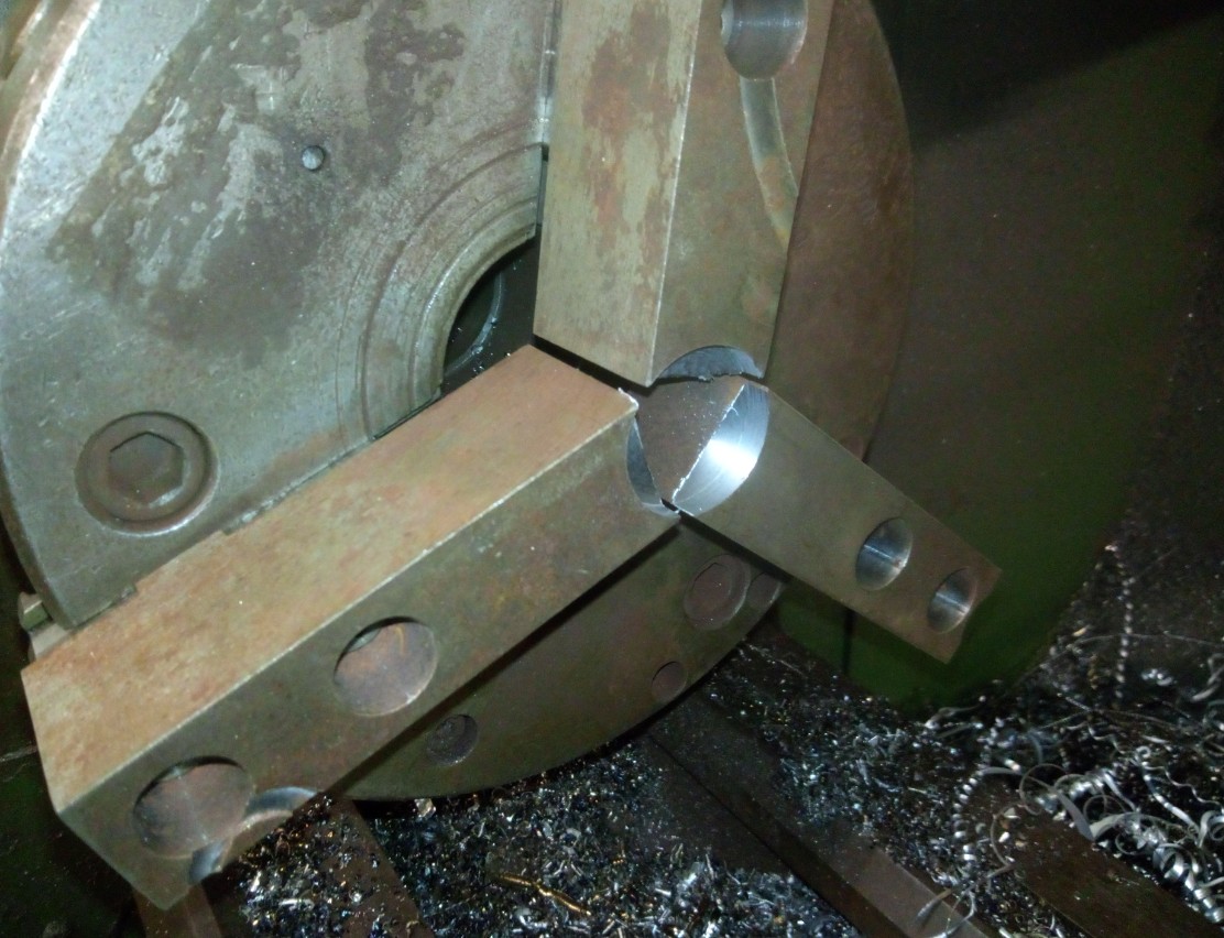

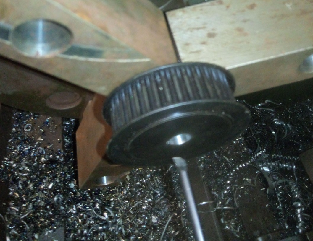

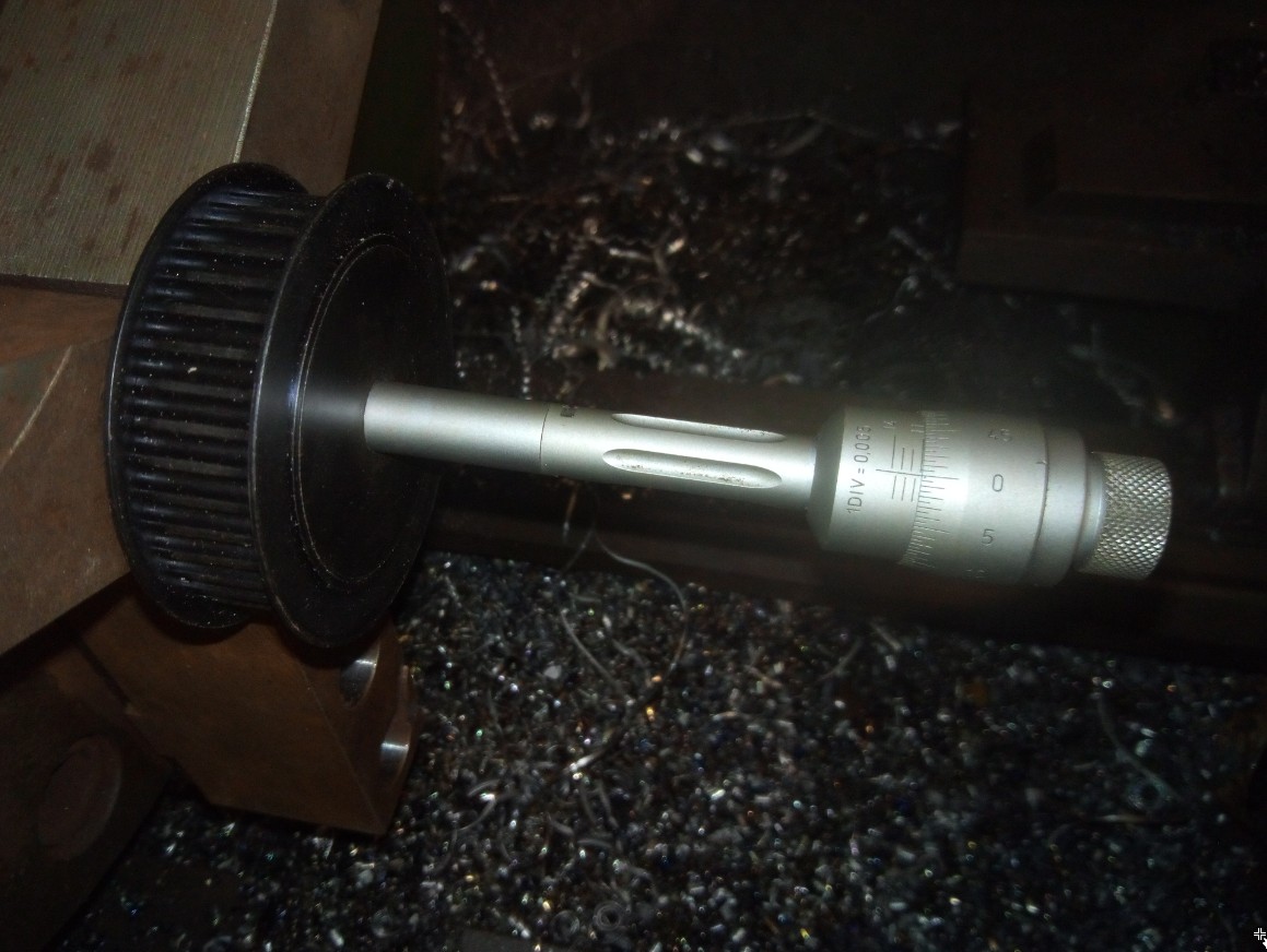

Got the 60 tooth pulley machined and bored.

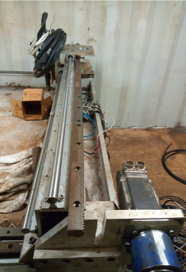

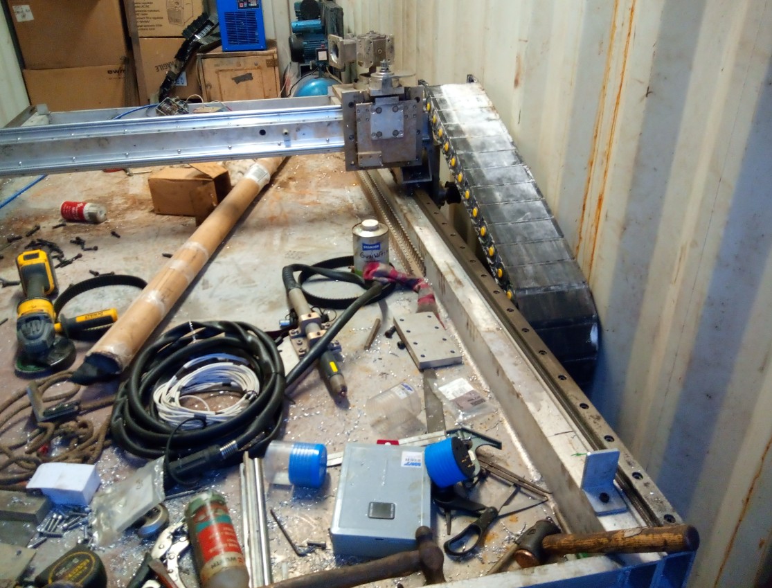

I then cut a chunk of 4" square aluminium and milled it all away to make some angle Milled out the hole for the motor and bored and tapped for the slider plate.
Then made the slider plate.
