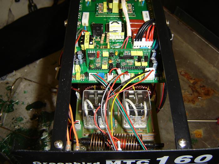

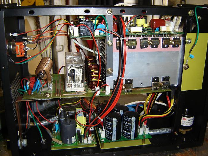

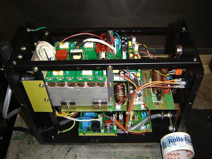

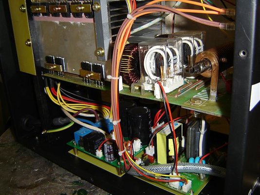

What I don't see is the main inverter transformer. I would have thought that, even for a high frequency switching supply, for a machine of this power rating it would be a noticeable item.
Hmmm.....
Still waiting for the pics Hugh! How are you getting on with it? I'm thinking of getting a plasma cutter and one of the things I want to cut on a current project is a hole (to take a bolt) through a piece of 30mm round bar, would yours manage this d'ya think? Can you make a cut from both sides if it doesn't cut through and what sort of a mess would cutting a say 15-18mm hole make?On mine, the main switch mode transormers are in the middle of the main heatsink so is cooled by the flow of air. Mine is very similar but I will post some pictures tomorrow.
