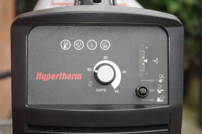

As I understand it if you can buy Stand Off's for your torch it's designed to used with the torch slightly off the sheet.What thickness are you cutting Ned? Drag tip as you probably know has + shaped shallow grooves on the contact surface.
Cant remember the air pressure off hand, but you don't need to. the Powermax 45 has a built in setting system, 3 led lights, One for under pressure and one for over pressure. the centre green one illuminates when the pressure is correct with the air flowing,
i never got any further than demo'ing one and ended up buying a different make in the end but the 45 i did use could sever cut 20-25mm and cut 10-12mm clean.Cant remember the air pressure off hand, but you don't need to. the Powermax 45 has a built in setting system, 3 led lights, One for under pressure and one for over pressure. the centre green one illuminates when the pressure is correct with the air flowing,
