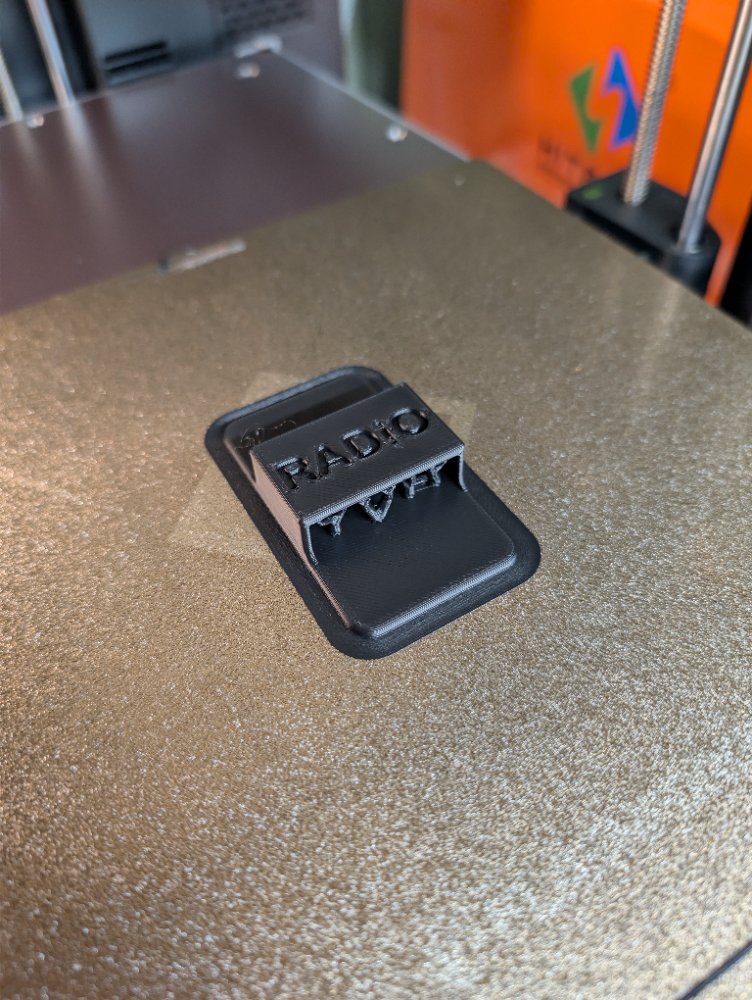

just run a print on a radio clip for a mate, first time using sunlu standard PLA and the print has warped at the build plate halfway through. didnt get any photos but the part is a 40x70 rectangle, 3mm thick, with 2 upstands and then a bridged section for the radio belt clip to slot into.
i printed the exact same file in PETG last weekend and it was fine.
what should i be looking at?
bed was set at 55 degrees and print temp was 210 at the nozzle, boht of which are comfortably inside the range given by sunlu.
is it just a case that 3mm was too thin for the footprint of 40x70? i was using tree supports internally to support the bridged section, they all broke away just fine but the print is a failure due to the warping as that face really needs to be flat for adhesive pads to be fitted later.
ive just redrawn it and bumped everything up to 5mm thick, may try printing on its side with supports only on the build plate this time. if it fails in PLA again i will do it on the original drawing with PETG as i know that works
