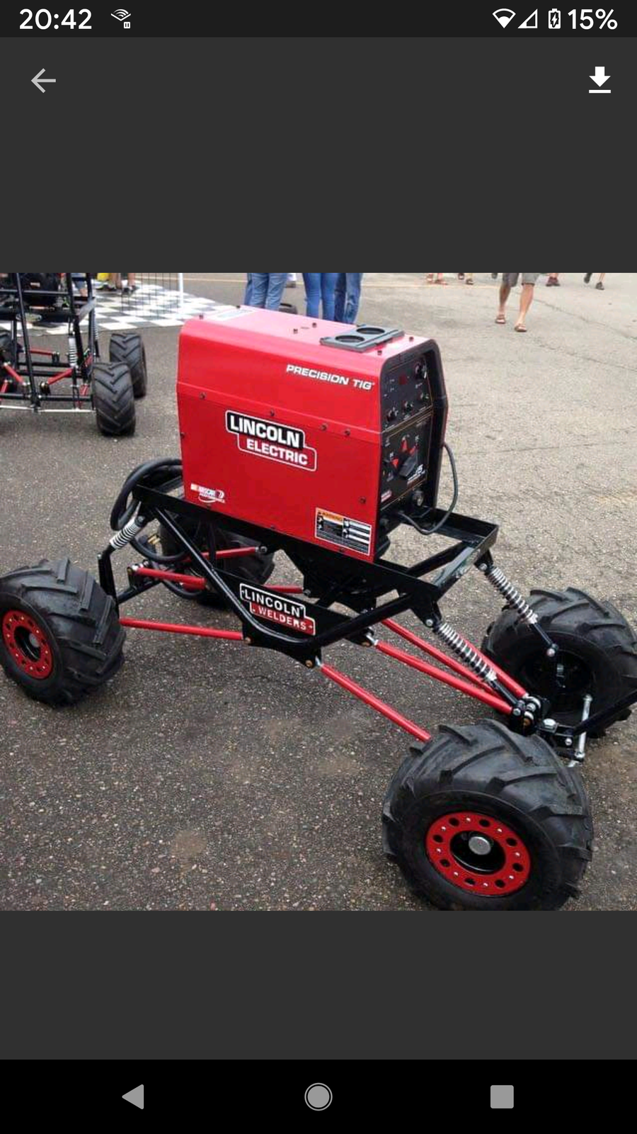

    Got a security error when I tried to upload a pic for some reason; despite me posting the same pic somewhere else on the forum. The drives got a lot of damage, maybe caused by salt and bad winters, lots of pitting, etc.
    The garage as a very good floor which is as smooth as anything would want, just if I need the welder outside that rolling it around might be an issue. The existing wheels on the 151TE didn't seem to mind it though.
    I'm not a fan of a mix of fixed casters with only two that swivel; my platform trolley uses that approach and it's a bit of a pain to get it up to the wall when storing... which has resulted in the occasional shove - which might have upset my first welder that was sat on top of it.
    I've got a robust gas cylinder trolley with two big wheels on that I plan to secure the cylinder to; though if I don't need to move the cylinder outside, it should be okay stood on that where I keep it by the wall.
  18. The_Yellow_Ardvark

    Building a welding cart that can traverse this would be helpful.
    https://ibb.co/phThQq0
