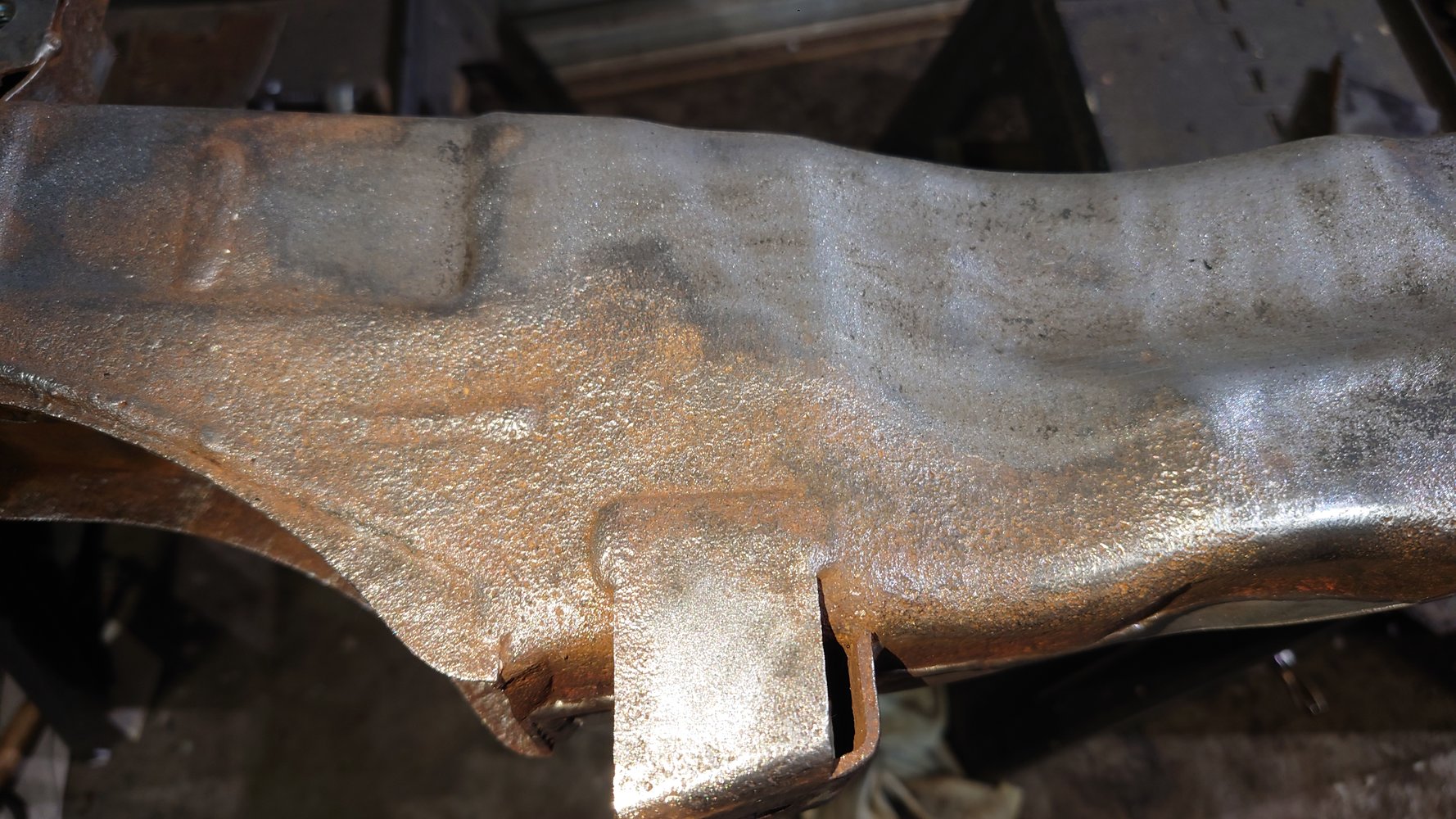

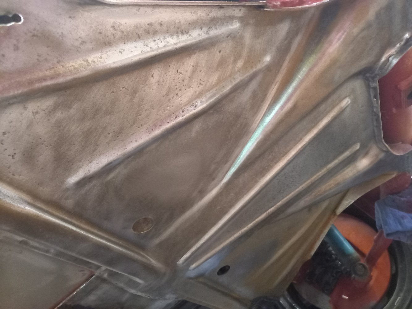

So while waiting for my jotun epoxy to arrive I'm under my vw beetle removing as much rust as possible on the underside of the frame head.
Small area about 20inch by 15nch. I can't get car high enough for me to use my sandblaster. I have been using flap wheel and sandpaper in hard areas.
The area is not really heavy corroded so has come out well . In some small areas not so good so I got some phosphoric acid from rustbuster.co.uk .
Application is degreaser , dry then apply small amount of acid leave over night and wash off with water.
We all know what's next ? After a good wash down with water the flash rust kicks in. Rustbusters say on data sheet it's Ready for paint.
Surely this is bonkers ? I can't get passed the fact after we try removing as rust as possible we then wash the metal down with water to nutralize the solution.
So you good people that have used phosphoric acid talk to me please.
