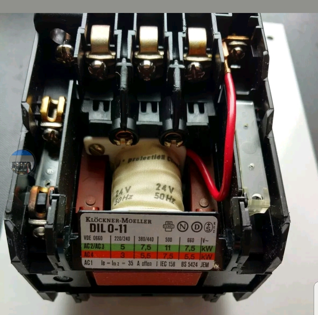

Ok will do that when my son collects them for me. CheersMeasure the resistance of the coil and that will tell you how many amps it will pull at 24v
