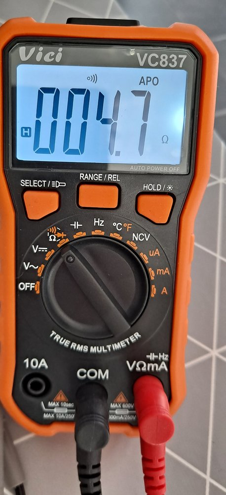

Yes, the big white rectangluar one - it's ceramic so feels like unglazed potteryHi,
no not checked that, is that the big white one, should I de- solder it to test it.
Thanks for the advice.

Eddie49 said something that is confusing me :-
'The results that I was not expecting are when the transistor was out of the board. The upper end of R4 stays at 1.4 volts,'.
Was this the voltage measured with the transistor out of the board ? If it was, we've got something wrong somewhere with what is being measured. There should be 0V across R4 when the transistor is removed. Another issue is that the circuit diagram I'm looking at shows R4 as 10 ohm not 100 ohm as is printed on the PCB.
