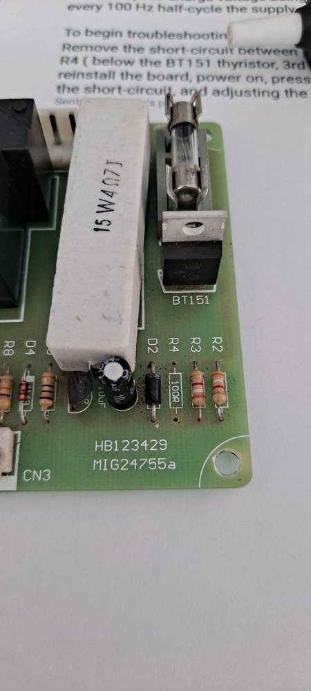

Update.....
Power on voltage position (0) and trigger pressed the voltage at the tip and the reading was 19.24v
Voltage position at (1) and trigger pressed.....voltage was 25.3v
Checked the CN1 & CN2 with the thyristor shorted.
Wire feed motor was at full speed.
Tested with trigger pressed
CN1 (pin 2) read.....23.2v
CN2 (PIN 1) read ....23v
CN2 (pin 3) read .....23.2v
