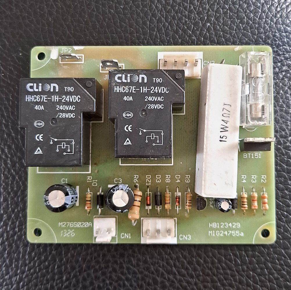

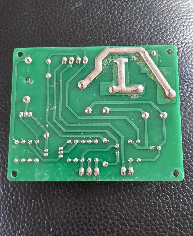

Yes, all joints have been resoldered.I think considering corrosion on transistor leads, suspect fuse holder solder joint, erratic test readings and general state of the PCB, dry joints are most likely. I would take some time solder sucking and remaking all those joints. It's possible flux has been left on after manufacture which is now causing issues in a damp environment.
