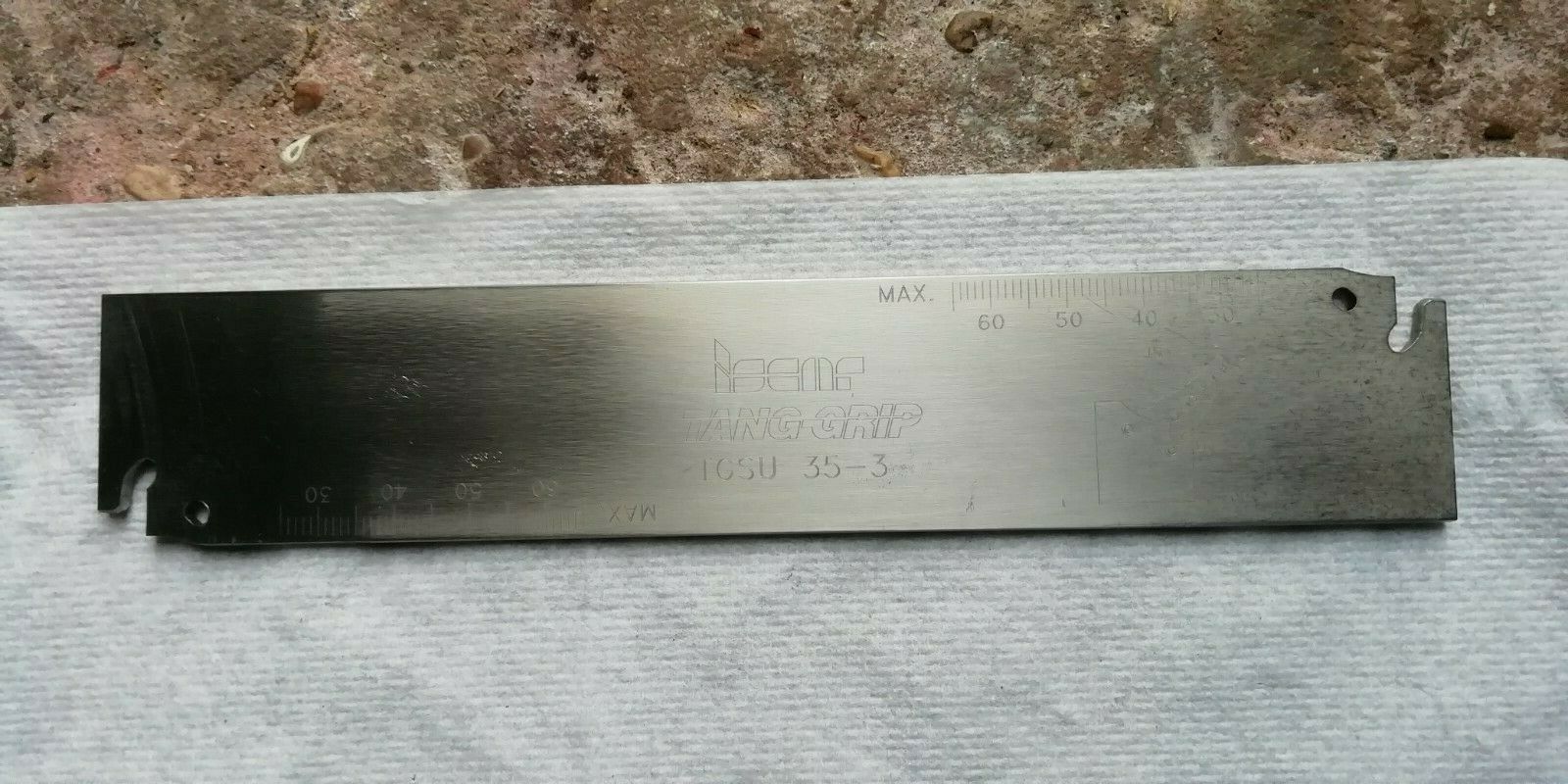

£10 bargain! i reakon you could cut it down to fit a smaller blae holder, yes it will become one ended but a lot easier than what I am going through. plus you do not have the blade holder anyway. depends on your lathe tool post size I guess
thanks that might come in hand dont forget pics if you make your own holdersThat what I thought I have a dickinson quick change on the lathe and I am at the mo saving all the offcuts left from the forklift tine, I have been whatching a few vids to see if I can make some holders so figured make one the the tang thing.

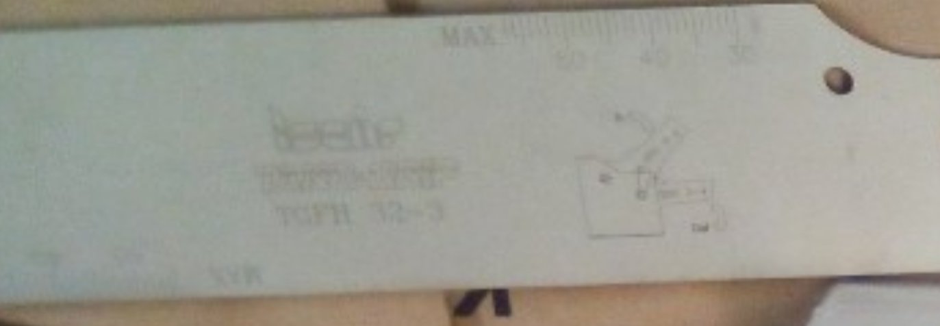

Cheers Hood if you have any pics of your holder that would be handyInteresting that these blades say 35-3, would have thought they would say 32-3. Maybe they are od ball sized.
Will have to look and see if I have a pic of mine to see what it says.
Ok not very clear as I had to zoom in on a screenshot but it definitely says 32-3.
Aye, as long as you are making your own blade holder up it will be fine, if not then it won't fit in a 32 holder unless you modify it.
