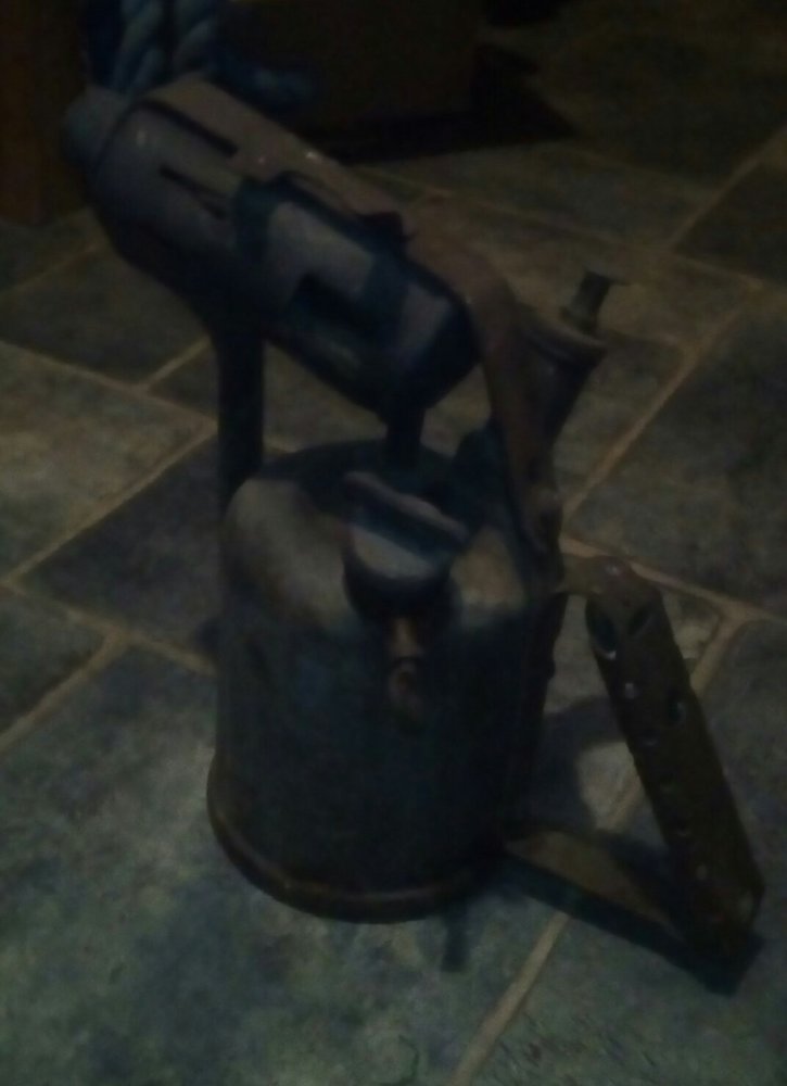

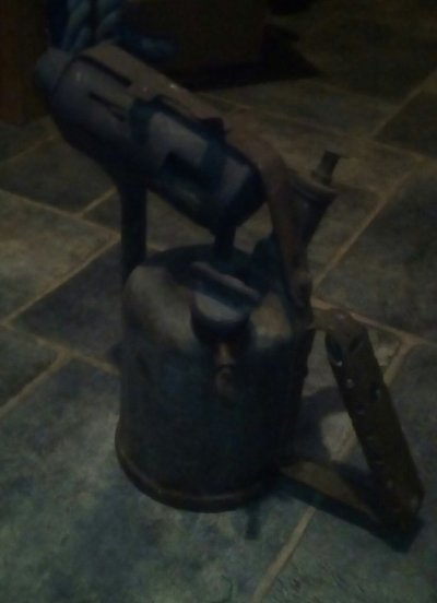

Wash the tank well with warm water and detergent.
I need some too saw some on ebay but never orderedWhere do you get your jet prickers from please?

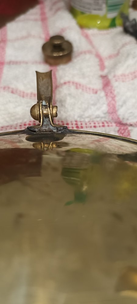

That's what I will do, just gotta be careful as the tank bottom is also soldered, gonna put some sort of heat sync either side and a nice hot flame so as not to heat up the restWash the tank well with warm water and detergent.
Remove all parts not required.
Clean well, with a soft gas flame, flux and solder just sweet it back into place.
Damp rags is what I use.That's what I will do, just gotta be careful as the tank bottom is also soldered, gonna put some sort of heat sync either side and a nice hot flame so as not to heat up the rest
If the bottom seam on the tank goes.That's what I will do, just gotta be careful as the tank bottom is also soldered, gonna put some sort of heat sync either side and a nice hot flame so as not to heat up the rest
Yeah exactly my thoughts, if I don't do it they'll just bend even more, its already at an angle, fry.your eggs at one side of pan only, we'll seeIf the bottom seam on the tank goes.
