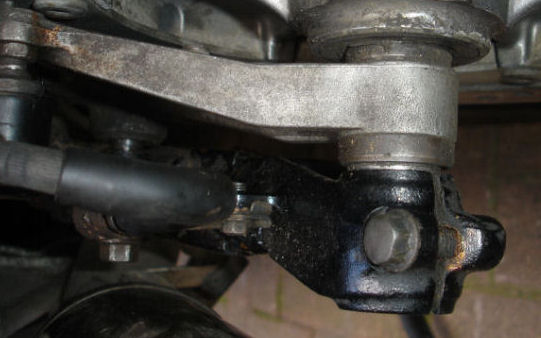

Ok, I can see that your pads look about as thick as the disc, will try that tomorrow.
Luckily I can get some in our tiny town.
not my pads i just hunted the pics down for you
there is a simple reason it's trying to bend the bracket and that is the caliper is at full extention it has no travel left
dont know what i was thinking of ive had a long day
well thats my excuse and im sticking to it
yeah your right of course the caliper will slide on its mountings not those pinsdont know what i was thinking of ive had a long day
but still there is wear there of the piston wouldnt be so far out
cant put the pads in the wrong side, they are left and right handed. Ahem some idiot did start putting them in back to front.
Caliper slides perfectly.
I had a thought today. the pads were binding a little bit, common on sliding calipers in the morning. On Friday I came out of the garage backwards and they made a lovely baritone sax noise as the slid on the disc. This friction cant have bent the mounting?
Ordred a new mount this am for £20.00 all up, so not too bad.
Looked at some brand new pads, not a aholw bunch thicker than mine. The problem is definitely th caliper not being aligned along the axis of the disc,.Oh and the little index thingy is lined up.
Should get the bit tomorrow.

Are you sure that the spacer on the wheel spindle is on the correct side of the caliper carrier.
William.
Spacer is a part of the caliper carrier, I had wondered that myself but no way is on the wrong side.
Been out on it just now and tried the brake out from just dragging it to emergency stopping and using just the back brake on it's own, seems to be working fine.
At the weekend I wil pop the pads out and have a look at them and see if they are wearing uniformly .
