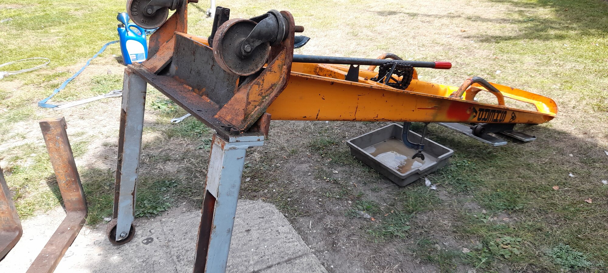

It happened after it was laid down on its back to be moved in a van. That was 14 years ago. Never worked since. I have a forklift but would be handy.Either something broken/blocked in the pump/valve body or the piston is stuck in the bore. I've seen it before on single acting cylinders, corrosion builds up on the cylinder wall and the piston gets forced over the corrosion by the hydraulic pressure but there's not enough pressure to force it back over it in the opposite direction. Only way to know for sure is to pull the rod out and inspect the piston and cylinder.

Something like this? Maybe, but I've not used one before so I wouldn't like to speculate how successful it could be. I guess it could work, but I'd have to factor in the cost of a new tool plus seals (let's say about £80) which may or may not work, or weld on a couple of brackets, for free, and use my existing chain hoist. The latter solution I can guarantee would work and would barely be an inconvenience to me as I only use the pallet stacker once in a while to lift something heavy onto the bench or on/off a trailer.Is it worth running a small cylinder hone through the bore?

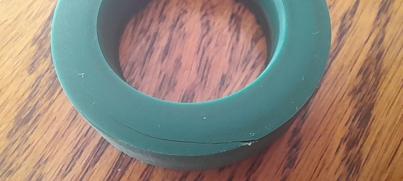

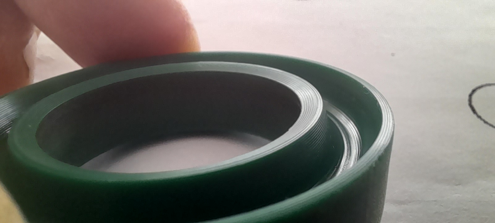

I like the idea and wanted to give it a try but haven't been able to find a seal from the usual suspects. eBay and AliExpress drew a blank.Get your seal dimensions and get a seal from China, will only cost a few quid and worth a try.
The corrosion has likely been there for a few years and the hoist was working. The seal failed due to the split, not due to the seal wearing from the corrosion.
Use a hone to remove any high spots, assemble and use the hoist. It will work for years like that.
It's a standard imperial size (1 x 1.5/8 x 3/8) and I believe it is a "US" type profile, meaning equal sized lips.
If I could find a cheap seal I would certainly give it a go. I might even try honing too.
