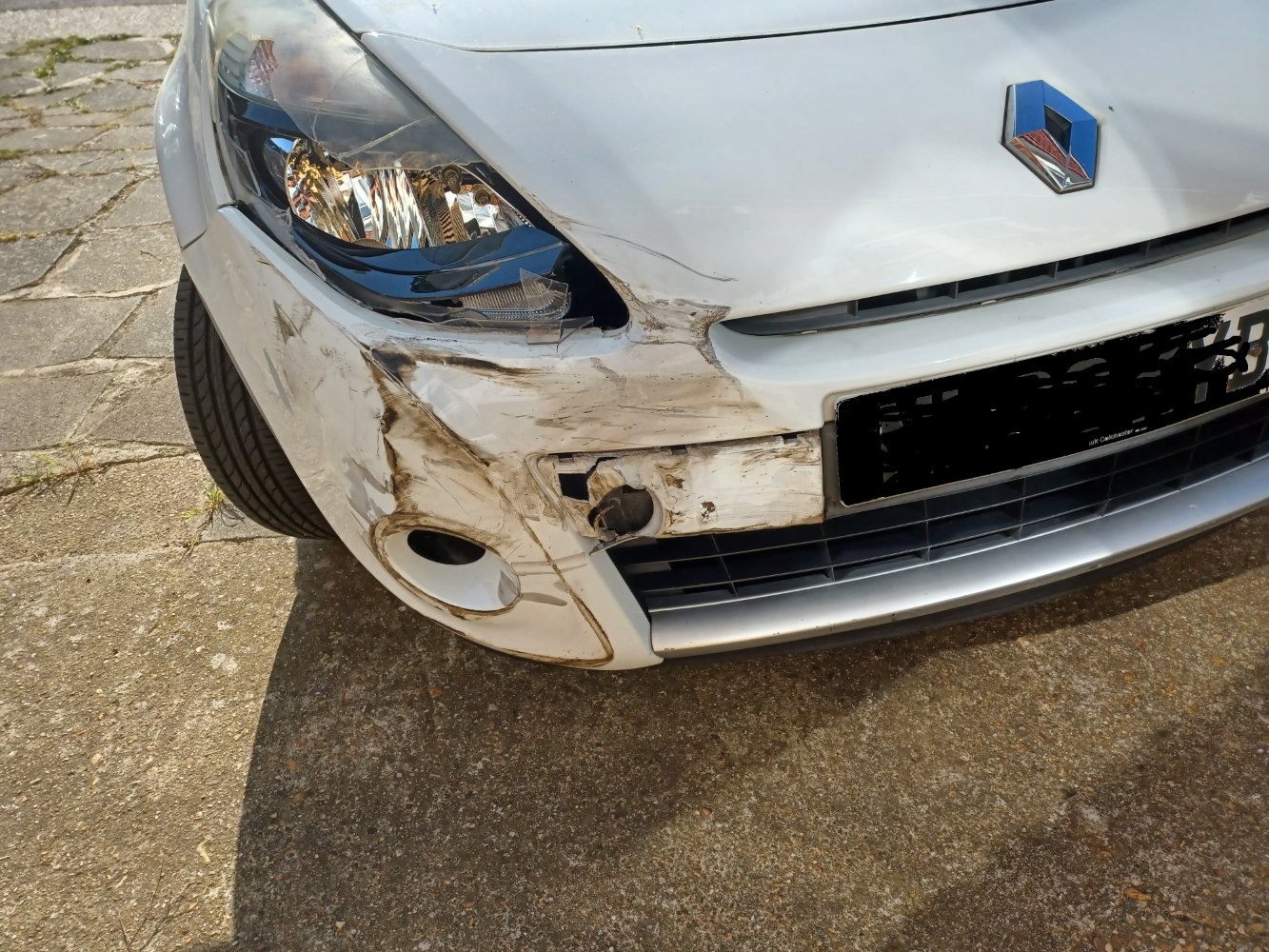

So my daughter passed her passed her test last month and 3rd day of driving on her own managed to clip a transit on a roundabout , we hoped it would be able to be sorted outside of the insurance company but the quotes he had started at £3700 and lowest was £2600 so had to declare it
This is the damage , stripped it down the weekend and bar a few broken clips everything behind looks ok
I found a headlight for £50 and a pattern bumper shell for £110 in primer , there where some second hand ones but not in white and not without some damage
Im going to have a go spaying it to save some money ive painted vehicles before but in 1k and all were military it really wasnt a good finish needed
I have all the spray gear even a room in my workshop to do this and a airfed mask

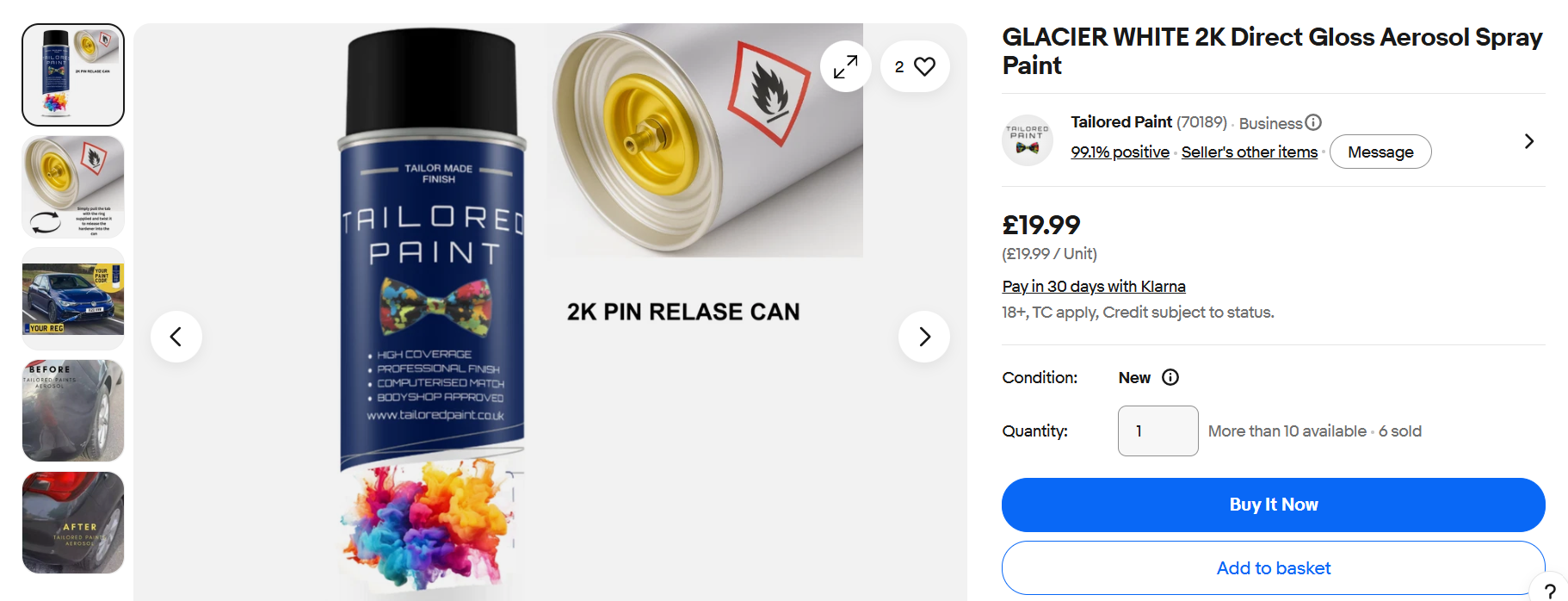

My question is as its such a small thing can I get away with using a 2k rattle can ? I really dont need showroom finish as car is only worth £1.2k anyway
this sort of thing
will I need a primer too or will the primer it comes with be ok ?
